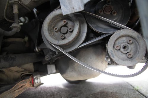

Hang on..... you've got the Water pump and PAS sharing a belt and the Alternator on its own!!!!
I have to admit I haven't inspected my PB that closely but remember on my k-jet EV the alternator and water pump shared a belt, the PAS was on its own.
I know this because my Alternator belt snapped and I thought, that's OK I can get home without the battery charging it'll be OK.... and 5 mins later I noticed the car was getting very very hot :o
I assumed they were all the same set-up - that said, it would make sense that the car is designed so it doesn't overheat if the alt belt goes so maybe they changed it on later ones. But if the water pump and alt shared the same line, they'd be able to overlap the PAS pulley.

I woke at around 4am this morning thinking something similar... that maybe the belts are in the wrong place?
Scared the wits out of the dog going out to the garage to check, or else I'd never have gone back to sleep.
The PAS / water pump and the smaller outer crankshaft pulleys all line up together, the alt. and rearmost larger crank pulley are by themselves.
It's entirely down to the PAS belt being way too tight a fit... because of how the bracket works the tension is pulling the PAS pump up towards the water pump, but also more worryingly taking it away from the vertical too, meaning they're not only touching but not perfectly aligned either.
Not an ideal pic. to show the correct alignment, infact makes them look way off, but this is it set up perfectly, obviously less the belt.

I found pics on this site, via a Google image search which shows the set-up I was explaining.
http://www.vwgolf-mk2.com/evbeltreplacement040403.html
The PAS is clearly on its own and the water pump runs with the alternator belt. I would go and check my car, but I've had to park it down the street as I'm expecting a delivery of patio slabs so had to clear the driveway... and I can't be bothered.  :))
Although I think aircon is part of that configuration.
Edit: found another one...
Re: Isaac - 1992 Alpine White GTI 8v...
Reply #279
Good wee site that, comes up quite often when searching things... suspect it's because he's already gone through what I'm having to go though now and we're getting our heads around the same issues.
It's interesting too that he mentions in a final update moving up from a 630 PAS belt to a 635 and that things fitted much better.
Don't see a 635 mentioned on 7Zap (maybe a Japanesse spec. thing?), but in addition to the PB's 730 there's a 633 and a 650 plus a 740 for certain engine codes... easy to see how things might get confused.
Like you say I think his car has aircon which seems to change things further.
It was mentioned elsewhere about different pulley sizes, though I've since checked and mine are PB with PAS correct (and appear original) to the car so didn't take that any further... but again did seem to may be variations for different enginecodes.
