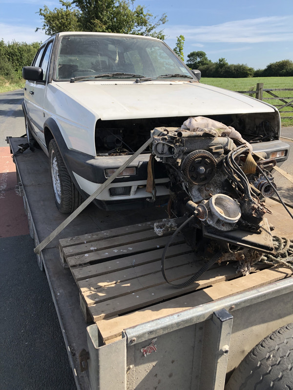

The four branch in the car had very little space at the back of the engine  (I had to move the engine forward to get it off the head). It also seemed to develop a lot of heat,  even melting the gearshift connections, but then the previous ;ady owner only drove it around town so this may have been a heat factor. Anyway, I like originality, and I'm selling it to someone that wants the power and noise!.
I think  I've secured a factory manifold now, and am hoping that will be the best starter for ten.  So I need a twin tube to mount to that, do I not?
Thanks so much for your help. Eddie
