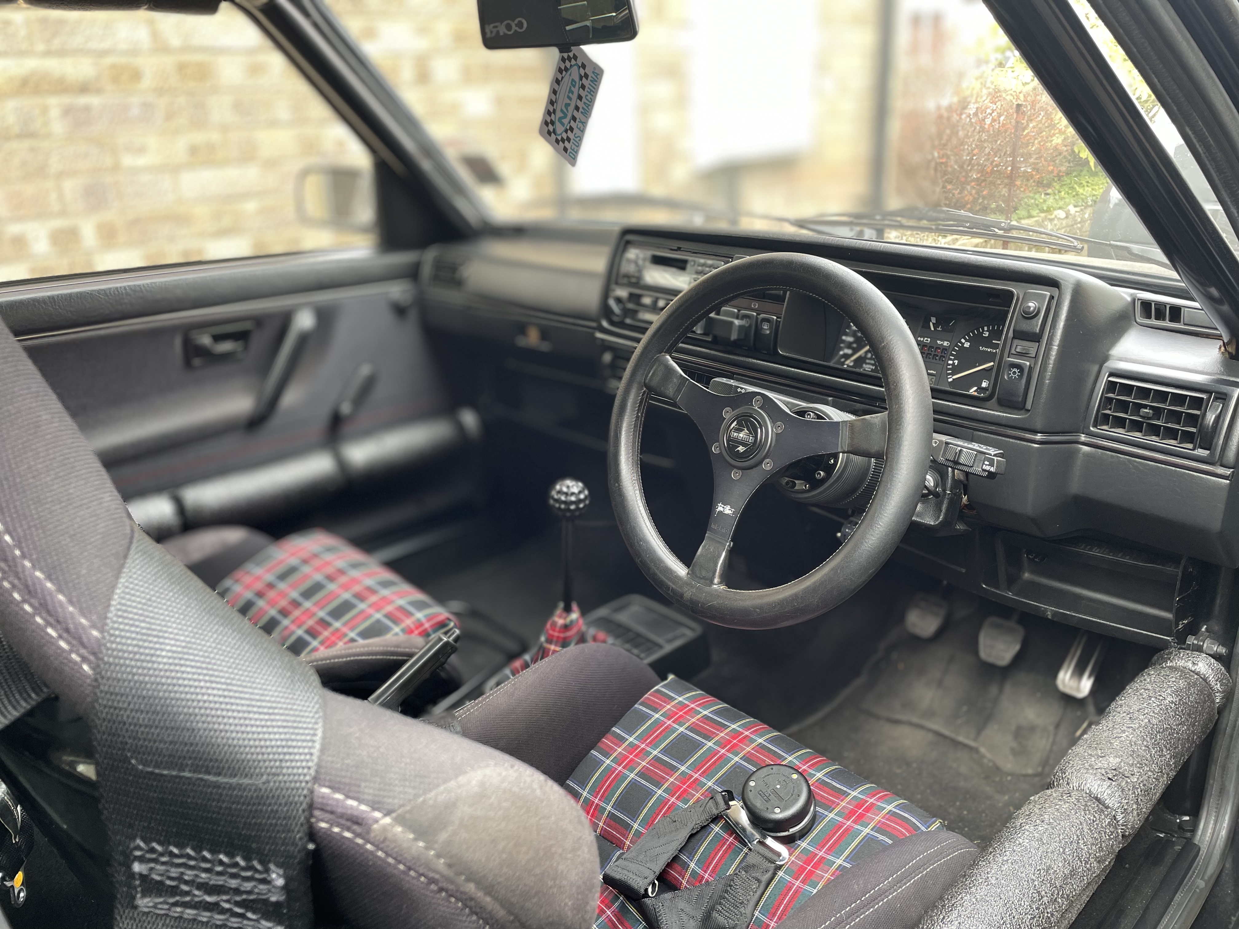

It’s been a while since I updated this, I’ve been deciding what to do with the engine, and for now that project is on hold, the 8v will live for another year!
After photoshopping out a yellow Fiat 500, I got one of the photos from the Nurburgring printed and frame, somehow I managed to get it pride of place in the lounge! The missus said she “likes the greenery” suits me [:D]

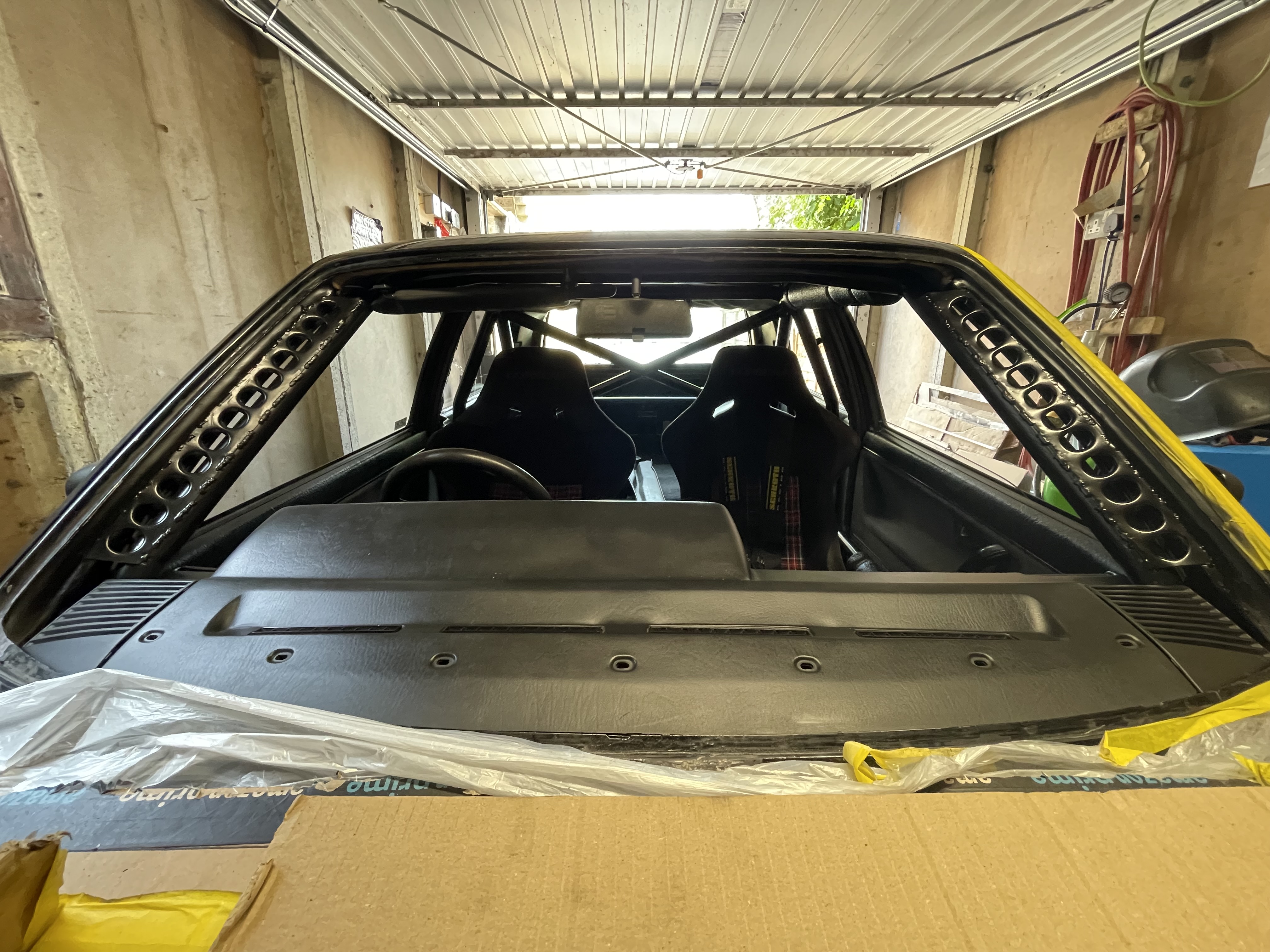

I got the Golf out last week on the drive, first time it’s been started since October, as expected she fired straight up.
Unfortunately, the headlining has taken a massive turd.
So I’ll be trying some spray adhesive to fix it.

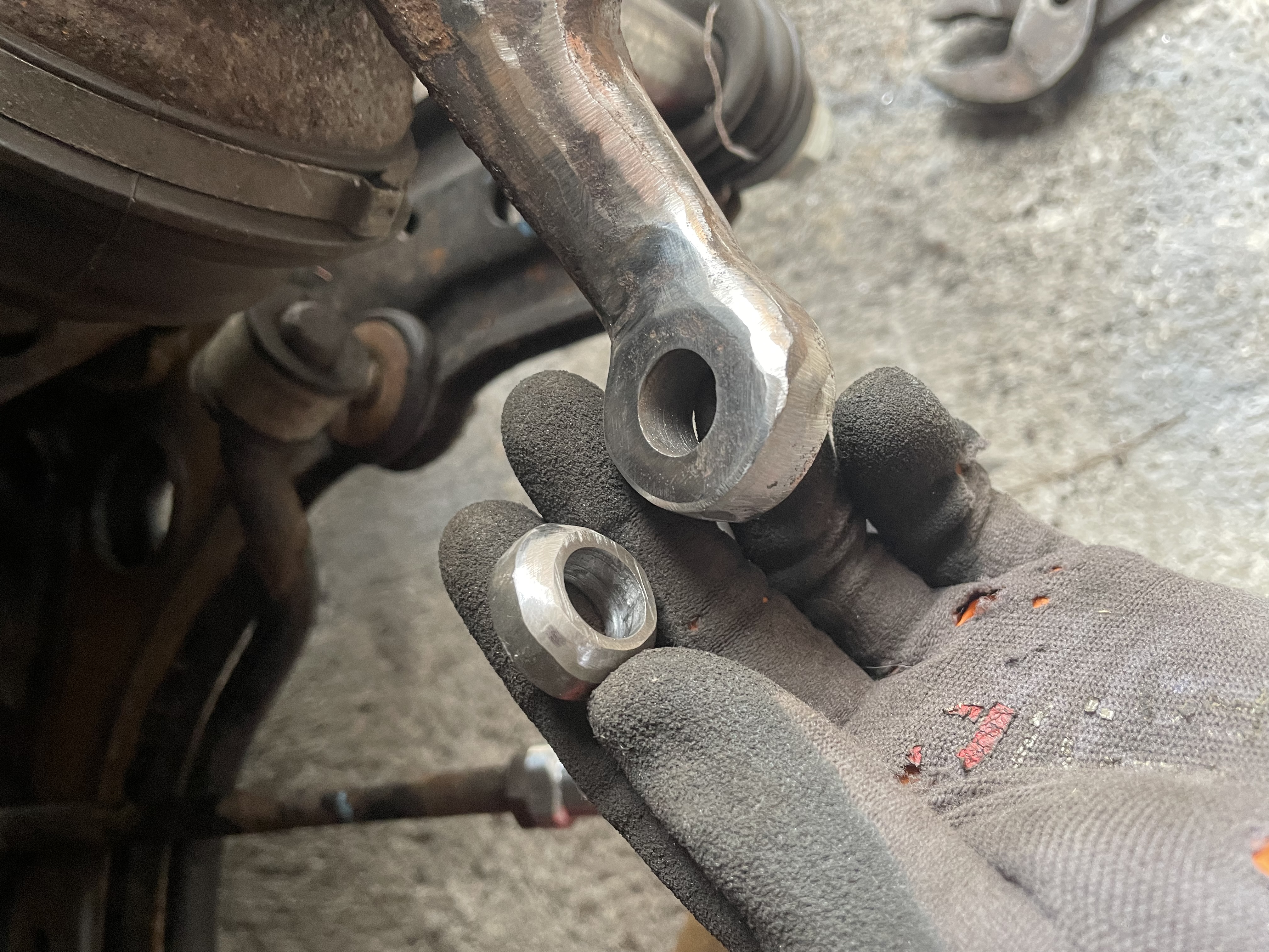

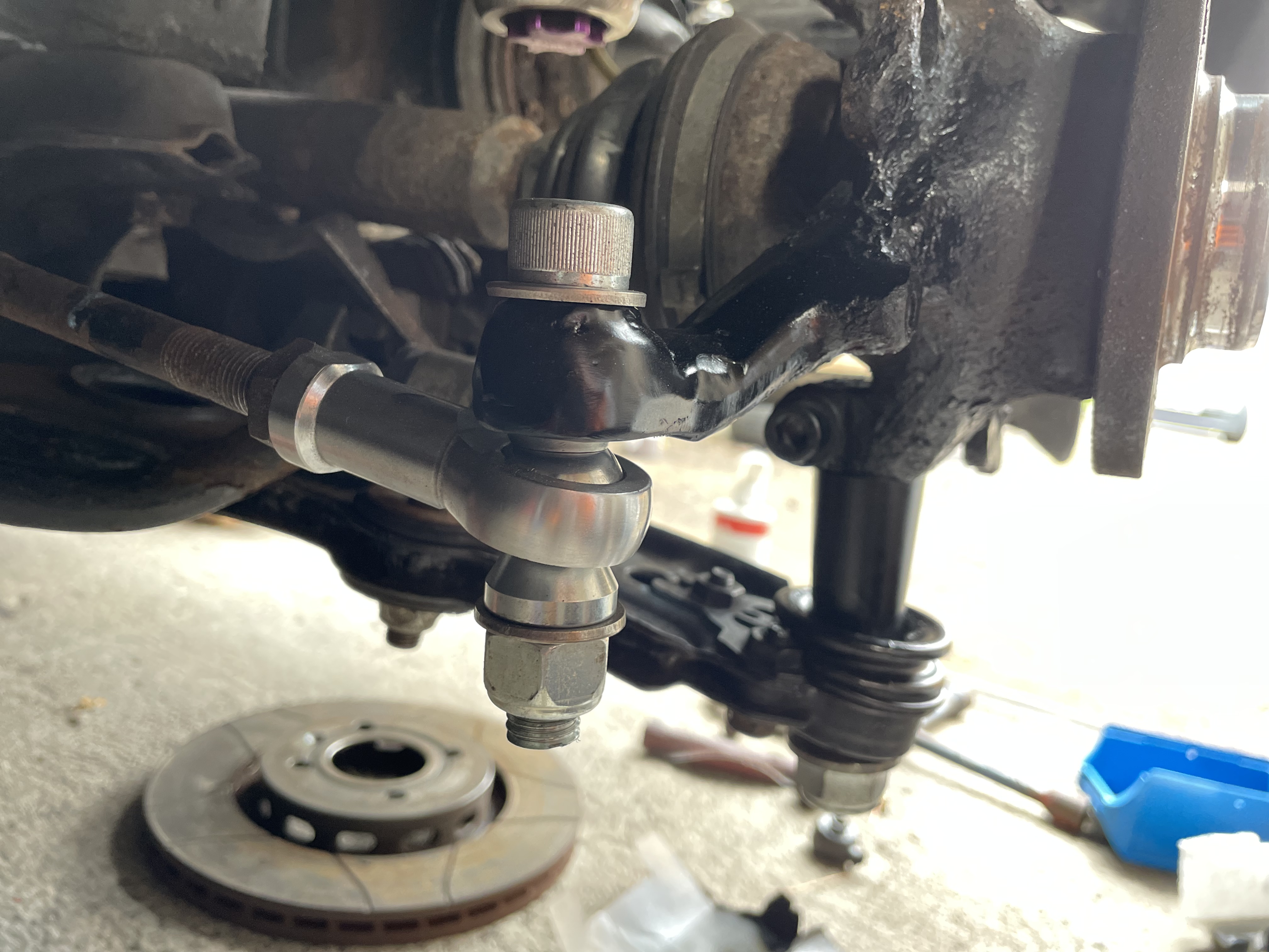

With that data collected I had to work out a way to move the track rod up. I could cut down the misalignment spacers Noath provided, but there was a casting on the track rods which would need to be ground down.
Going over the graphs again, I’d worked out I’d need more than just a trim of the spacer.
The only way would be to trim the hub to get the desired height.

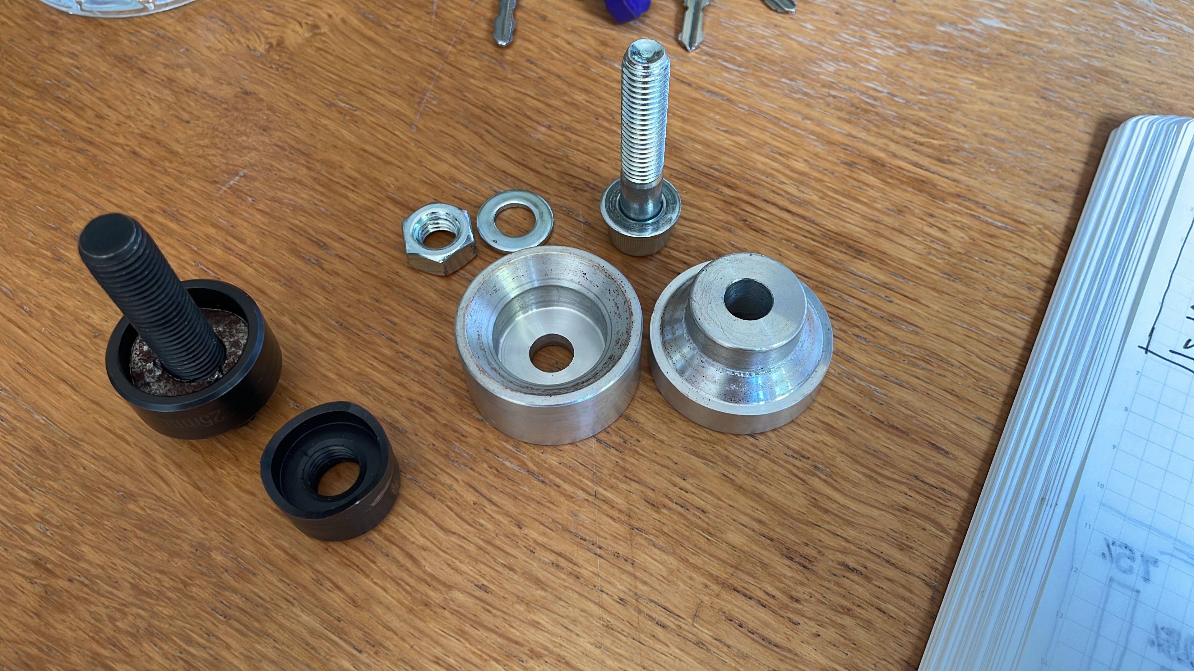

This caused another issue, the Noath kit comes with a tapered bolt which is great for a direct bot on kit but if I had to trim the hub the bolt would no longer sit correctly in the tapper.
So I decided to drill the hub out to M14, and use an M14 rose joint instead.
These were from McGill Motorsport, ordered on Friday afternoon, arrived Saturday!
I ordered their highest quality joints, misalignment spacers and rubber boots, costing £45.
With the hub drilled out, I took 6mm off the hubs. The material I’ve taken off the bottom I’ll add back on the top to retain the strength in the arm, I’m just waiting for the steel to arrive.
After the material was taken off and cleaned up, I cut one of the misalignment spacers down to 4mm and assembled.
I checked the articulation of the joint and there was still plenty of room and no binding in the joint.

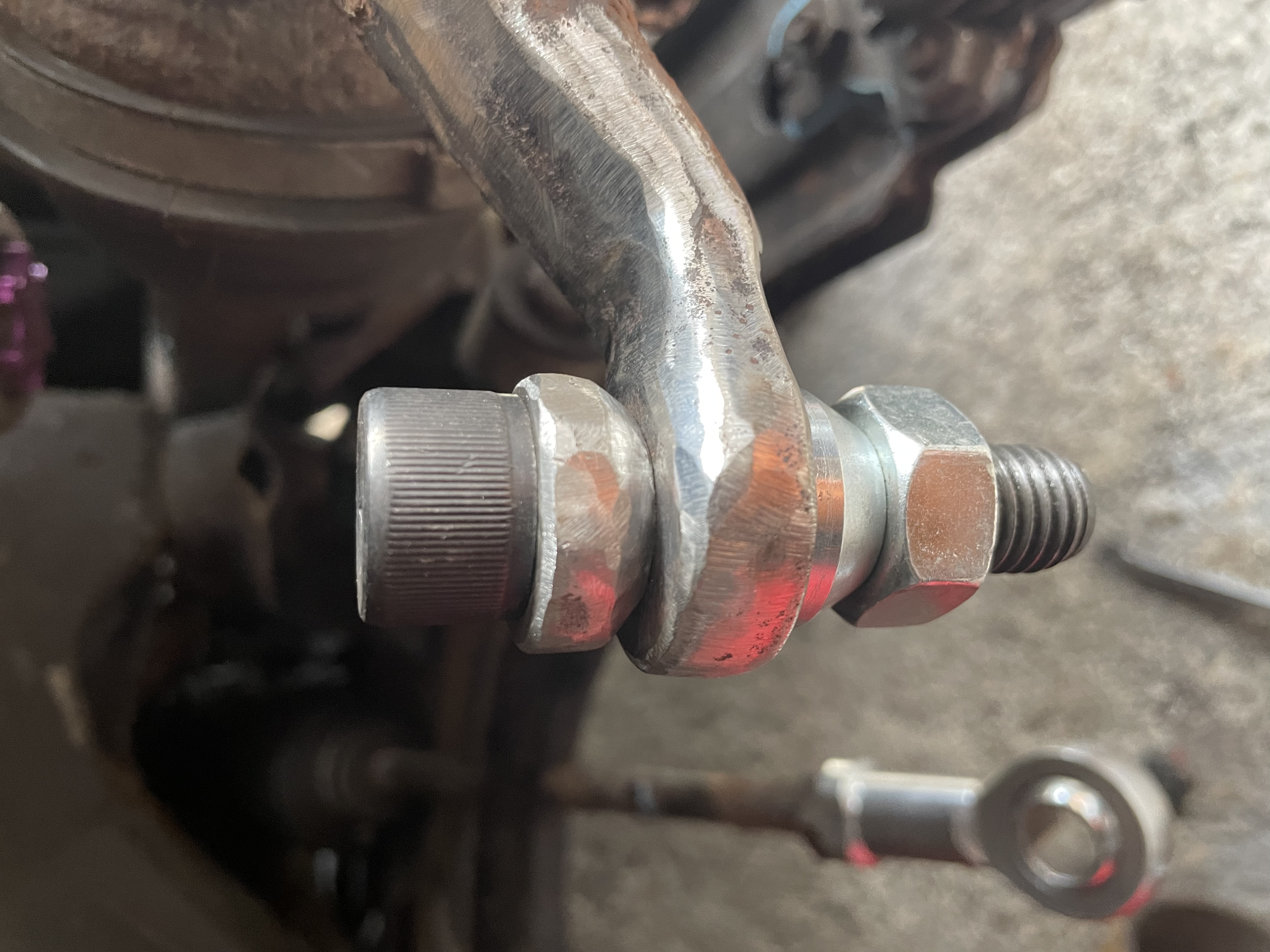

Managed to get all the bumpsteer adjustment finalised.
I’ve made a 10mm spacer from mild steel, with a tapered end, so I could get some decent penetration when welding.
This was then bolted up tight and welded to the hub
Cleaned up and painted
The process was then mirrored on the passenger side.

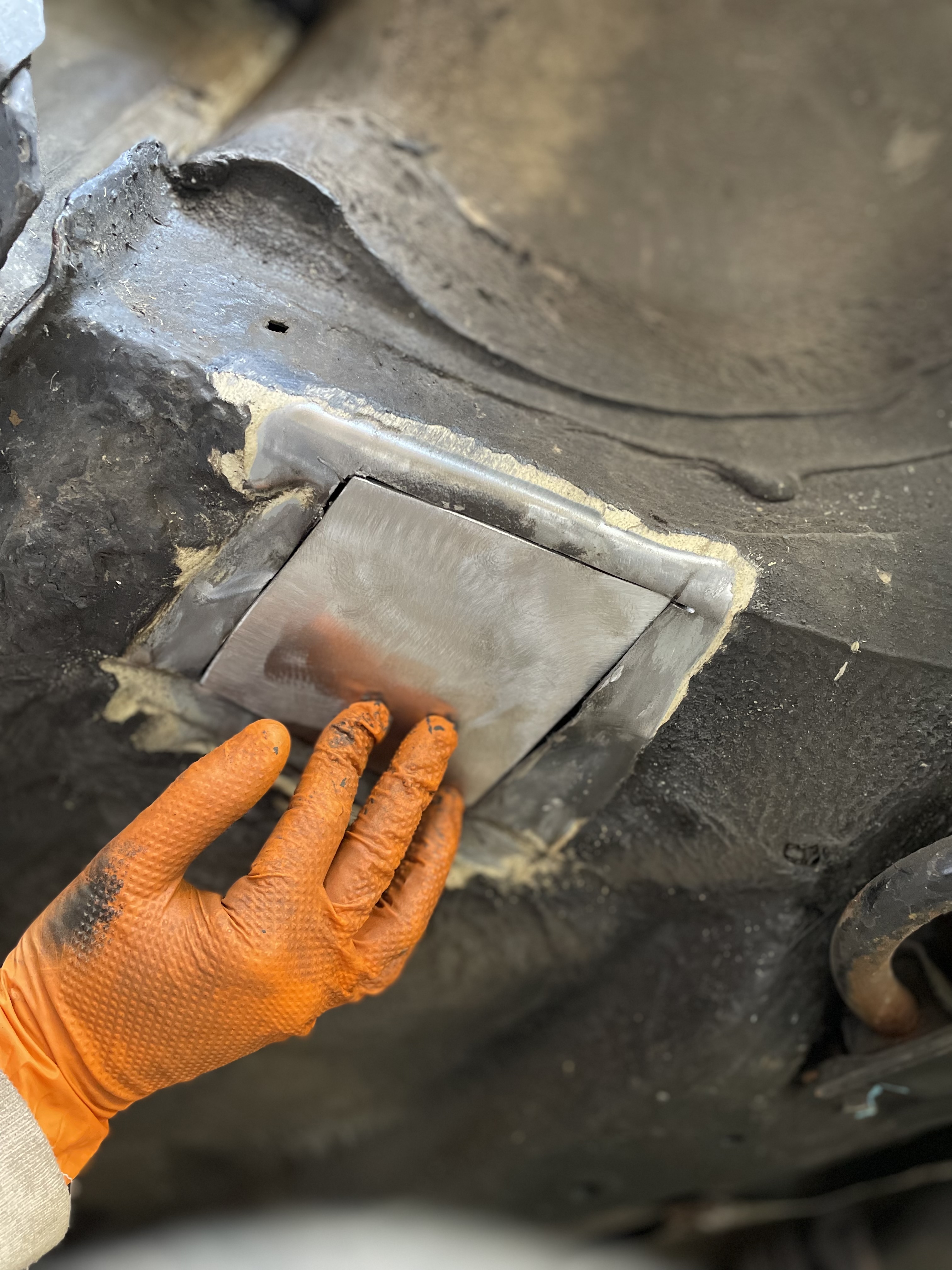

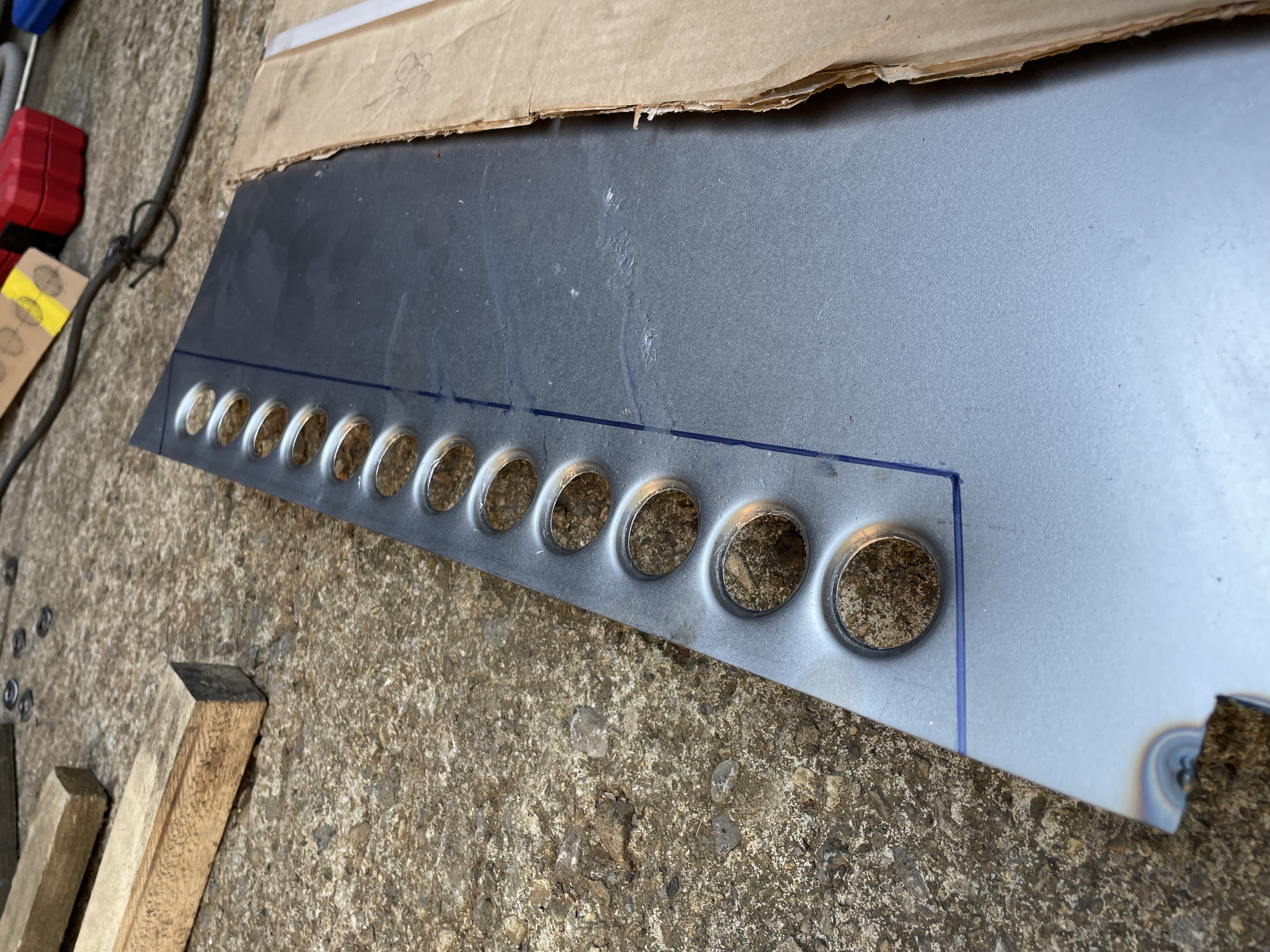

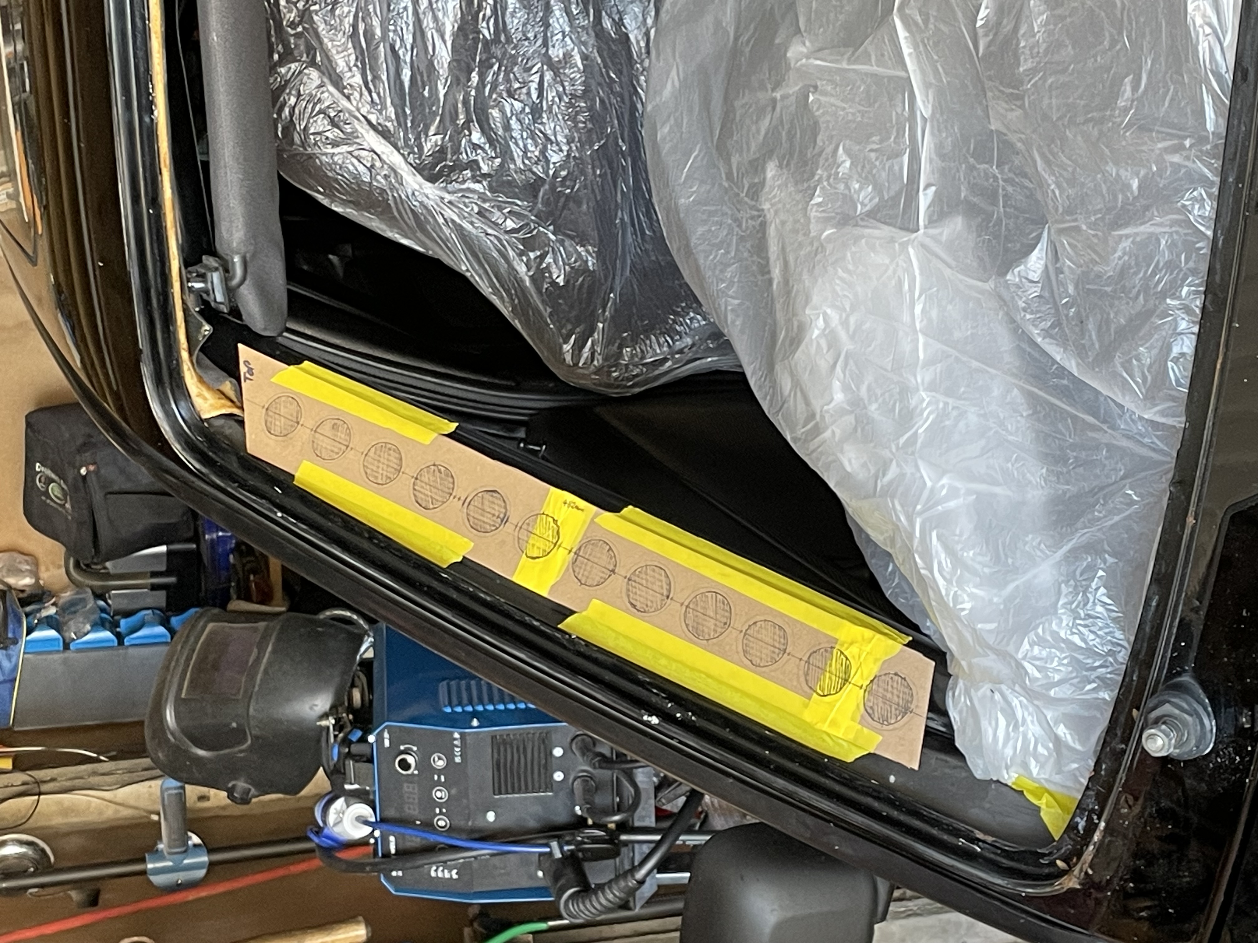

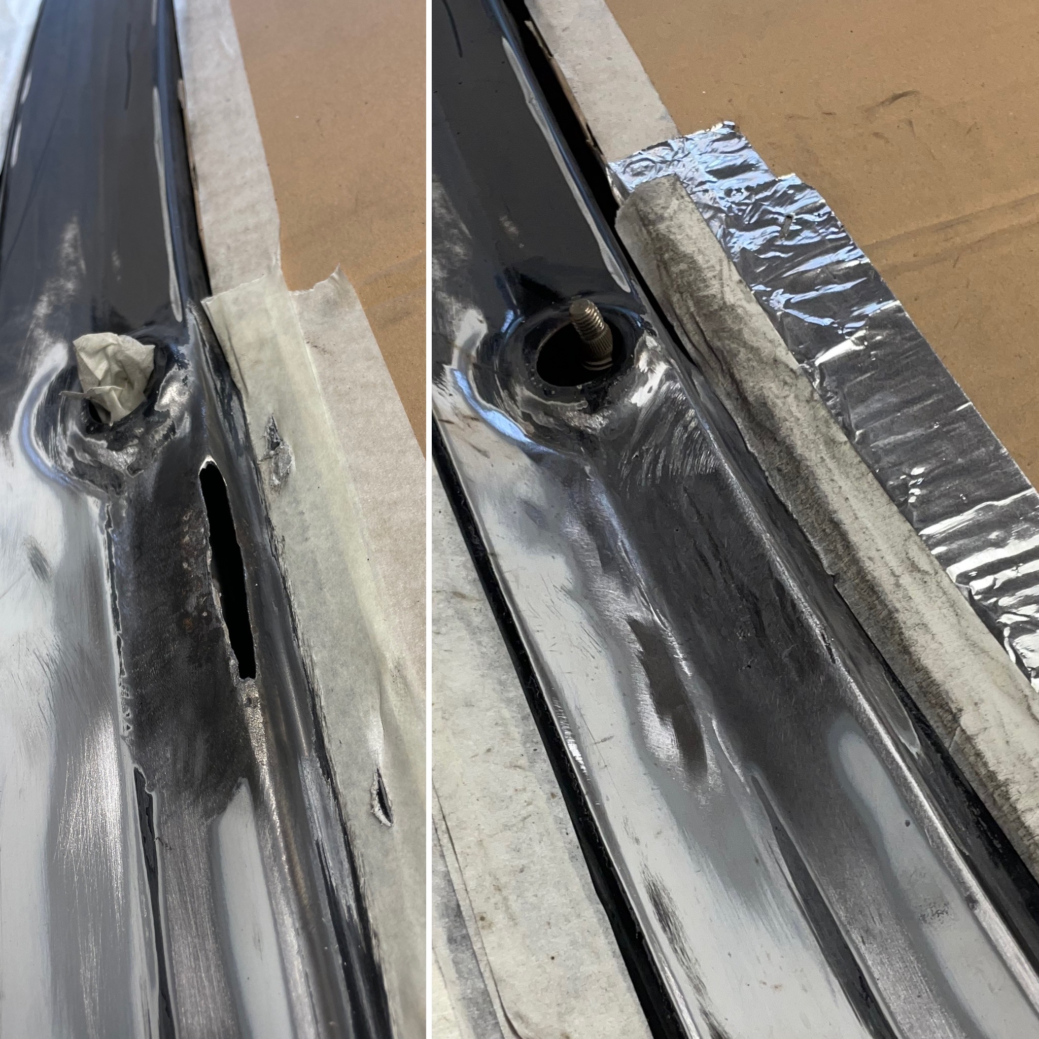

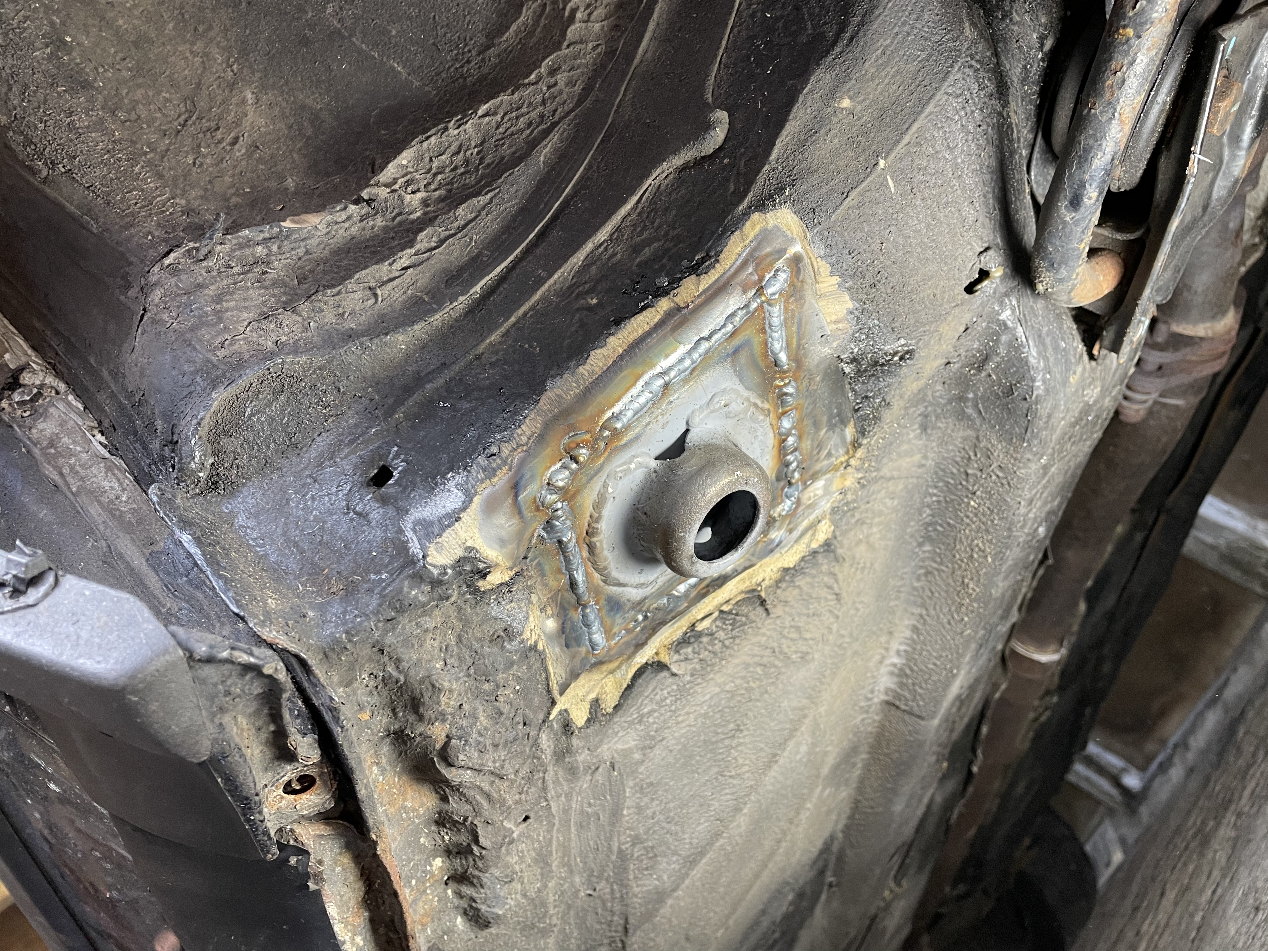

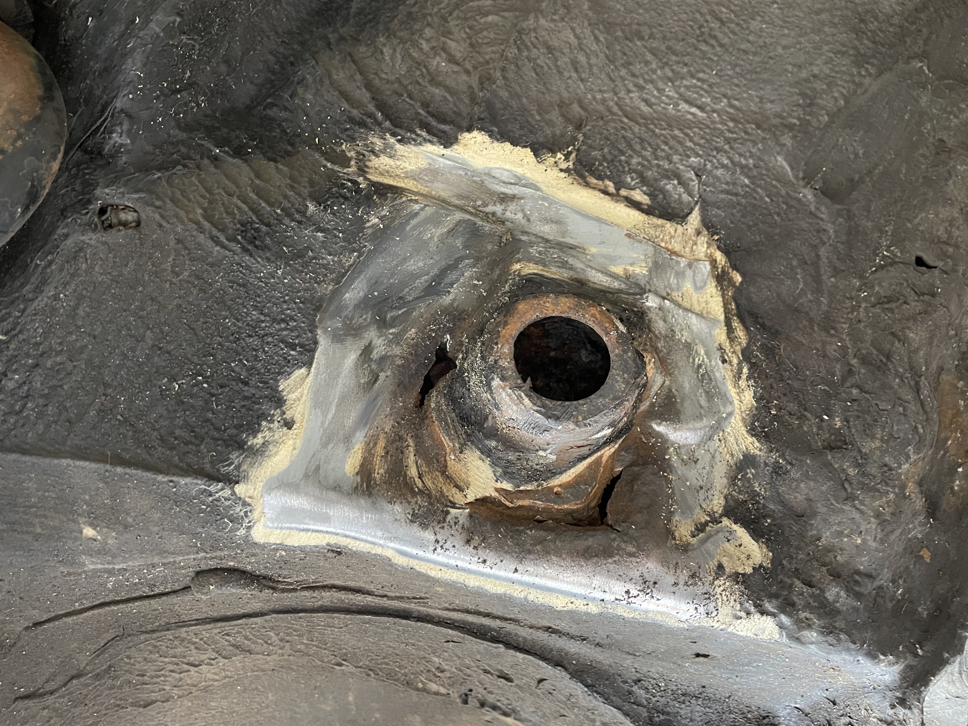

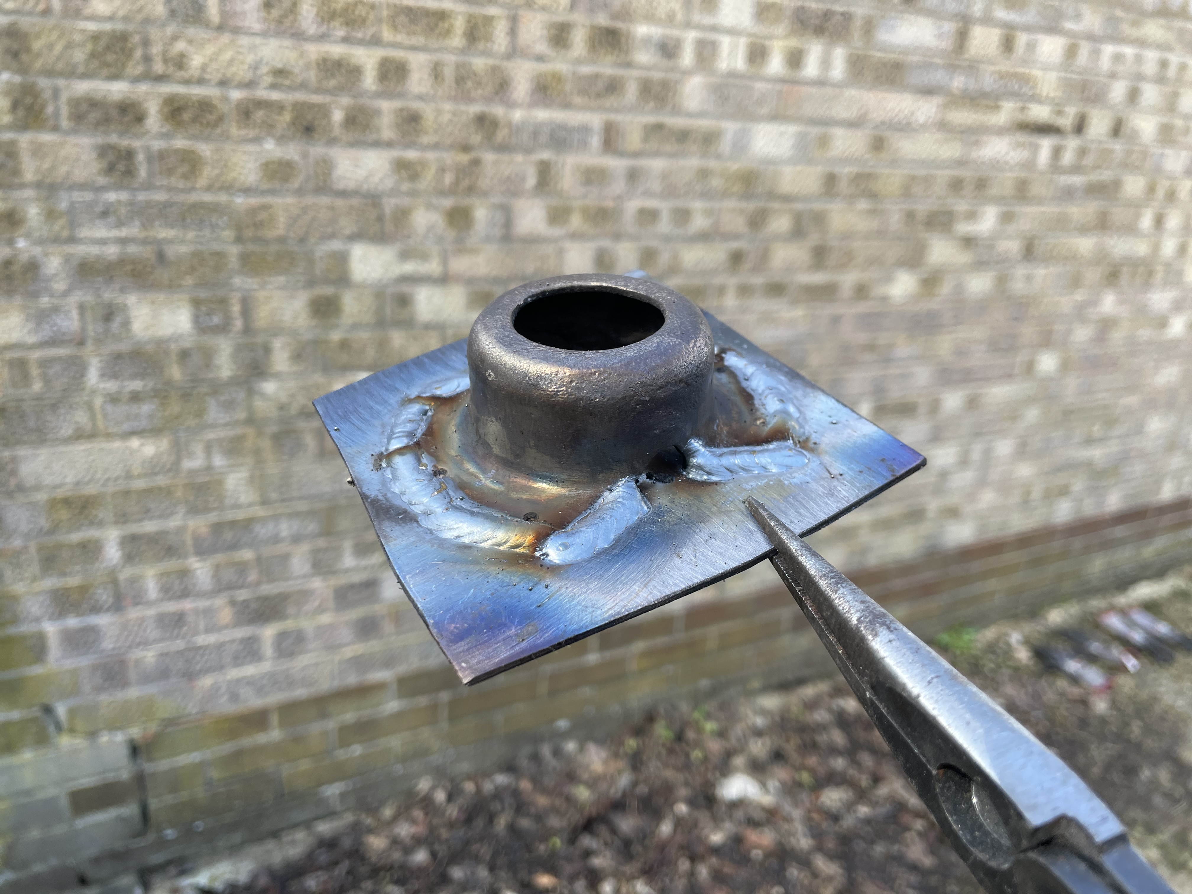

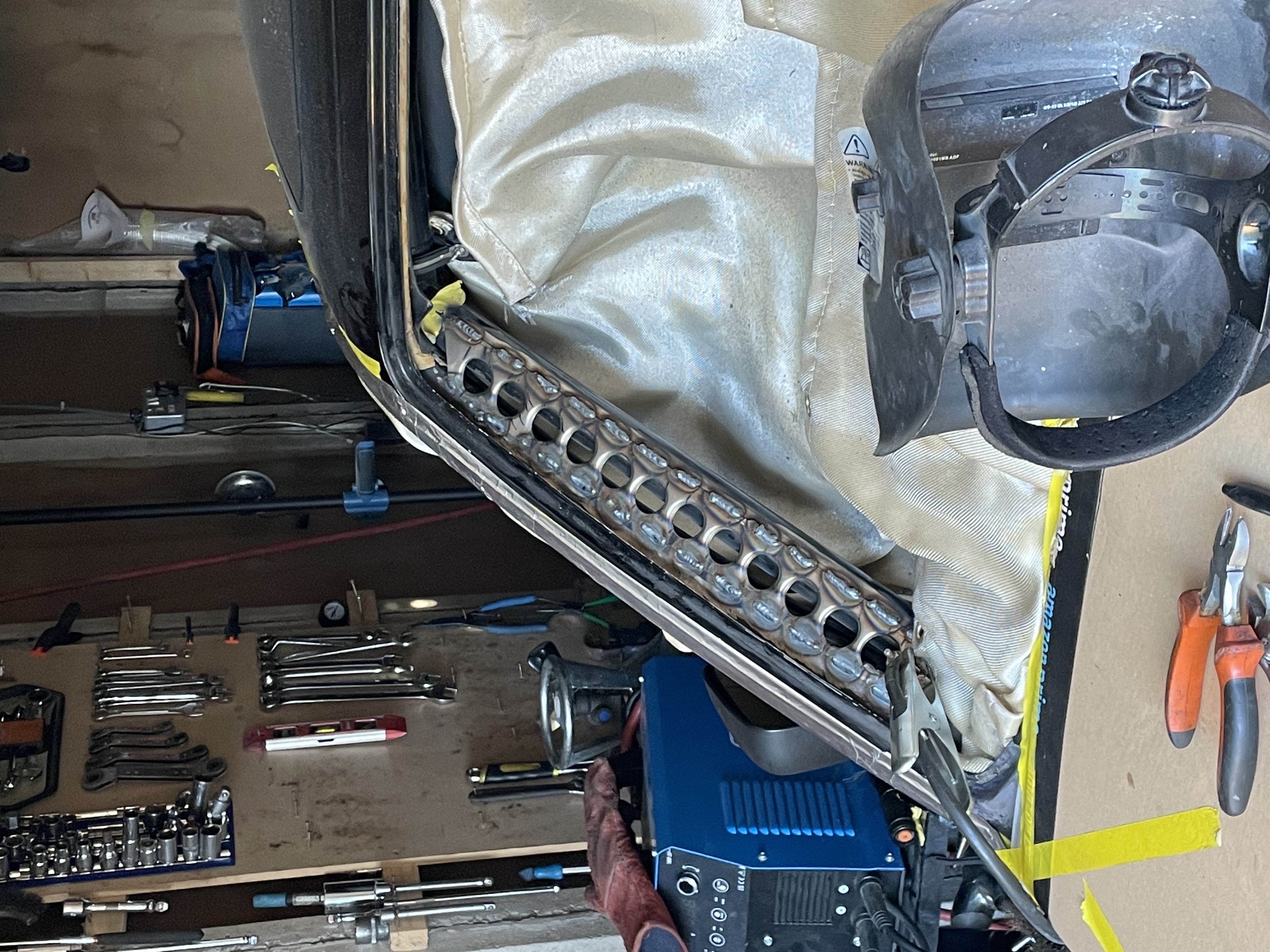

I knew the front jacking point was a little suspect, so started stripping off the underseal.
I decided to chop the lot out and reuse the cup, as that was still decent metal.

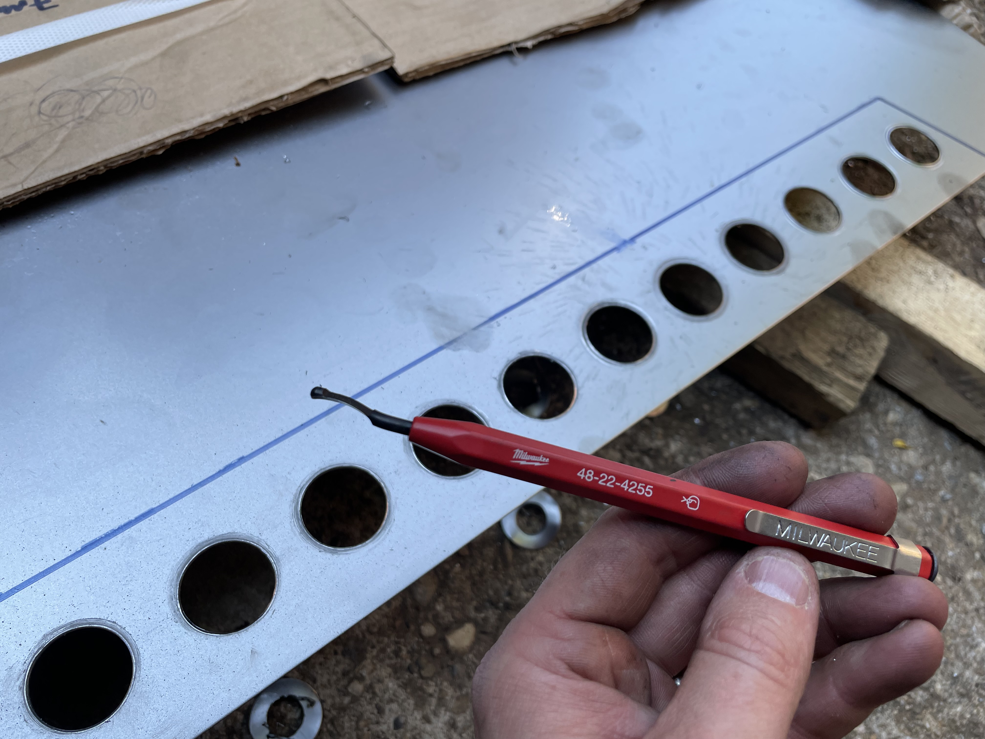

First up was a card template followed by a steel replacement
Once I was happy there, I rewelded the cup on to the new metal.
Next I heatgunned the floorpan to get as much waxoyl out before welding. This makes a big difference to the weld, but its still managed to creep through when welding.
Once in, it was etch primed, painted and undersealed.

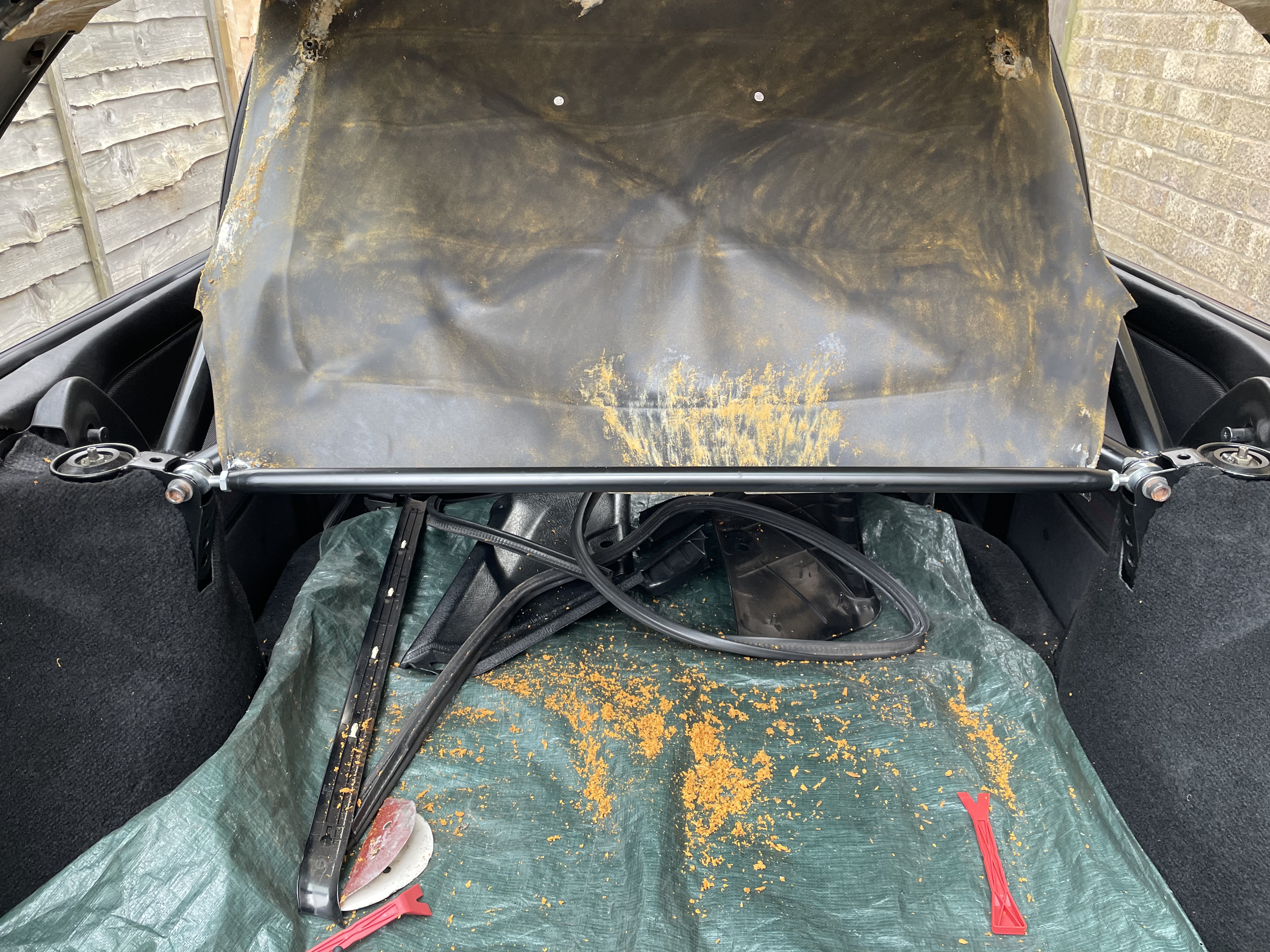

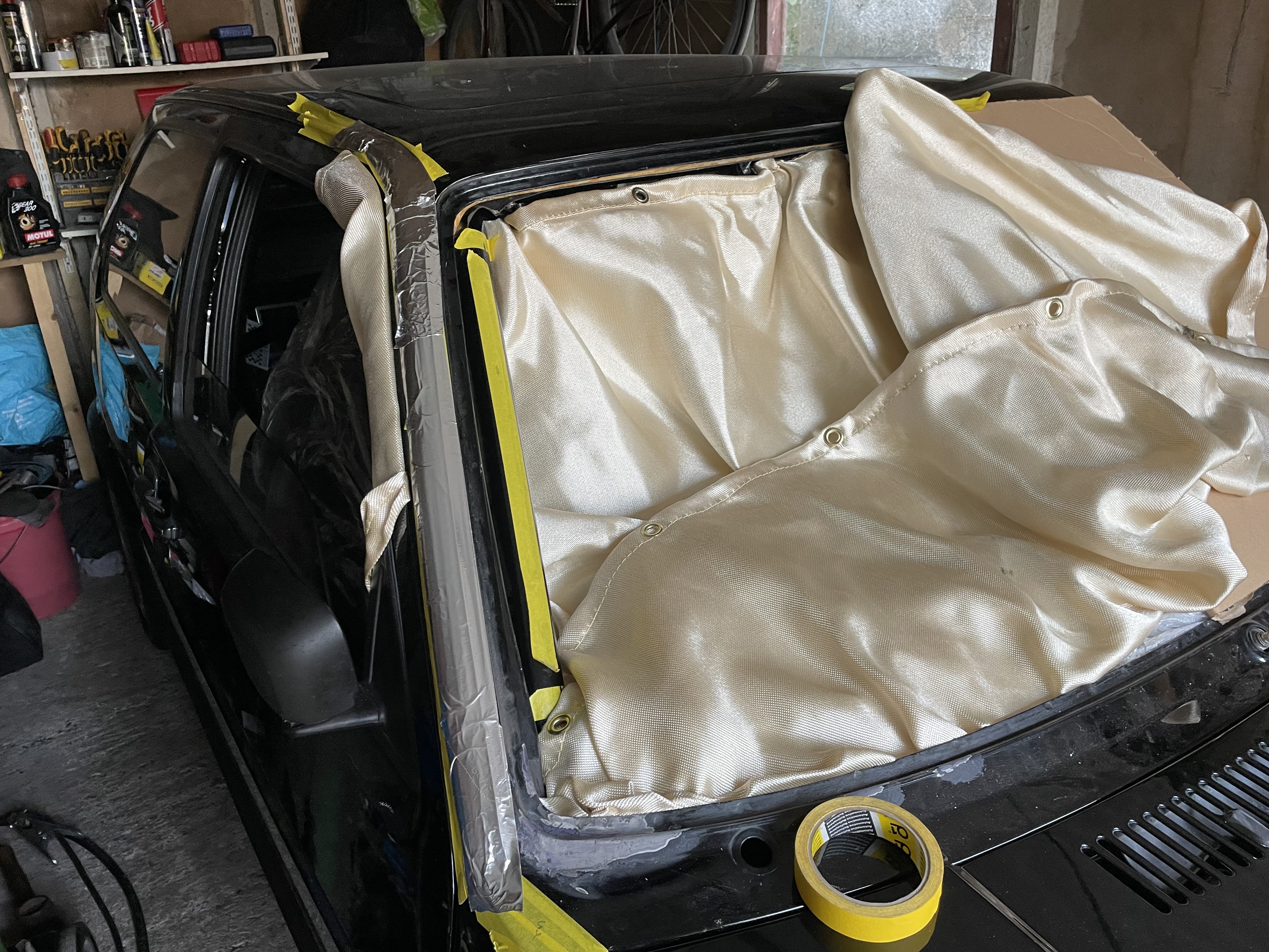

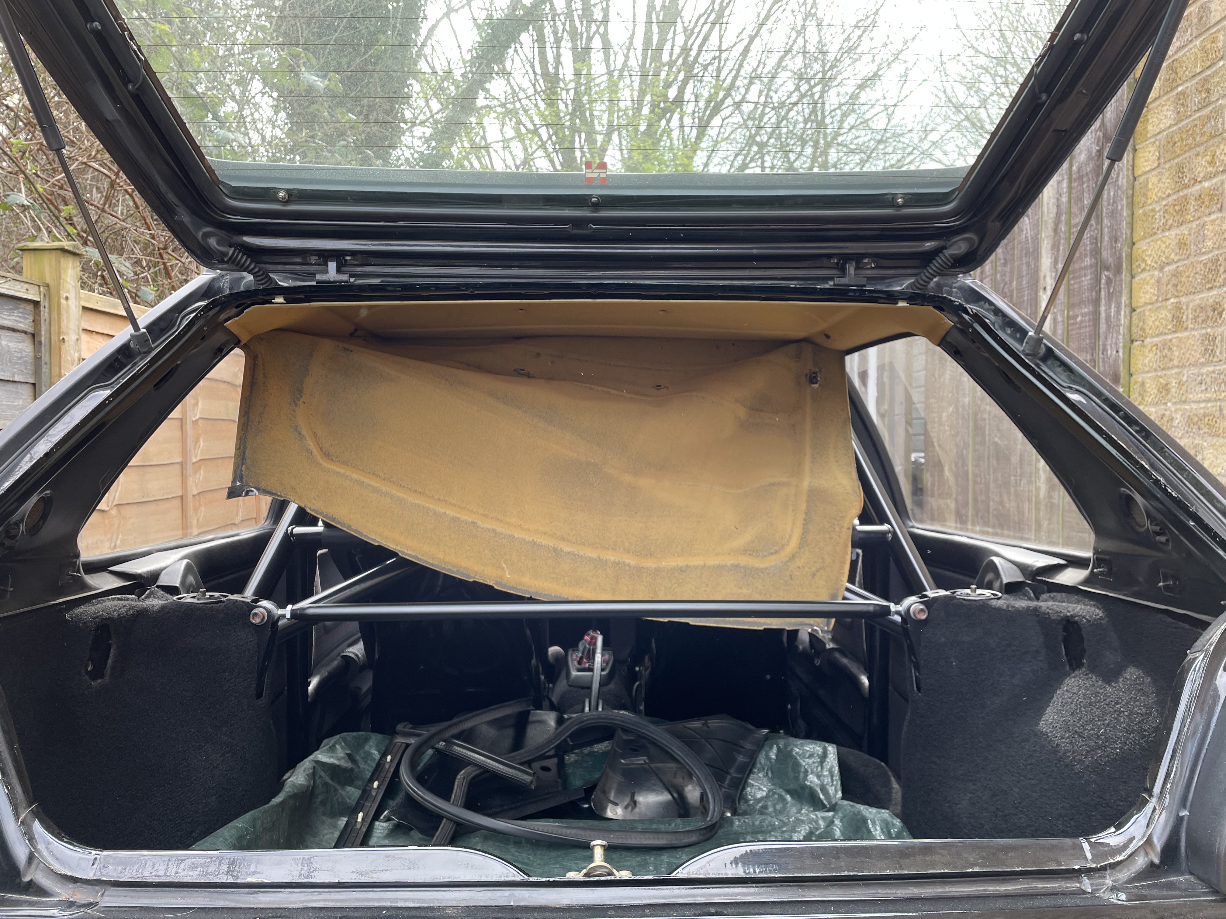

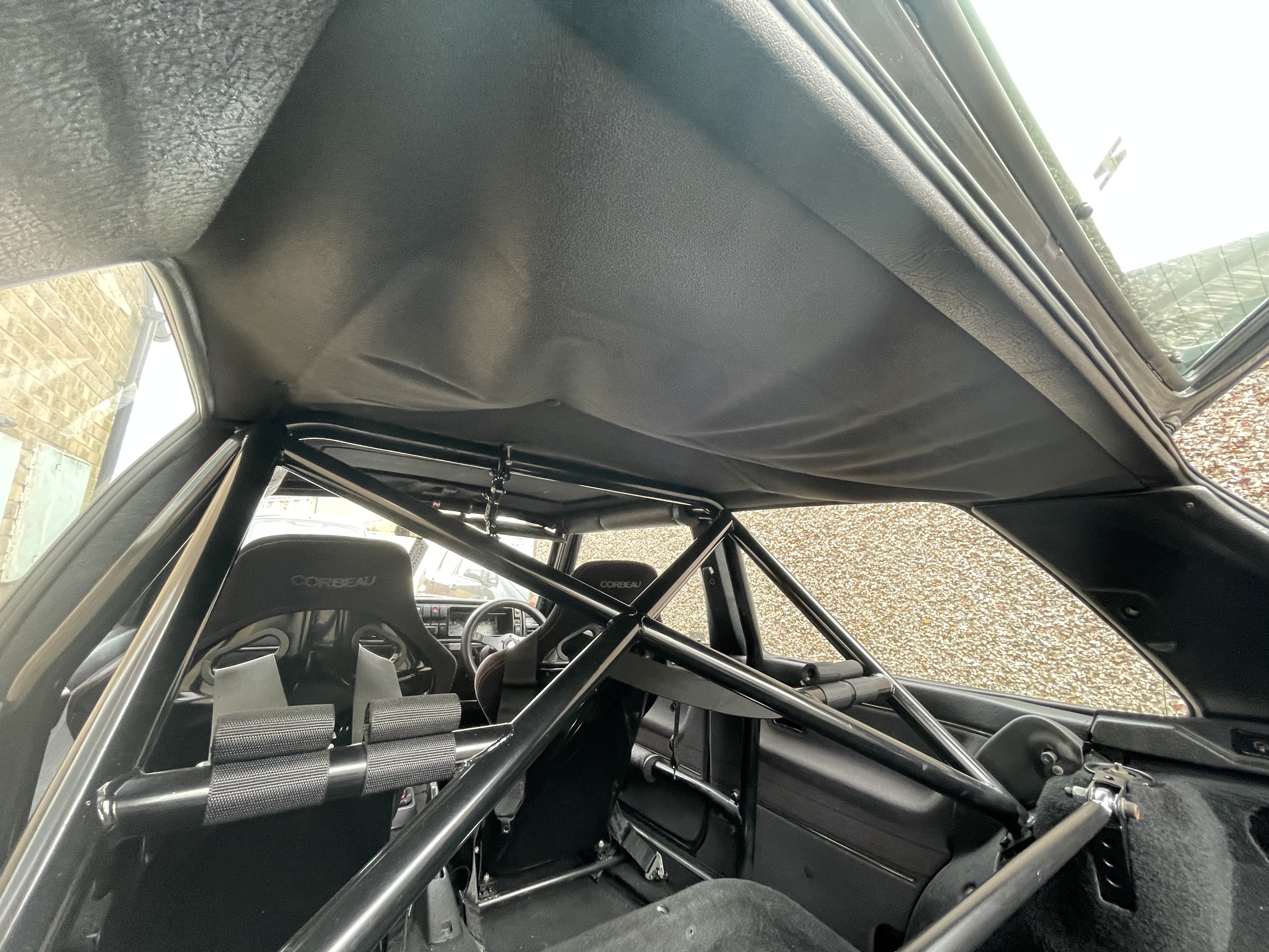

Aside from that I’ve also tackled the sagging headlining. The repair was a bit of a do or die situation as I cant get it out for the cage.

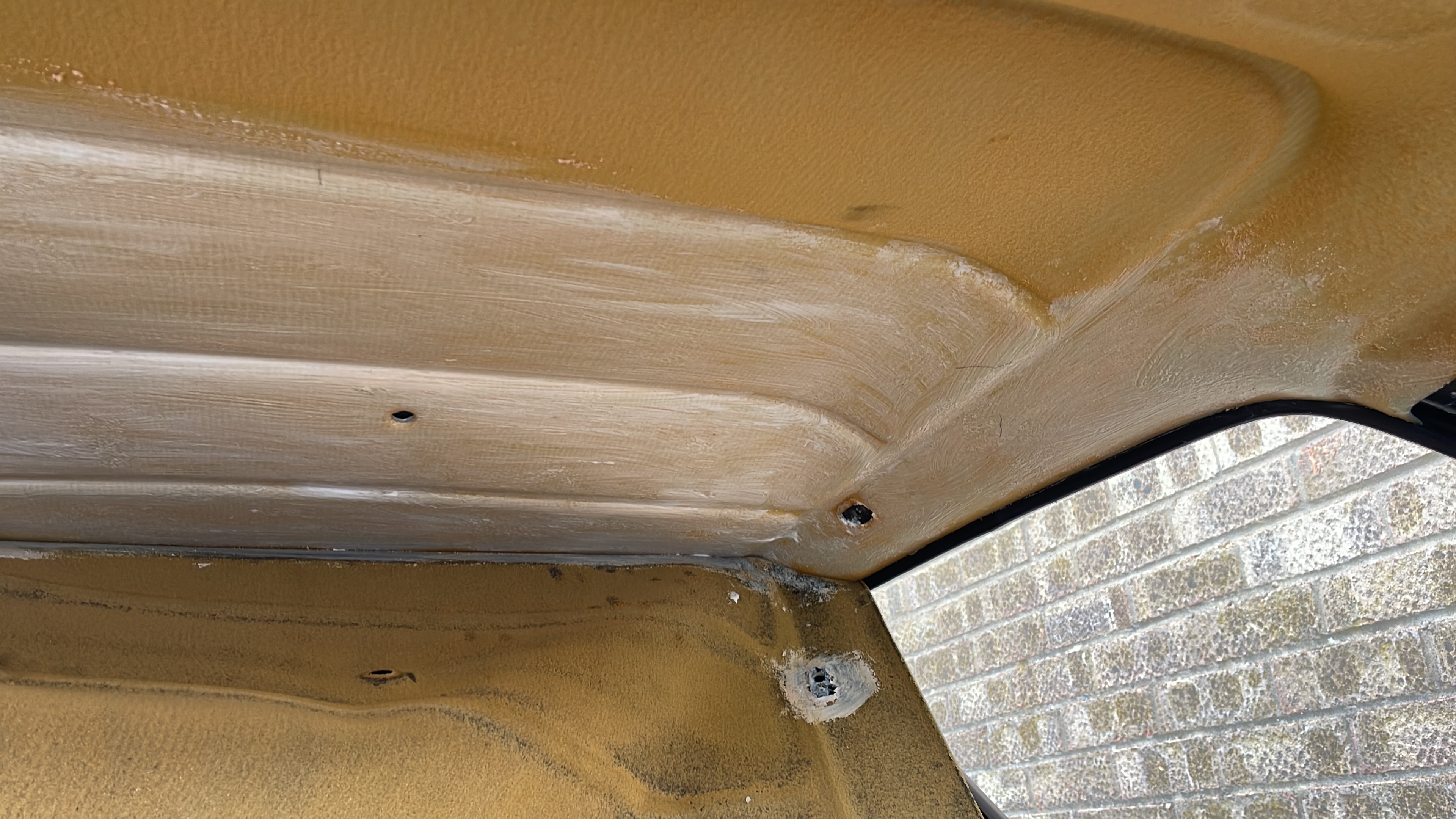

The plan was to peel it back as far as possible to the main hoop on the cage and restick.
To get the best adhesion, I spent some time removing as much of the dusty foam on the headliner fabric, I found the best solution was to rub it off with your hands.
The board was then coated in PVC glue overnight, again to try and give the fabric the best chance of adhesion.
Once the PVA was dry I used a spray adhesive, to restick the fabric.
Very happy with the results! But only time will tell if it can withstand the heat of summer.

I really hope your trick with the PVA works. I did that to mine about 3 years ago (using paper mache as well to add structure).
Last weekend I fitted the fiberglass ebay headliner as it started to droop again after about 2 1/2 years!

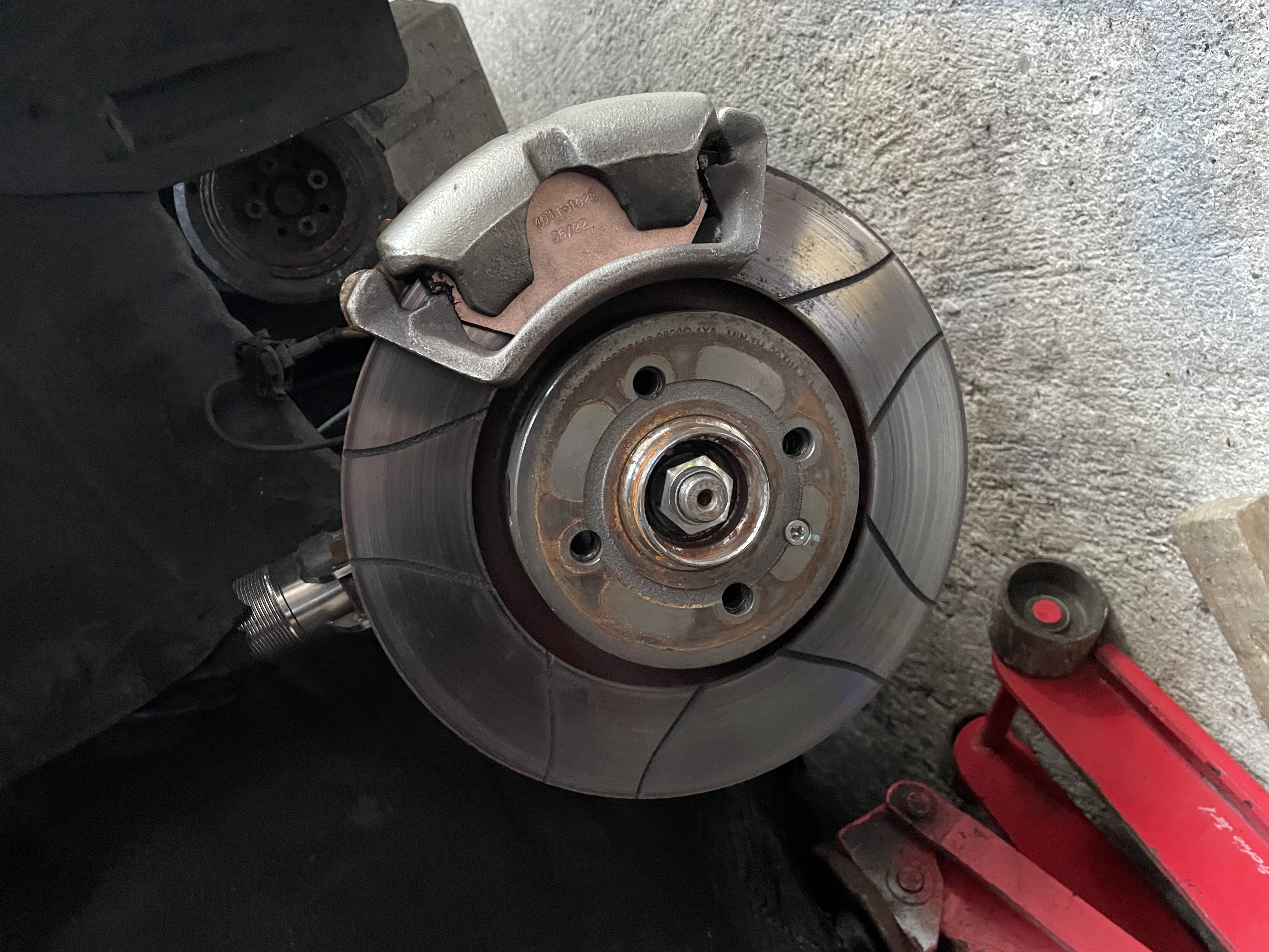

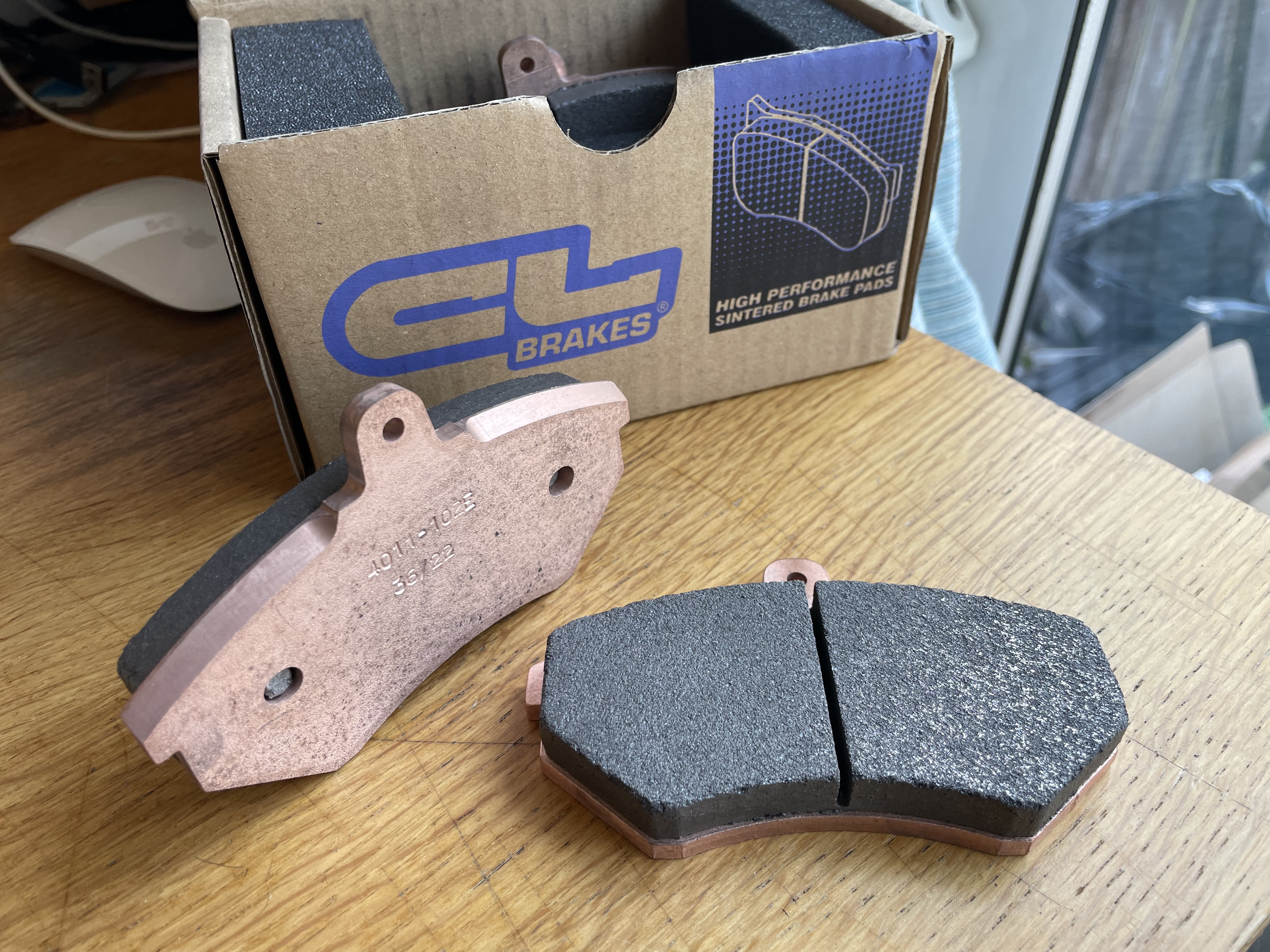

With most jobs now ticked off, the only thing left was some new brakes for the MOT.
I fitted 2 new genuine VW mk4 rear calipers, these had been rebuilt with new seals and pistons for a bargain price of £70.The old calipers were well past it, one was a pattern part and the hand brake mech had seized so I’d only had one caliper connected up to the lever.
When it came to new pads, I stuck with Tarox Strada for the rear -  these have been brilliant, they have the same bite as an OE pad, but can take much more heat – perfect.
For the fronts I’d decided I wanted to try something new. I’ve used DS2500’s for years and I cant knock them, always rock solid and can take lap after lap without fade.
However I’d heard such good things about other pads I fancied a change.
After doing loads of research and chatting to some mates, I’d settle on Carbone Lorraine RC6’s, these had a better coefficient of friction at 0.5 oppose to the 0.46 of the DS2500’s and could take over 1000 degrees C.
With my order placed, I had a call from CL, they were unable to get any RC6’s from the factory for my G60 calipers, but they did offer me a free upgrade the RC8’s…
in for a penny, in for a pound!
These are a real bit of kit! I was sceptical about going for such a high end pad, as I still use the car on the road. After doing some digging I found out they are 0.6 coeffient from clap cold. So the initial bite should be fantastic.
After everything was fitted I gave the brakes a full bleed with ATE type 200.
I went out that night to bed the pads in, 70mph down to 20mph medium brake pressure 25 times in a row.
It's safe to say I’m totally blown away by the pads, theres so much feel and the initial bite wants to rip your face clean off! I’m looking forward to trying these on track.

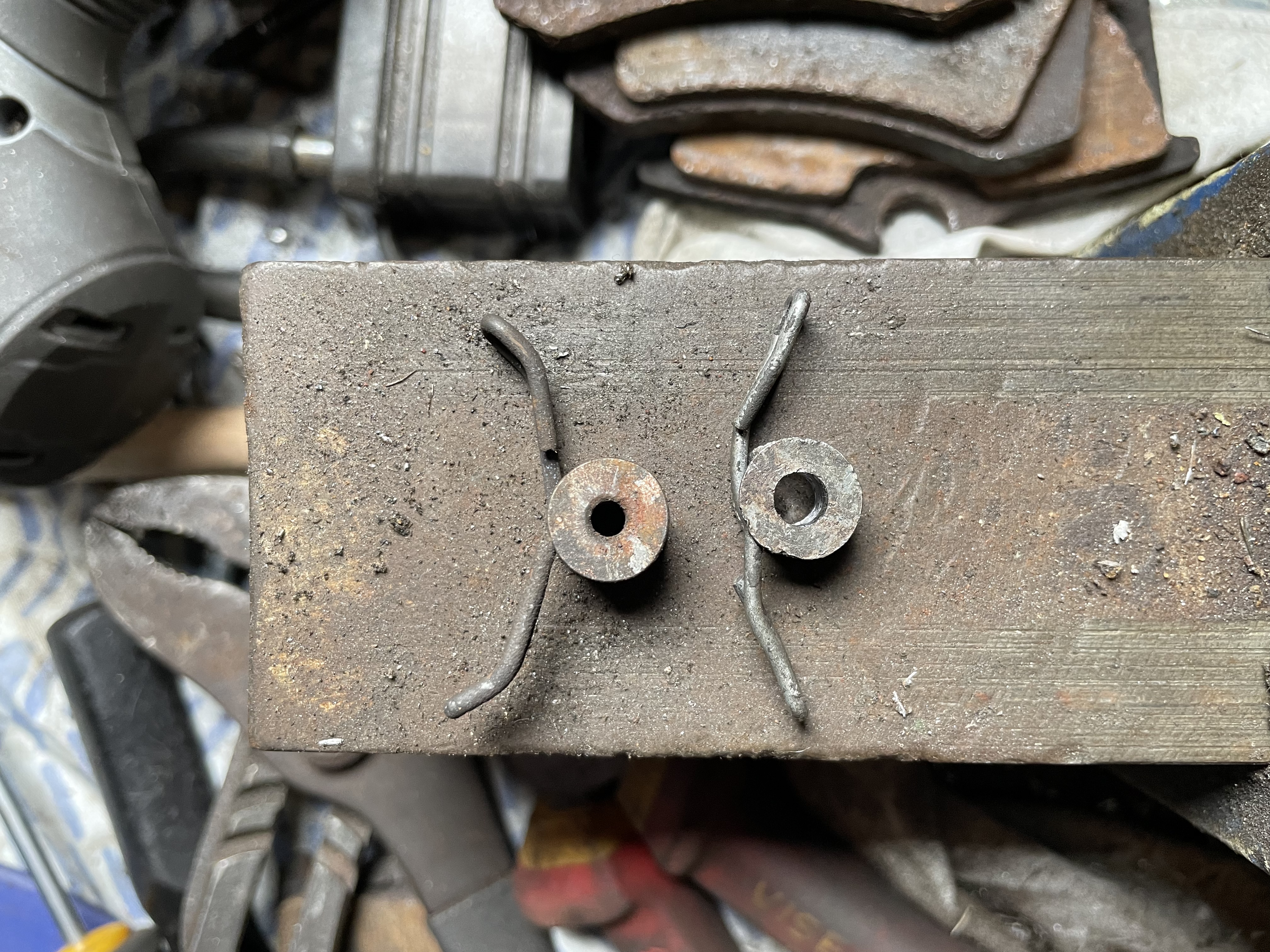

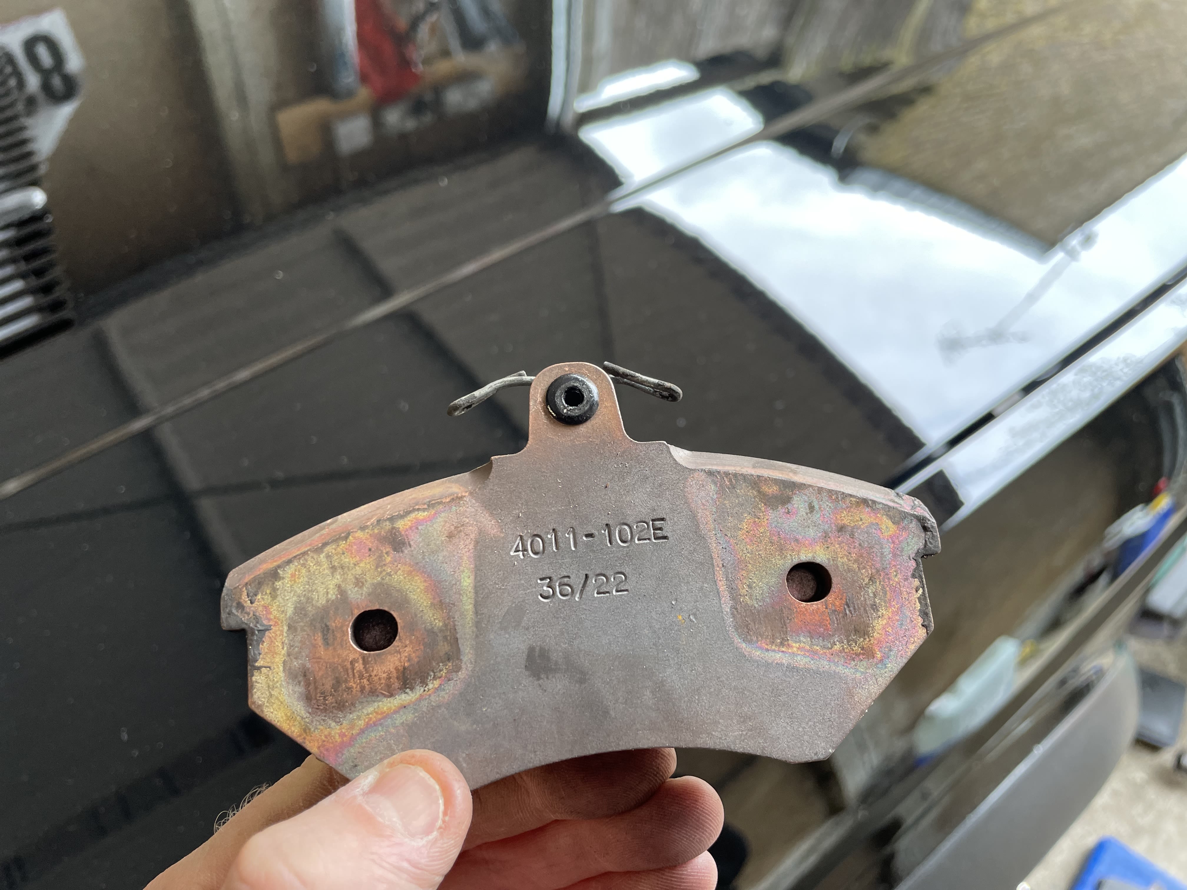

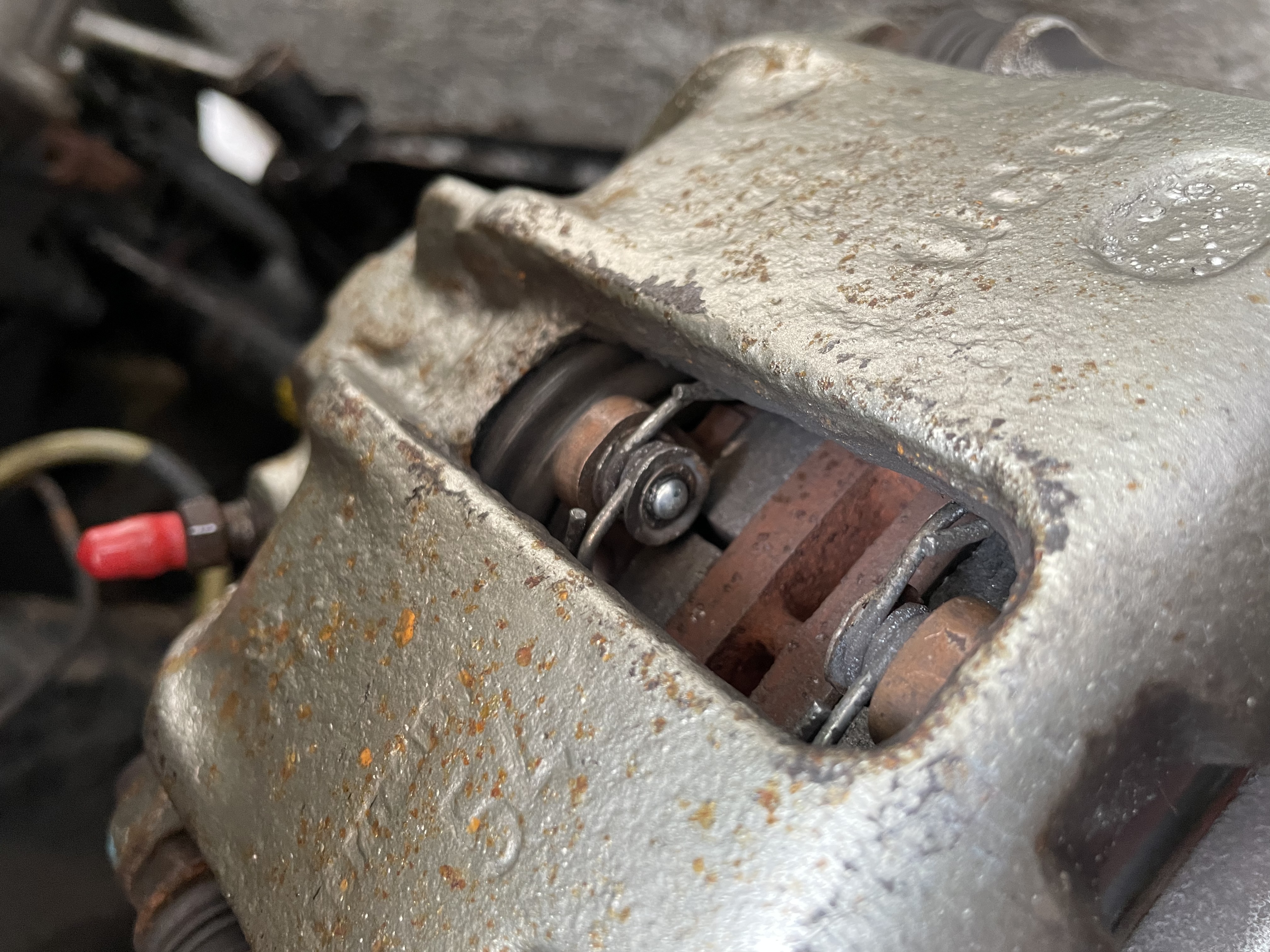

My only complaint after driving the car, aside from the squeaky brakes when cold – which I can live with – is the pad knock. Because they are designed to take so much heat and expand in the carriers, on the road they knock and clatter about.
I messaged CL to see if they did a spring kit for the pads, the response was “it’s not deemed necessary on race cars” … which is totally understandable!
So I’ve retro fitted some spring from a set of old rear pads.
The springs were drilled out, adjusted, the hole in pads was also drilled out and then the springs riveted to the pads.
I’m yet to try the car, but I’m hoping that’s cured it. Once the pads wear down I’ll have to remove them as they will come in contact with each other, but I’ll work another solution for that when the time comes.

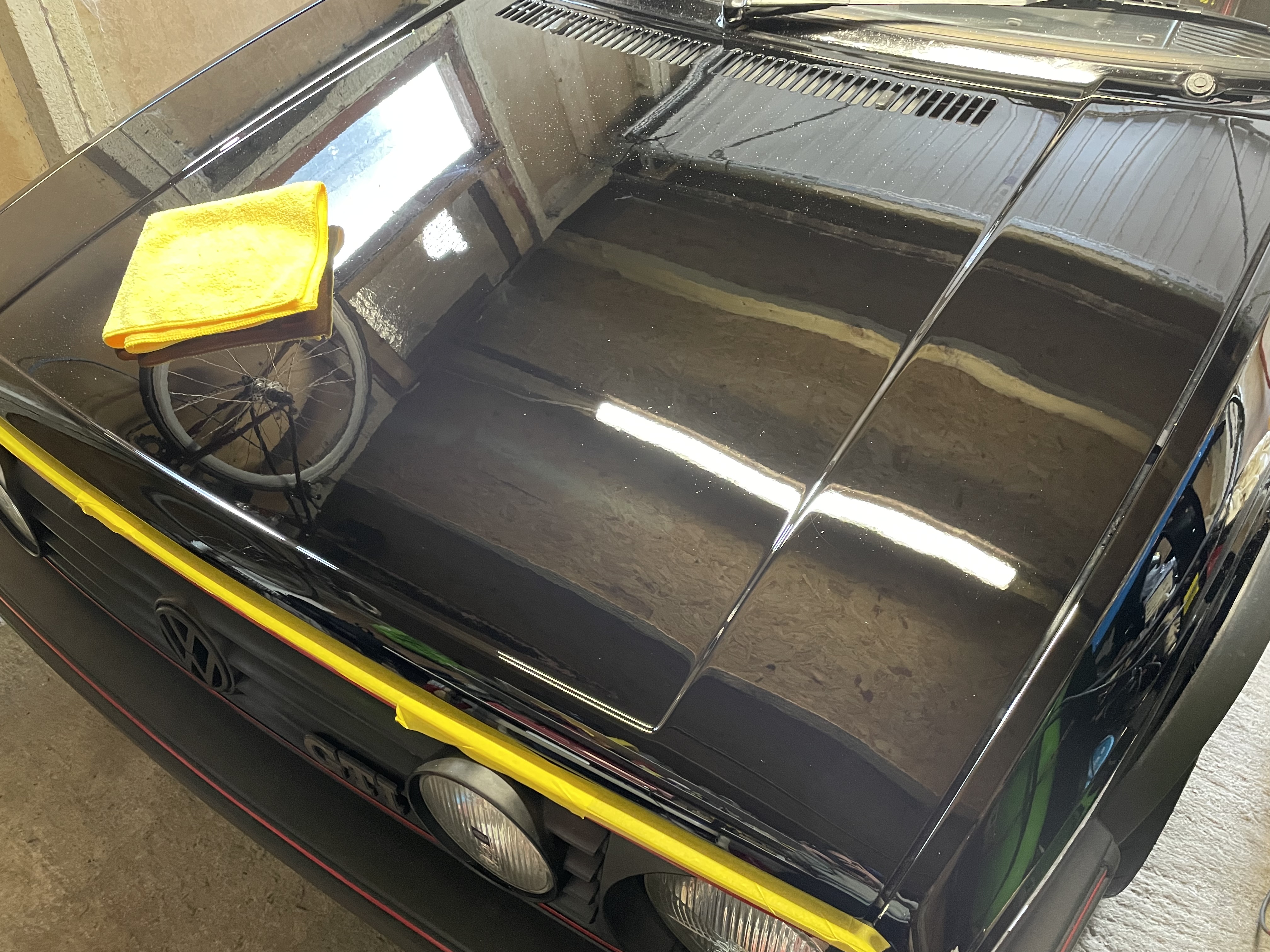

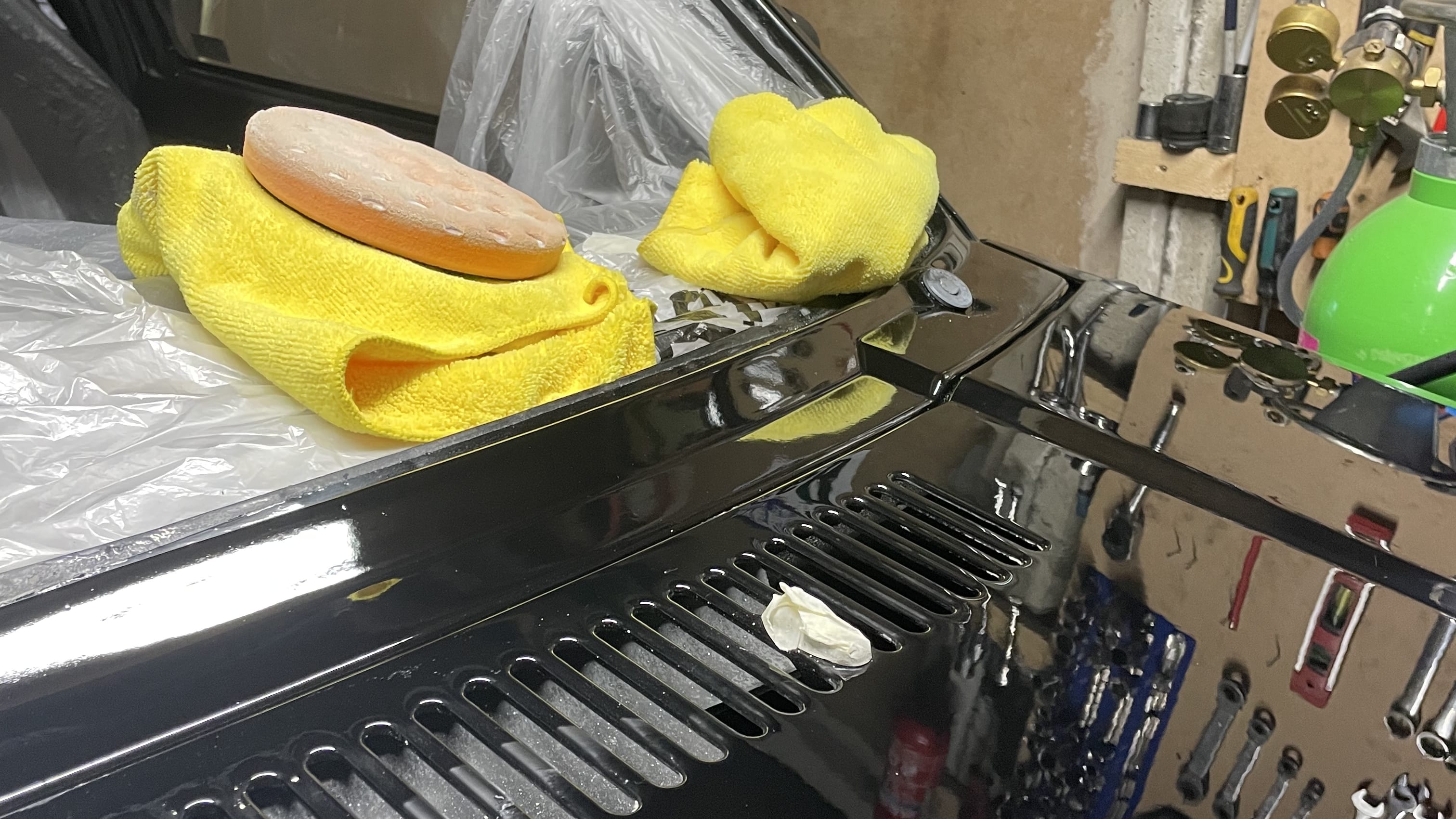

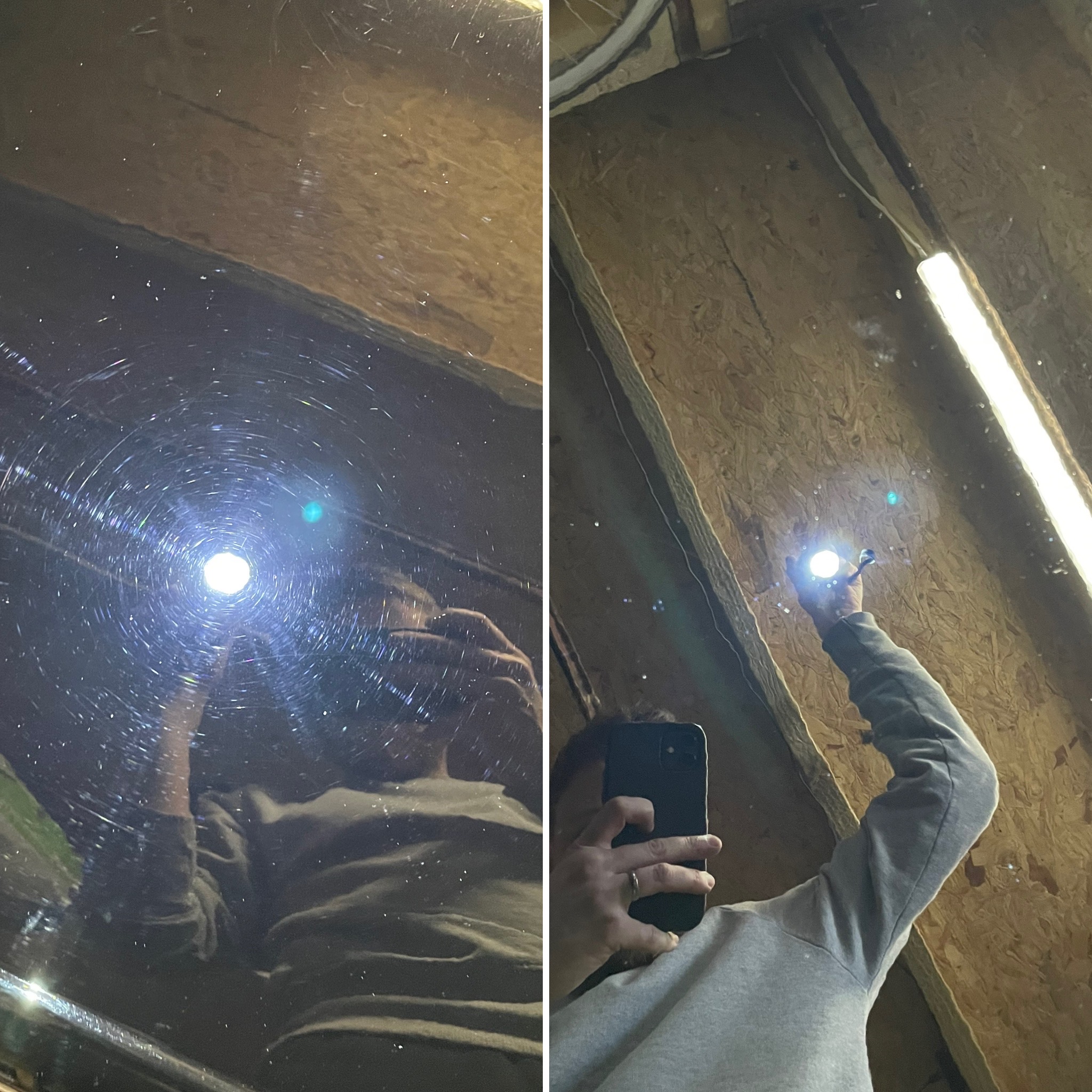

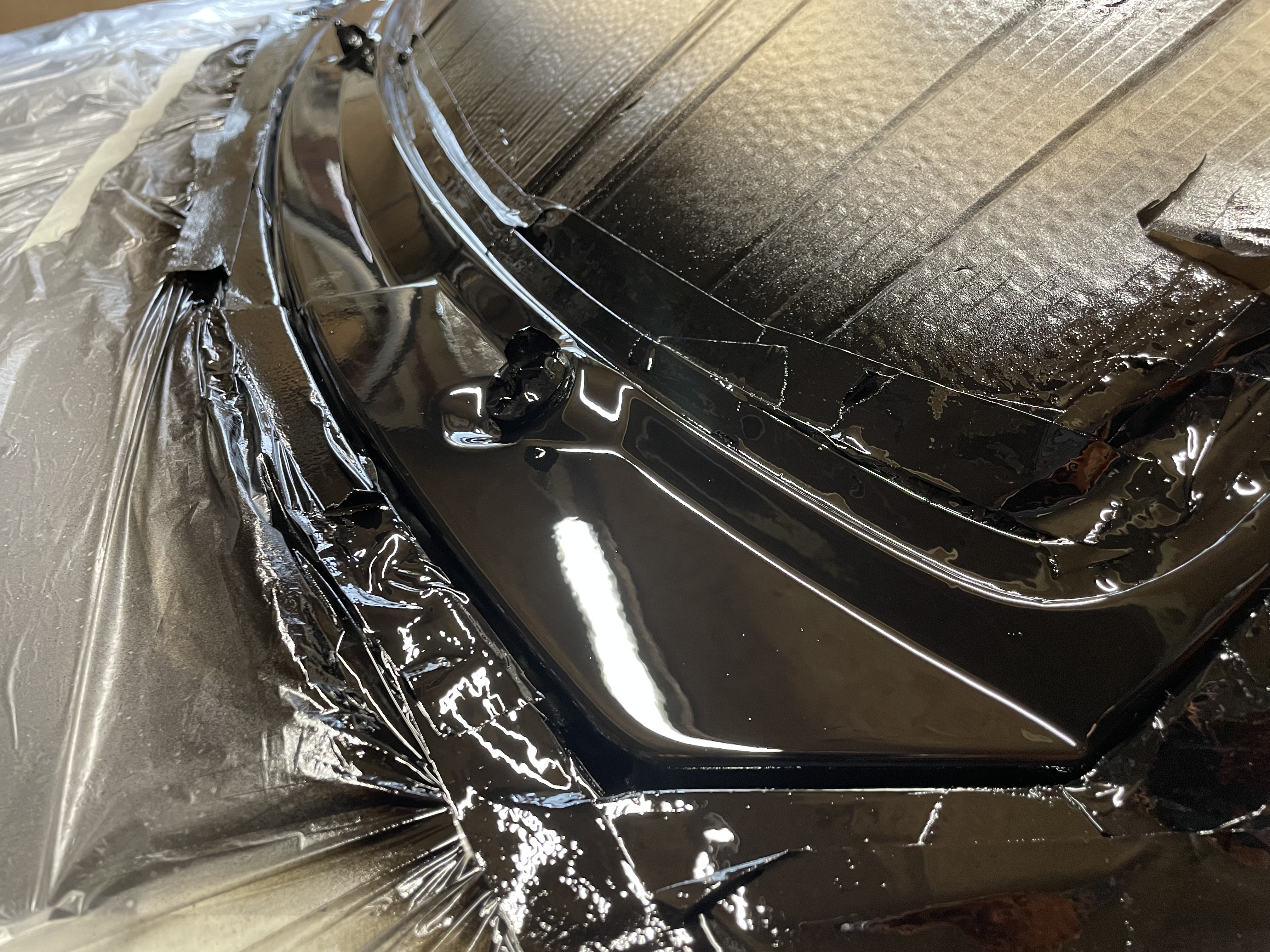

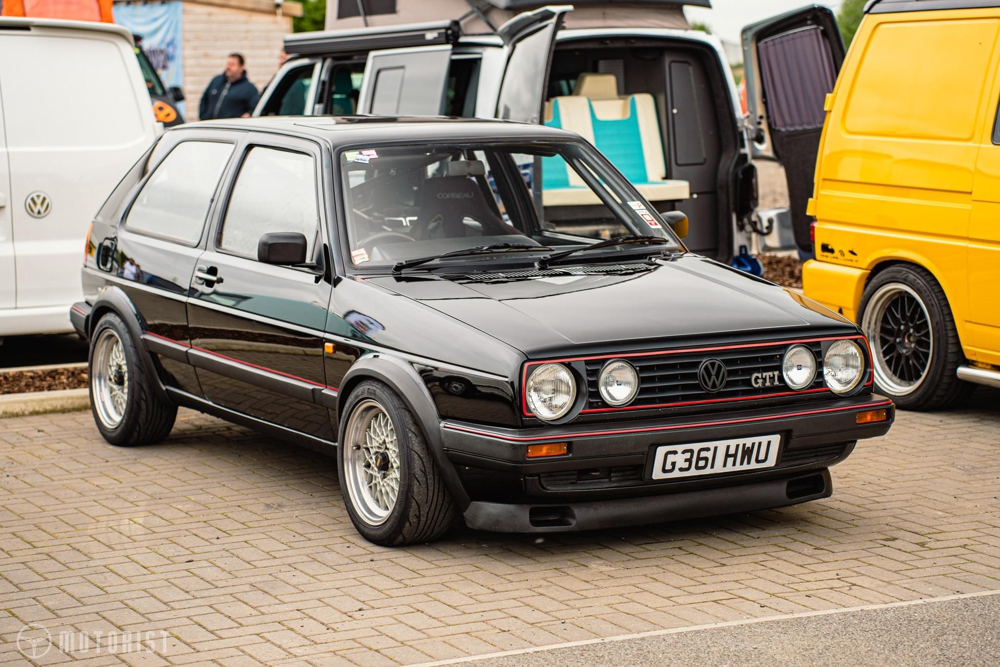

I helped out again this year at Elsecar at The Races. Simon asked if I wanted the Golf inside this year… This was the excuse I needed to give the car a much need clean up and polish.
I always try and keep it looking the best it can, but artificial lights show every imperfection.
So I busted out the machine polisher and got busy
I used 2 stages on this, medium pad and a refining pad with Menzerna products.
I went to town on the bits I’d painted, but just did one stage on the places that are still in original paint. There’s not much paint left to polish and its getting very thin on the rear quarter.
It was nice to spend the time making it look really clean again!
I parked up next to Rob in his incredible mk2, this is the same Rob that does track days with us in his S3

I used to run the CL6s.
Loved the performance, but couldn't stand the squeal on the road.
Couldn't seem to get them up to temperature on normal road driving.
They now only come out when I have track days.

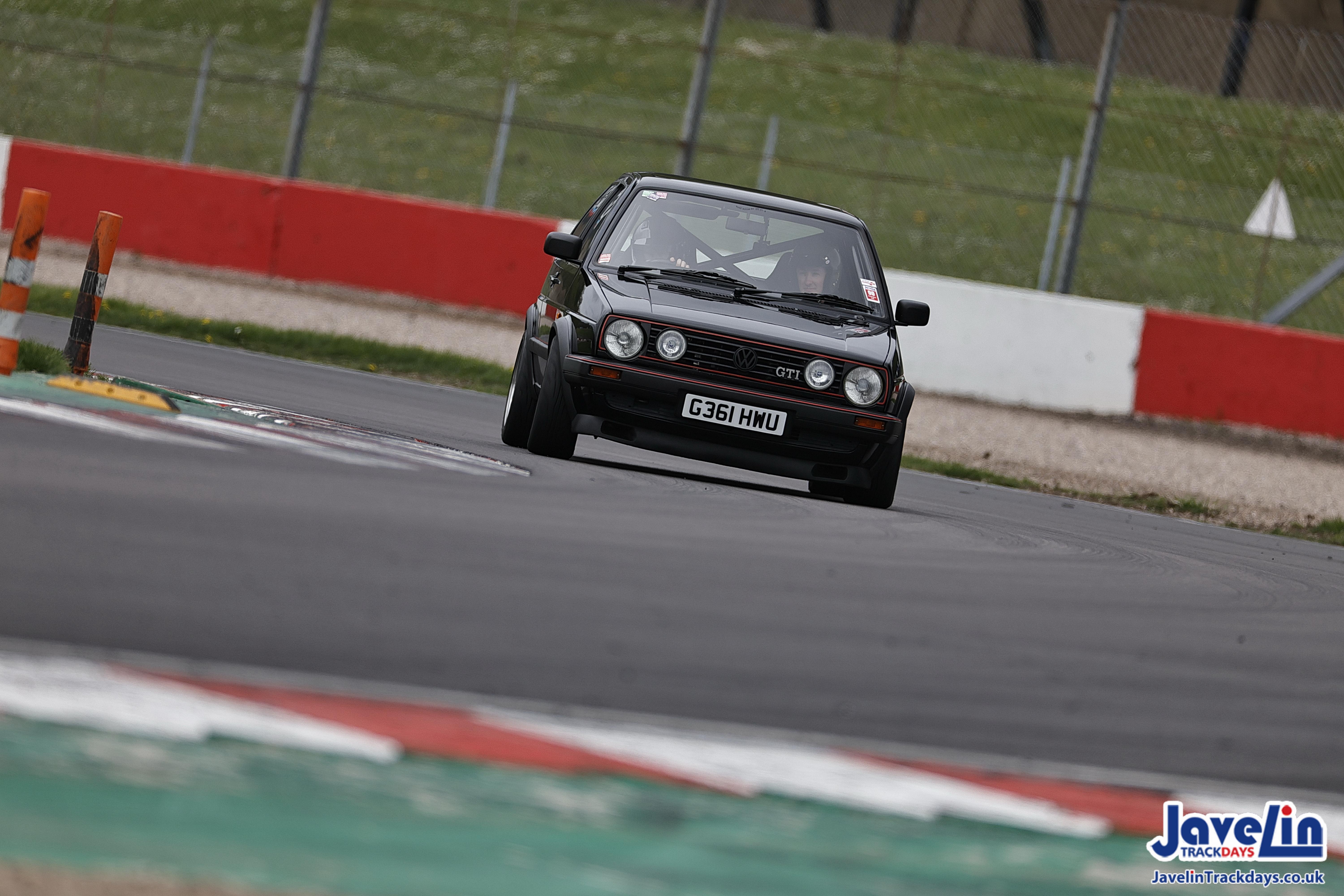

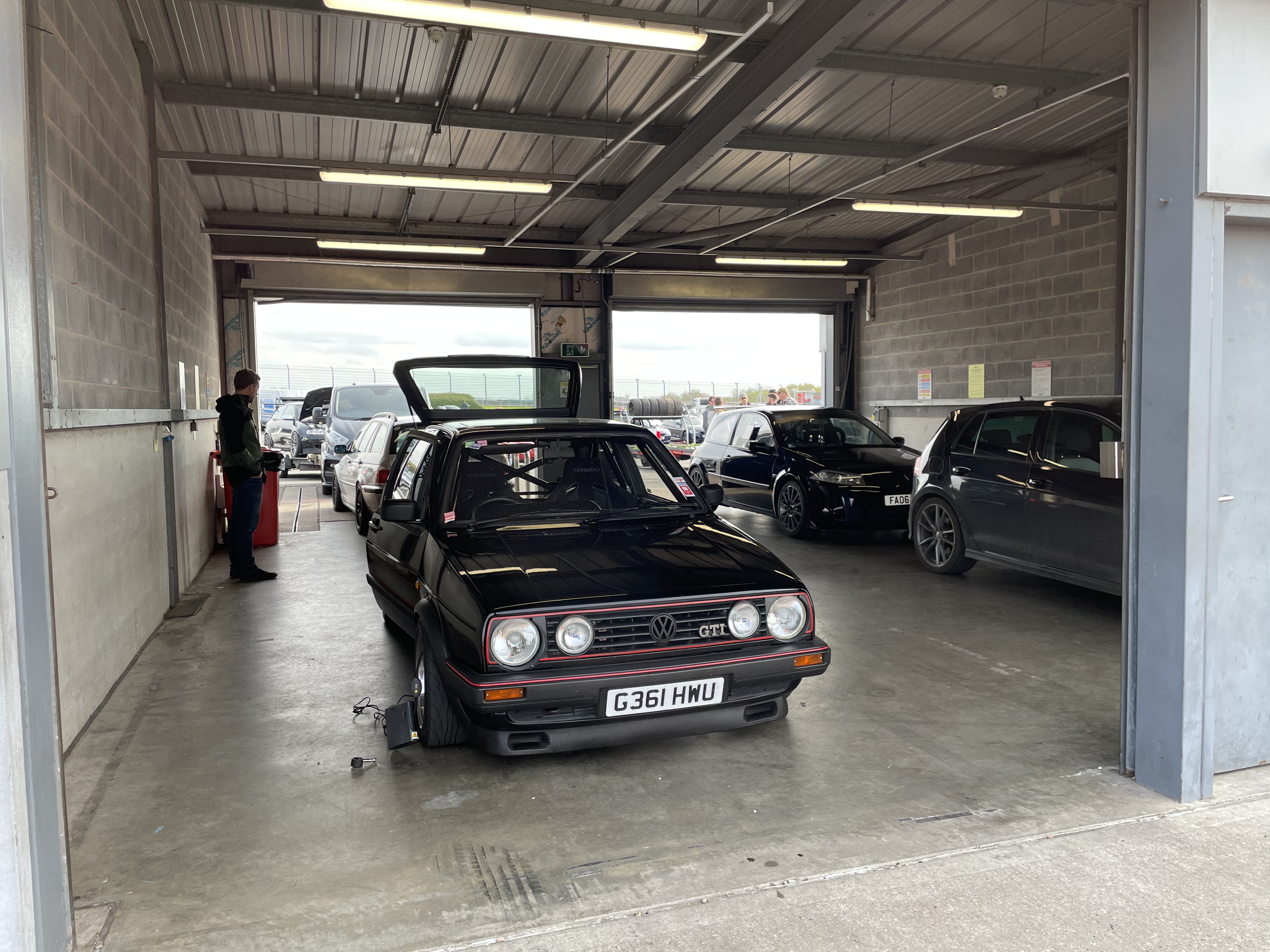

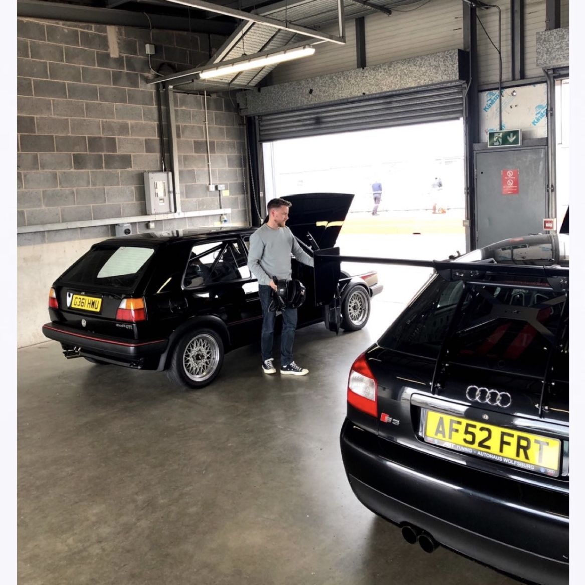

Donington Park 2023
After all the recent modifications, I was excited for Donny and to see how the car performed.
After a 2 hour drive, we arrived. My mate Jim in with me as passenger, Brooke in his e46 touring, Rob in his S3 and Dunc in his Clio.
We are getting pretty good at this track day lark, along with an F1 team assortment of spares and tools, we added a kitchen to the list of “must-haves”– Yorkshire tea, Ginger Parkin and chocolate Hobnobs to boot!
The day went really well, slowly picking up the pace.
I was soon taking Craner Curves flat in 5th, the car felt really planted and I often found myself catching a lot of fasters cars through this section and the old hairpin.
One thing I struggled with in the morning was the brakes, They bite so hard its unbelievable, and because I’d got new brakes I was trying extra hard to brake as late as possible and as hard as possible, which resulted in a few lock ups. Luckily my brain engaged, came off the pedal, quickly back on then easing the car into the corner without getting too out of shape…

After a session I noticed the brake reservoir, was completely cool to the touch, which shows just how effective the copper backing is on the pads at managing heat.
The Golf kept battling on lap after lap, without issue.

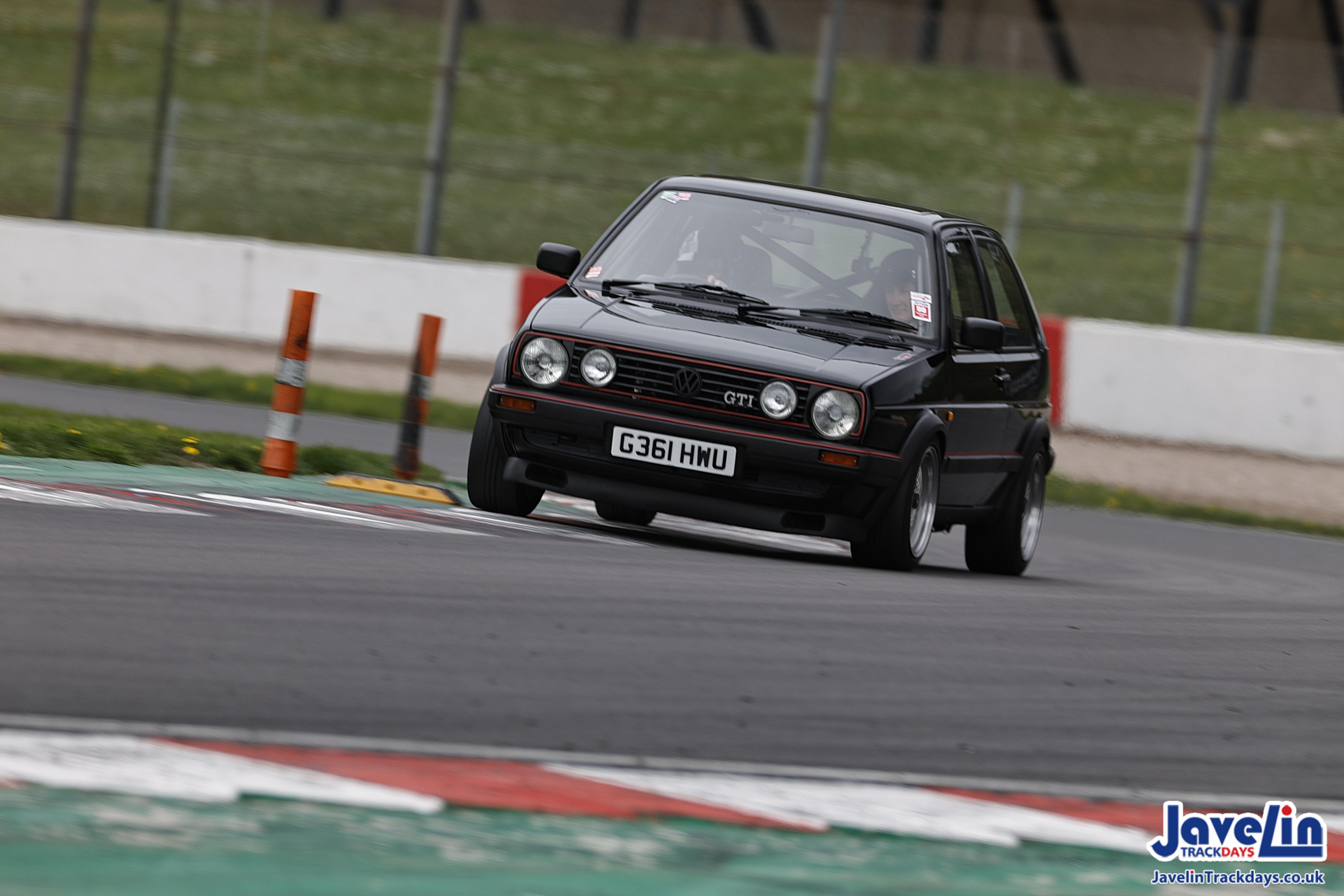

I was really pleased with how the car felt, the steering is like nothing I’ve driven before, so precise and accurate, it was well worth the time and effort correcting the rollcentre and bumpsteer. The only thing letting the side down were the tyres. As good an all rounder as NS2R’s are they just don’t provide the grip, particularly on corner exit that you really want.
Having said that I was catching some expensive metal and had good battles with an E36 M3, a fully bazzed up M4 Competition and this amazing E30.
It was a 1989 320i and according to James the owner it was 128hp and 1,000kg. Which explains why this and the Golf were so evenly matched! Even in a straight line, which never happens!
They seemed to just get the edge on corner exit, and as usual I was probably pushing a little too hard for the tyres (I'll address that soon!)

Unfortunately for Rob, just before the end of the day, the pistons in his S3 decided they didn’t want to be in an engine anymore! So that was end of play for him.
Before we knew it the day was over! It was probably one of my favourite track days, Donington is fantastic! And we had some really good laughs with some really good lads. There’s not much more you can ask for!
Since the track day I’ve been using the Golf as often as I can, I’ve been over to the Motorist a few times, which is always good!
And someone took some nice photos :)

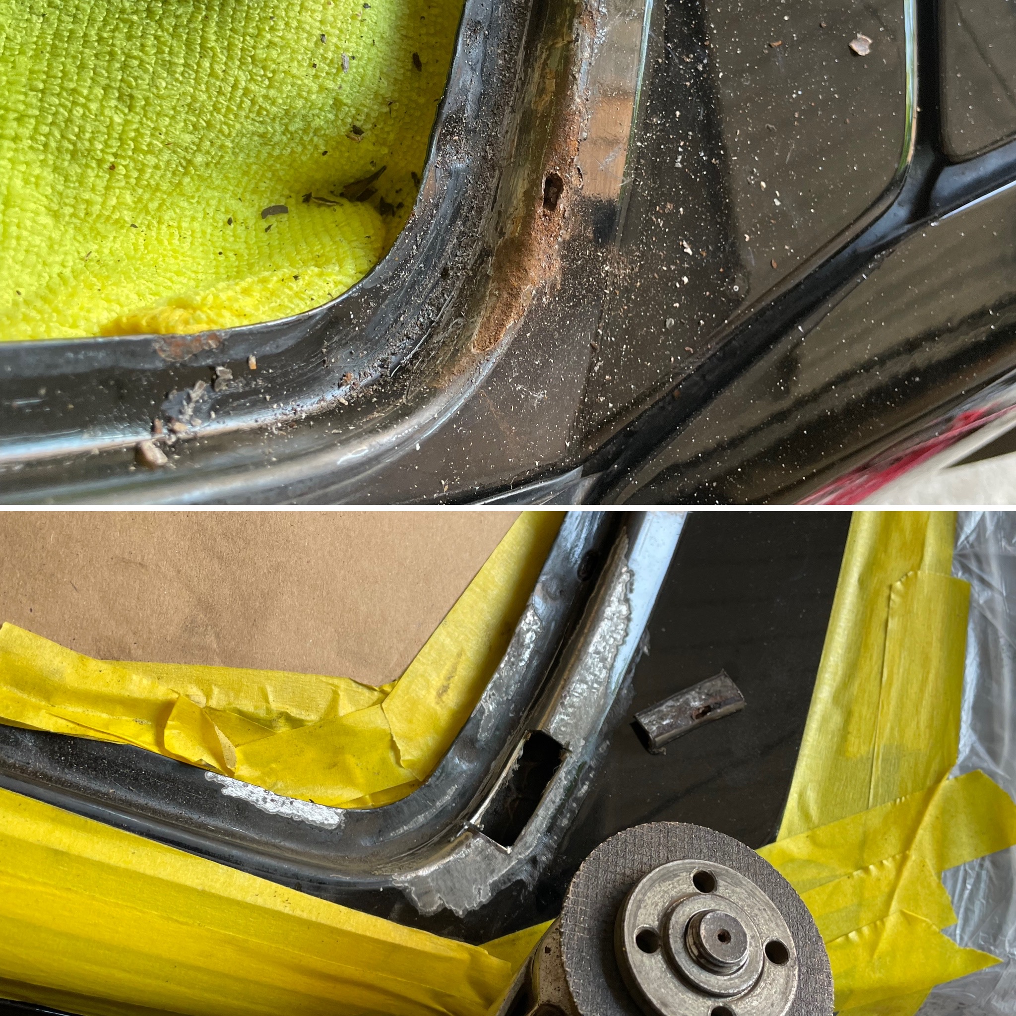

I’ve been tinkering away slowly on a few jobs. First the scuttle has needed attention or years, I previously repaired it when I was 16 with fibreglass… yep… but to be fair, it was all still intact and the rust hasn’t spread.
I also need a new windscreen, as this one has a few chips and some grinding splatter in the glass. The old seal was cut out and the windscreen removed.
The next step will be to remove any other bits of surface rust, etch prime and paint.

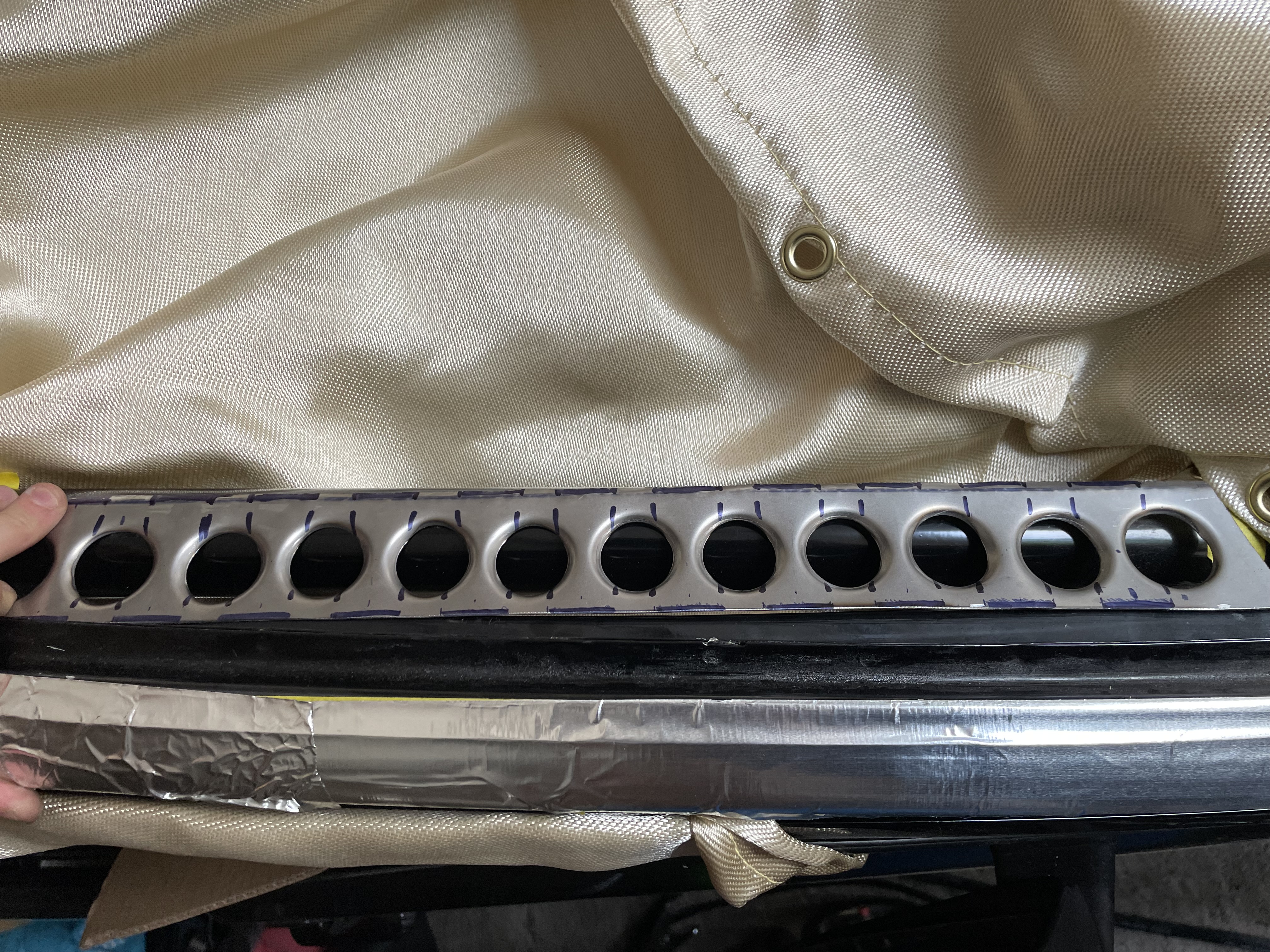

Another reason for the removing the windscreen was to make some gussets for the roll cage.
I always liked how they look and should provide loads of extra stiffness in the shell. As with most things, I’m picky. You can buy sheel steel with the dimples already made in a precut piece. I’ve never liked them as they never fit 100% and feel like an after thought.
I’d made a few CAD (cardboard aided design) templates and settled on this.
I wanted the angles of the piece to match the roof line at the top and the speaker covers in the dash at the bottom. I bought a 25mm punch and a 25mm dimple die.
Both incredible tools! And very reasonable at £10 a piece.

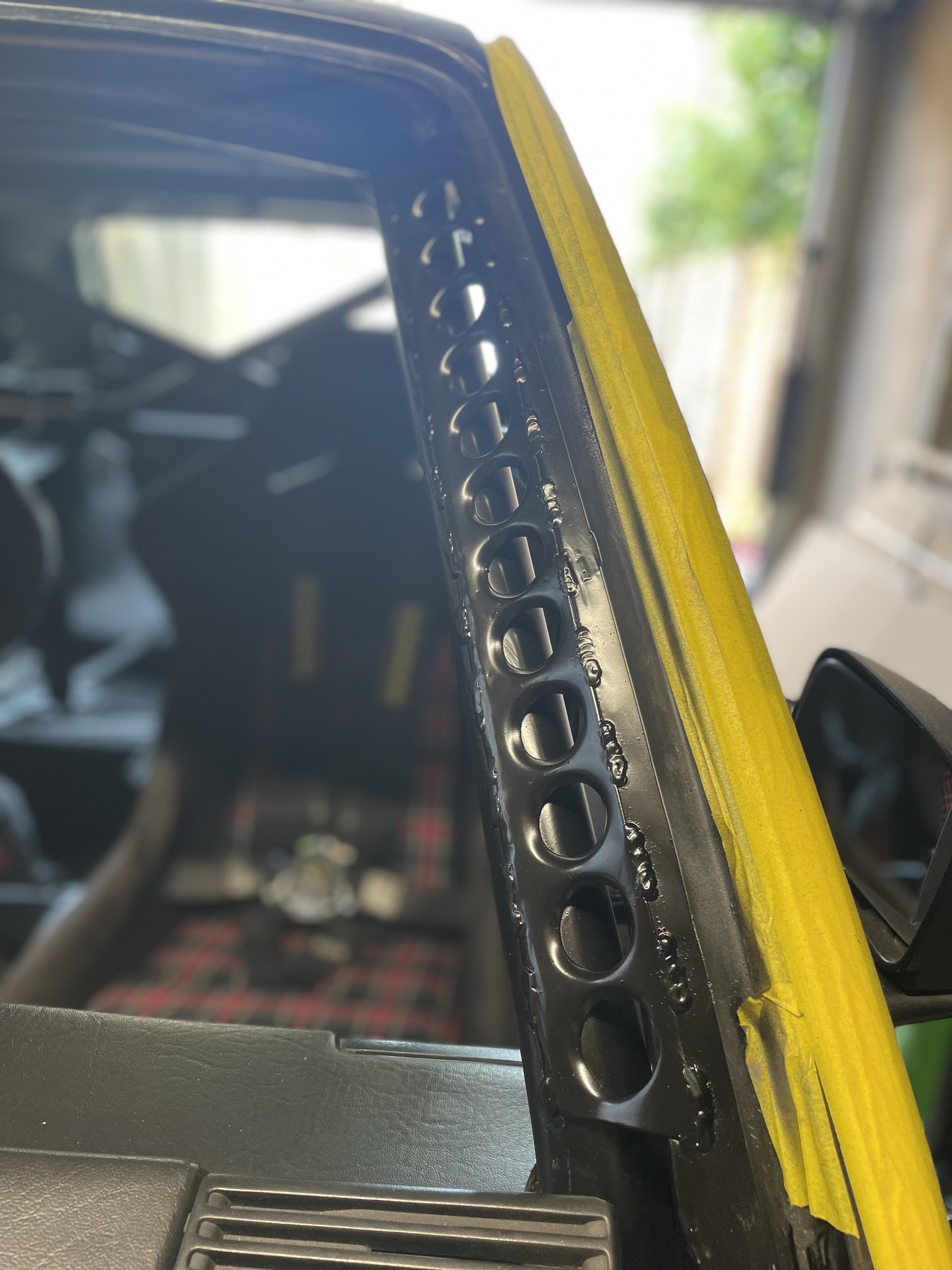

Once I was happy I started making them in steel
Another cheap but incredible useful tool! A deburring tool, used for, you guessed it... a bargain for £7
Dimples were then added.
If you don’t know, the dimples add loads of rigidity to the panel, whilst also reducing weight. Win-win!
Once I was happy, I protected the car from heat/welding splatter as much as possible, using a welding blanket over the dash. I also ali tapped the roof gutters just in case. I’d have been gutted if these were damaged!
Then pen marked where I wanted to stitch weld, making sure to weld inbetween the dimples to give the most strength.
All welded in.
The process was repeated on the other side, then etch primed and painted satin black.
All done!
Very happy with the results. I wasn’t too happy with the welding at first, I’m getting better but by no means perfect. Luckily I’m pretty good with a grinder! lol
Next up will be finishing the scuttle off, and if there’s time before the Ring, I’ll also be making gussets for the b-pillars.

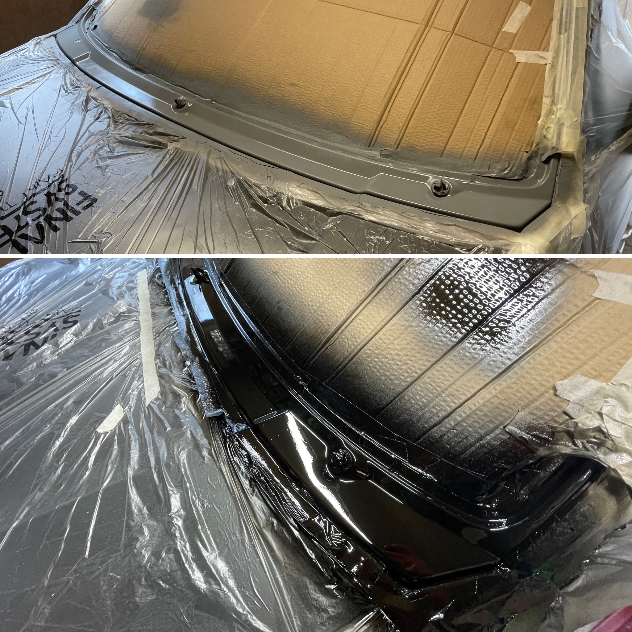

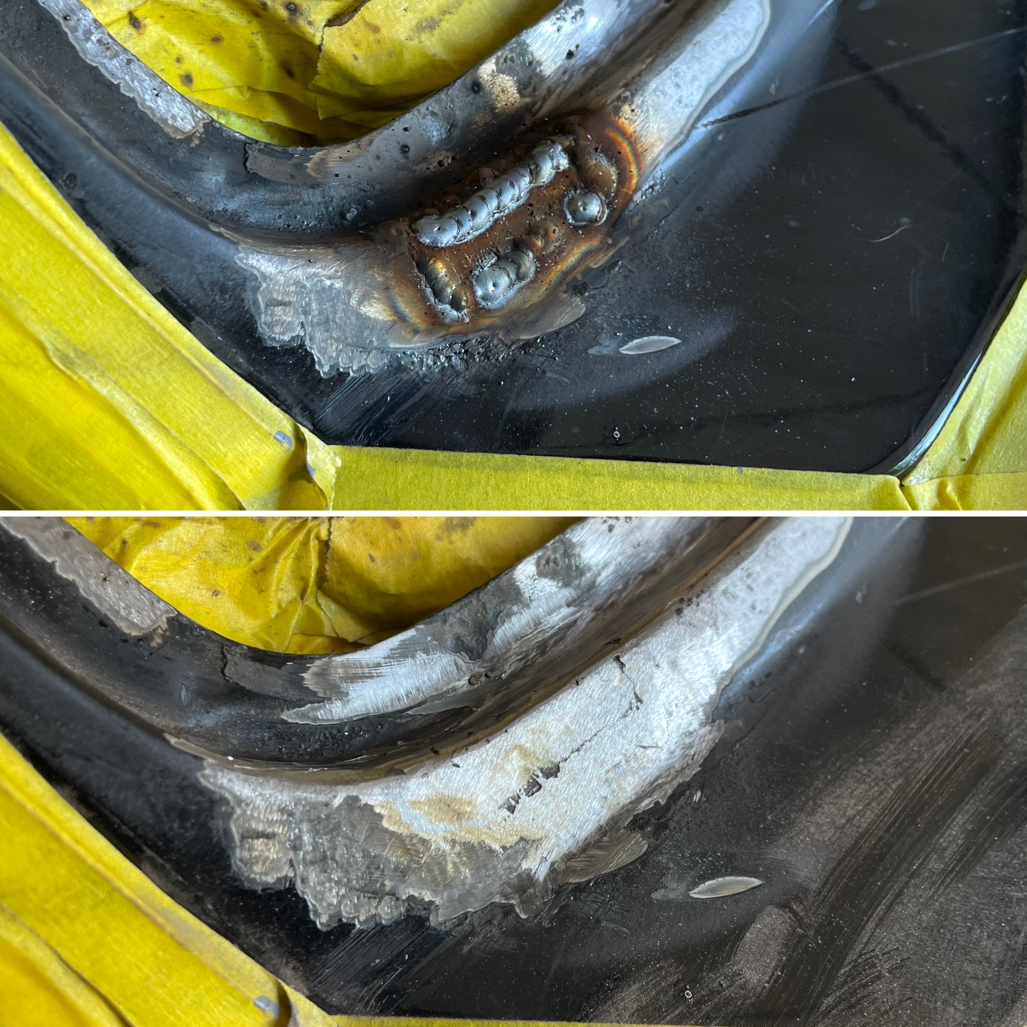

With the gussets done, the focus was back on the scuttle. Another fibreglass hole was revealed near the wiper. This was cut out, and a some fresh sheet welded in.
The scuttle was then keyed with 400 grit paper by hand, making sure to get into the gaps in the panels. I’d managed to get a trim tool under the roof gutters and lift them up enough to get some masking tape under them, which worked surprisingly well!
Etch primer applied in a can, wet sanded with 800 grit ready for 3 coats of base coat, followed by 2 coats of clear.
Really happy with the finish. There is some dust in the clear which is inevitable without a proper booth, but I should be able to wet sand these out.
The image below is straight out of the gun.
One thing I’ve learnt from painting a few things now, is in the clear coat. The clear I use recommend a 2-1 ratio of clear to hardener with 10% thinners, I’ve found this doesn’t flow through the gun well and it doesn’t really atomise very well. I use around 20-30% thinners in the mix, and the paint seems to go on really nicely! Obviously, you run more risk of runs, but it's a lot less work after wet sanding and polishing.
