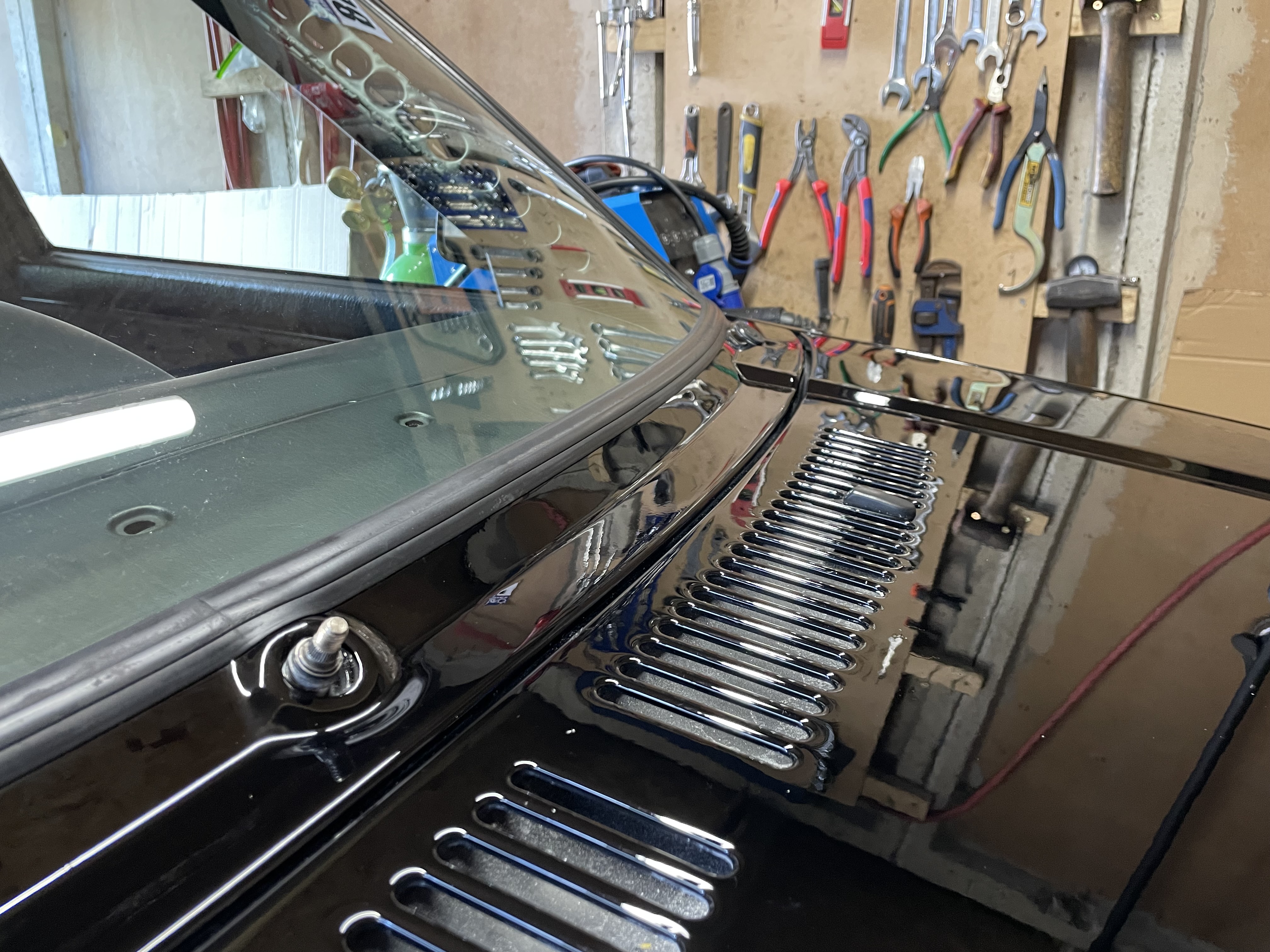

I managed to get all the scuttle buttoned up over the weekend.
But firstly, sometimes things don't always go to plan…

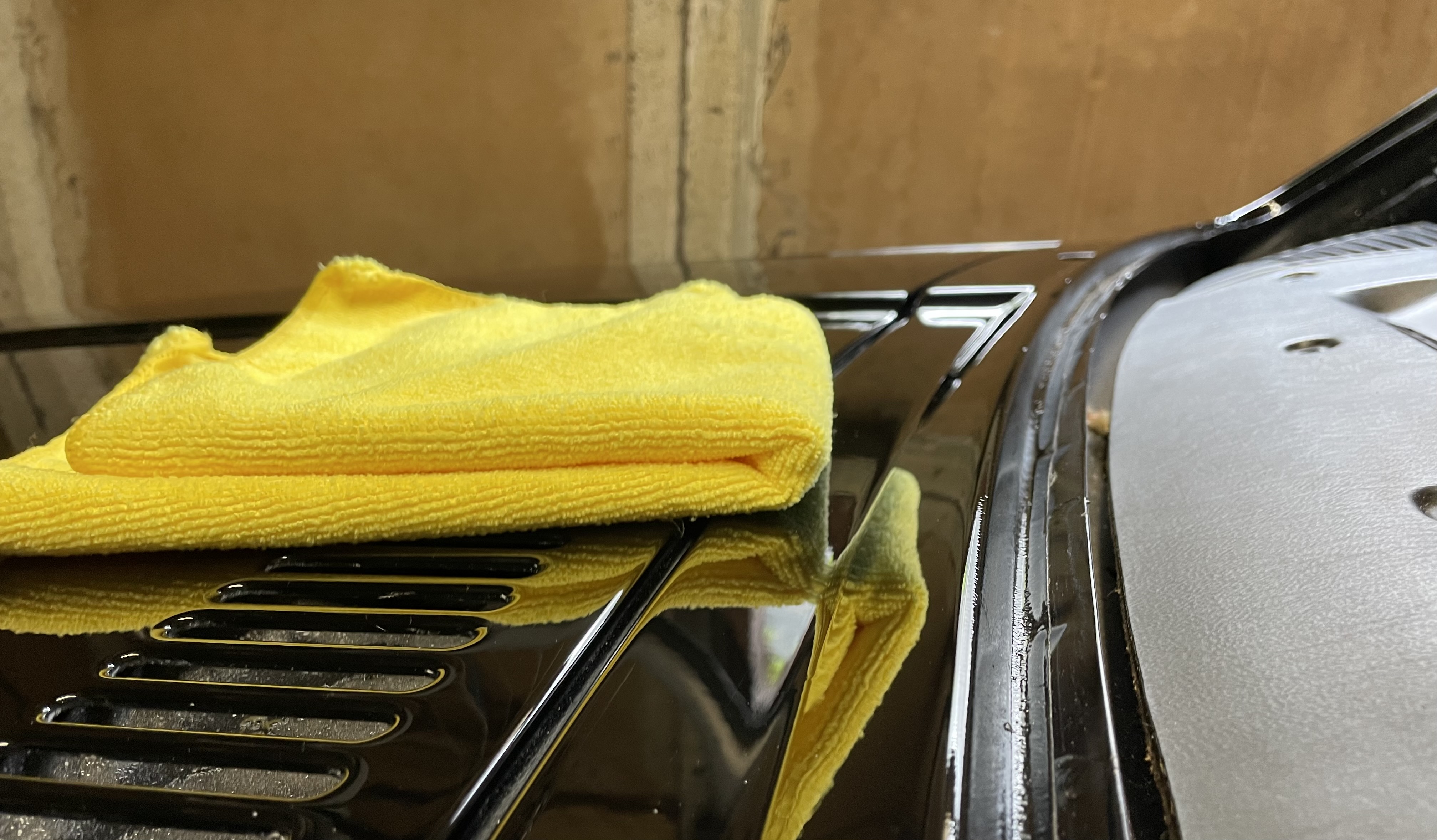

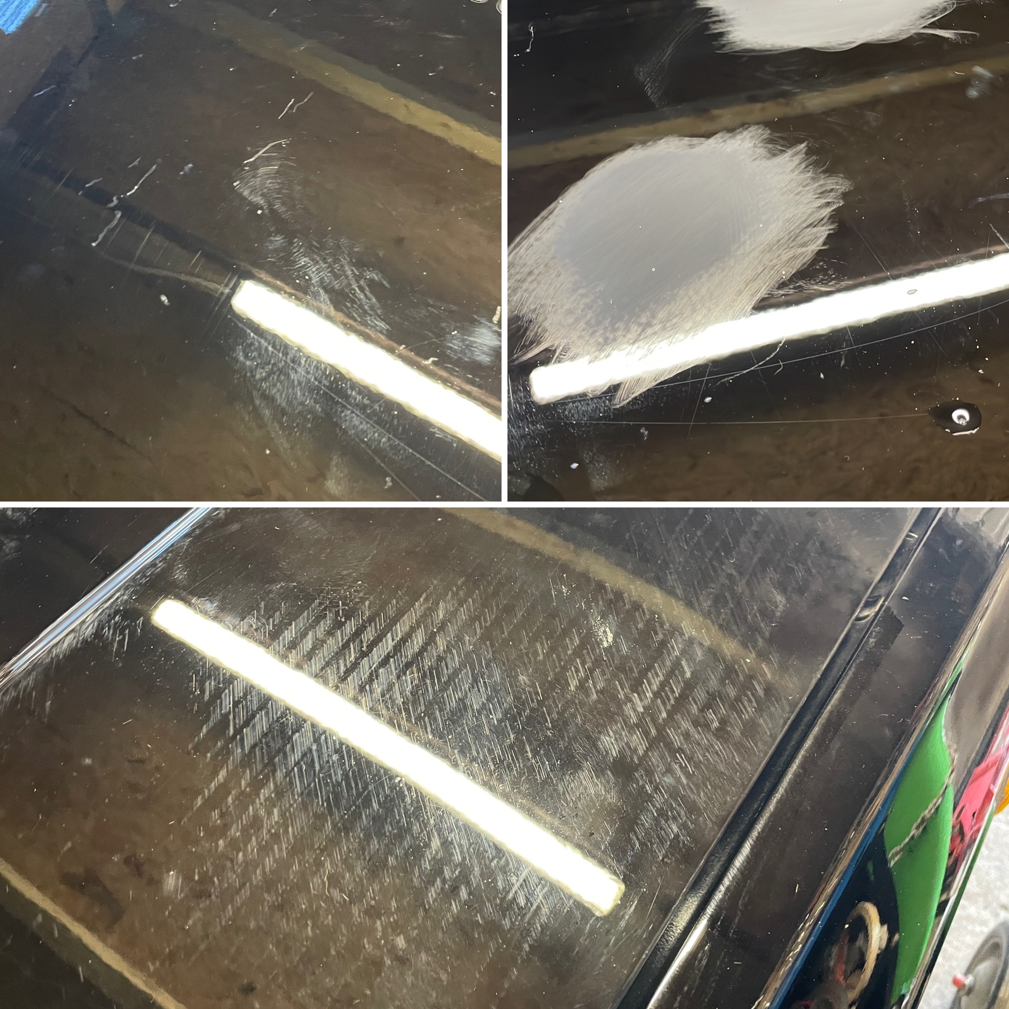

When I was welding, I had a thin plastic painters sheet over the bonnet, with a big sheet of cardboard over the top. Unfortunately, that wasn’t enough, the splatter from the welder got through and destroyed the paint! And the cardboard had left loads of marring in the paint.
Not pretty… Not knowing how much paint I had left to play with I had to just go for it, with the thought that I’d probably have to paint the bonnet as well. So I had nothing to lose.
At this point I decided to give both the bonnet and scuttle a really good machine, as I just wasn’t happy with the dust nibs in the paint, so I decided to wet sand them out as well. I used some 2500 grit on the nibs and a 3000 3M Trizact disc on the rest of the panel, this takes the heads of any inconsistencies.
Usually a quick flick over with the machine and she’s grand, but this time it was a real pain to get the wet sanding marks out. For some reason the paint was rock hard. I ended up using G3 cutting compound on a hard pad, and my machine set on a faster speed than I was comfortable with. The danger on such a skinny panel is cutting through an edge in the panel or bonnet. There was some serious heat in the panel from the machine work but luckily it went well. Refined using Menzera Medium on an orange medium pad and finally Menzerna Super finish on a red soft pad.
I’ve said it before, any type of paint work is stressful… at any moment you’re back to square one, so I was very happy to have this one ticked off. Luckily the bonnet survived!
Treated myself to a cold one!

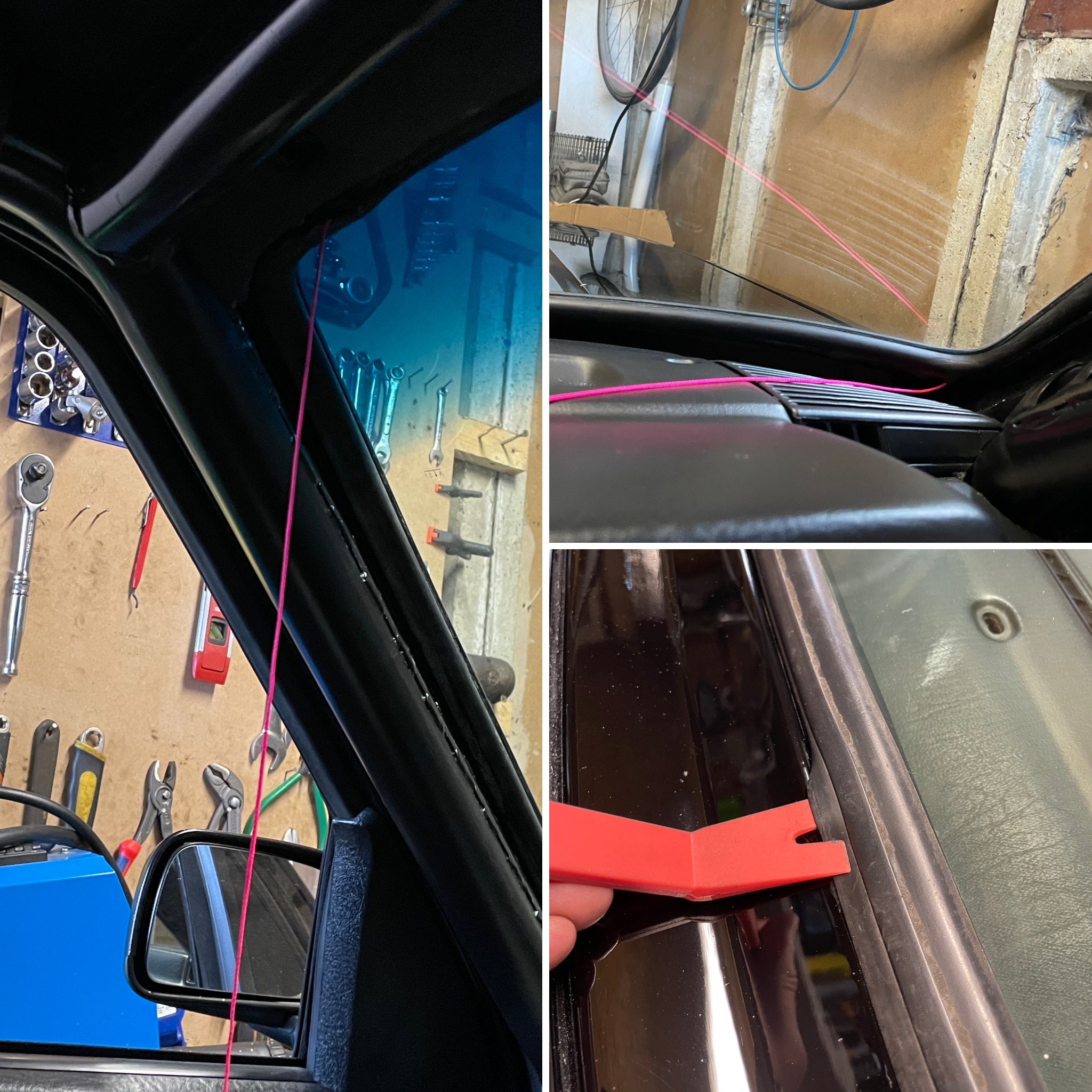

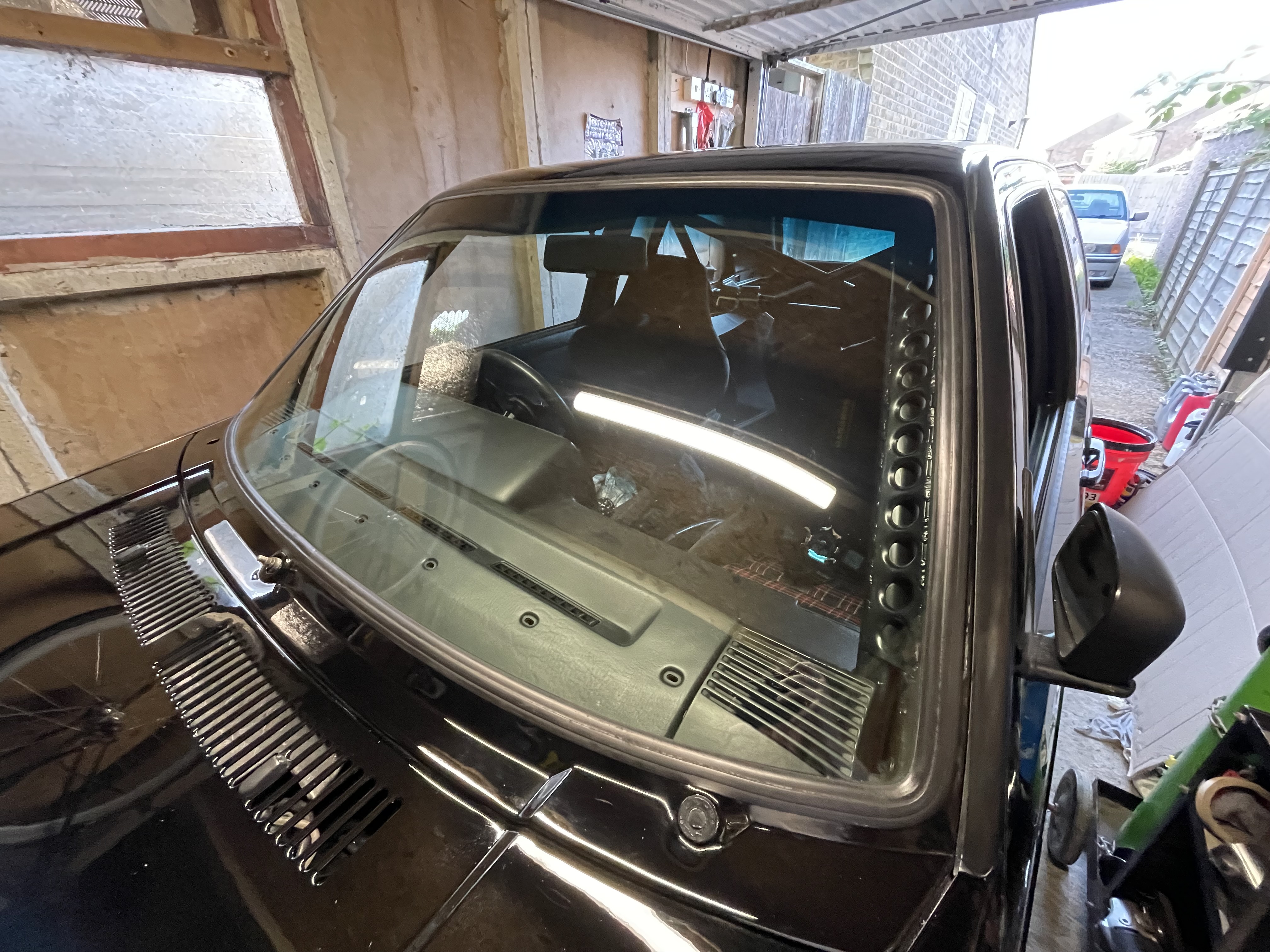

I then managed to refit the new screen on my own, using some builders brick level string in the seal, putting pressure on the outside while working the string around the inside in a circular motion.
The new top tint has really grown on me! Almost like a factory sunstrip, which is right up my street.
Last job was a clean of the glass and a couple of coats of Swissvax Sheild Wax.
Glorious.

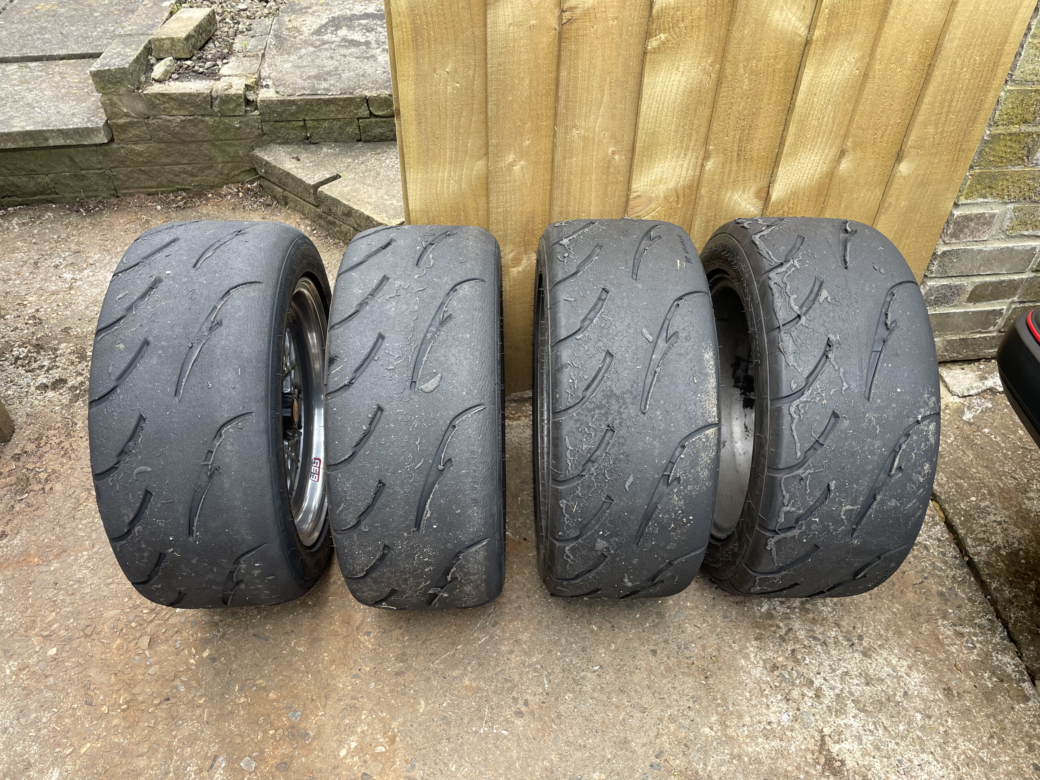

After the sprint, my wheels were absolutely obliterated, the pad deposits from the CL RC8’s were like nothing I’ve seen before.
I used some iron out remover, it took a full bottle and about 10 goes at it to get the deposits off.

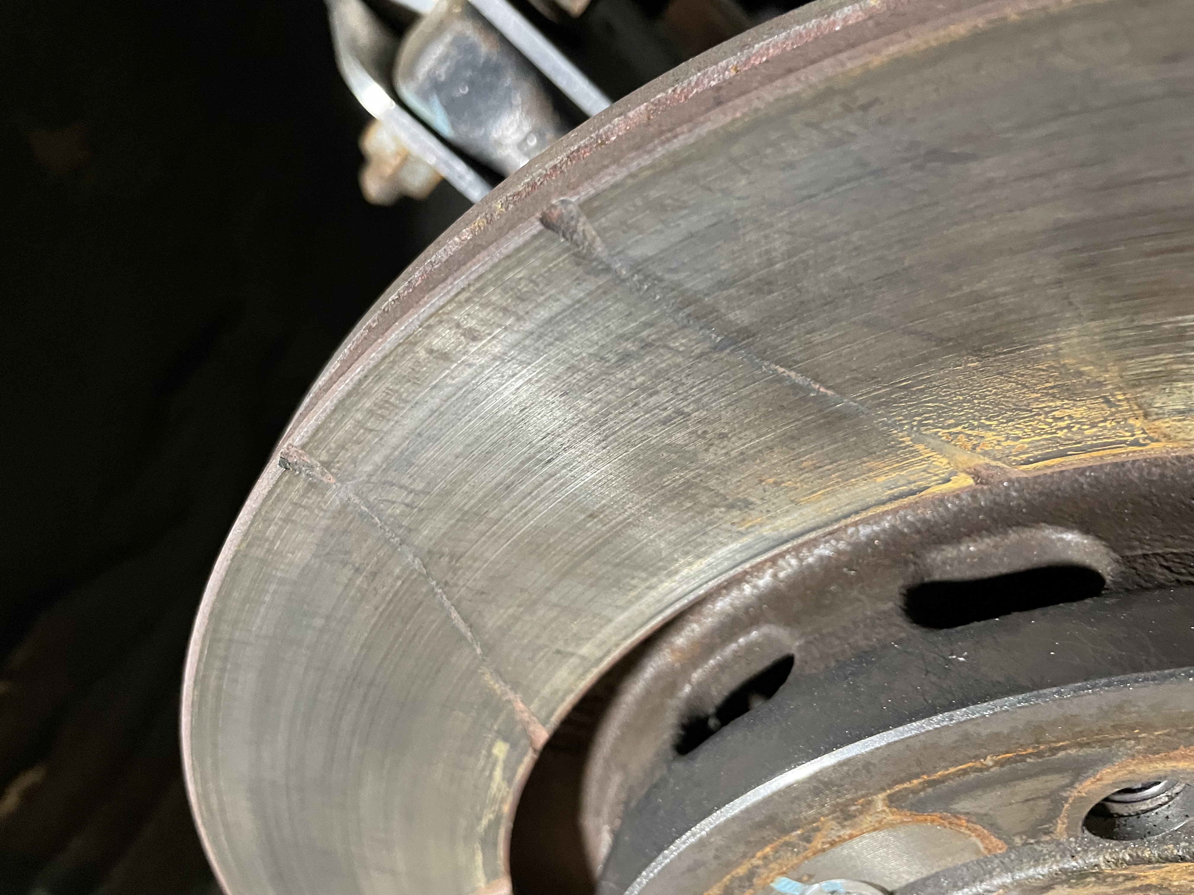

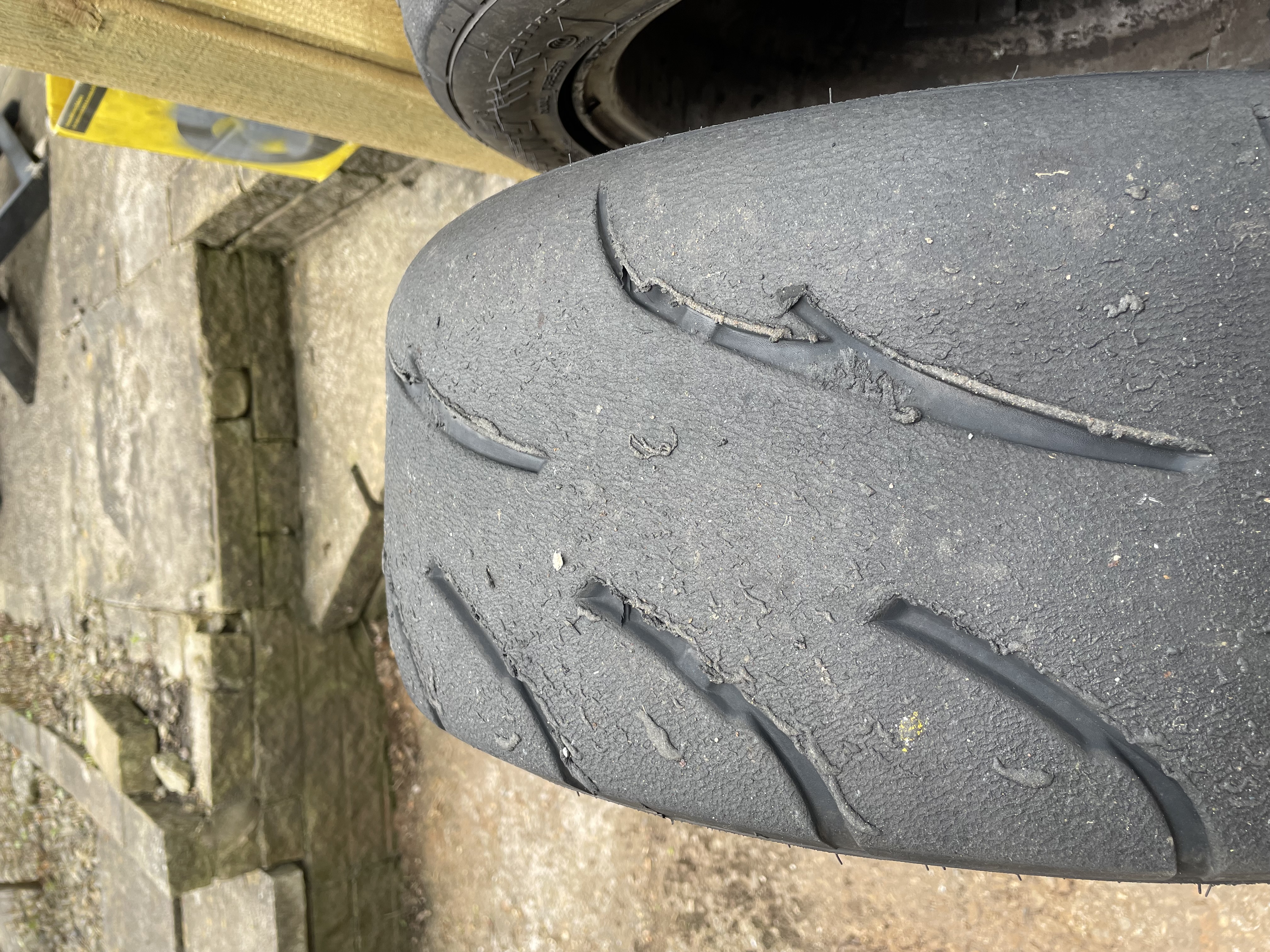

I’d also noticed I’d gone through a set of nearly new discs… in a 2 day sprint!!
(yes those are meant to be grooves)

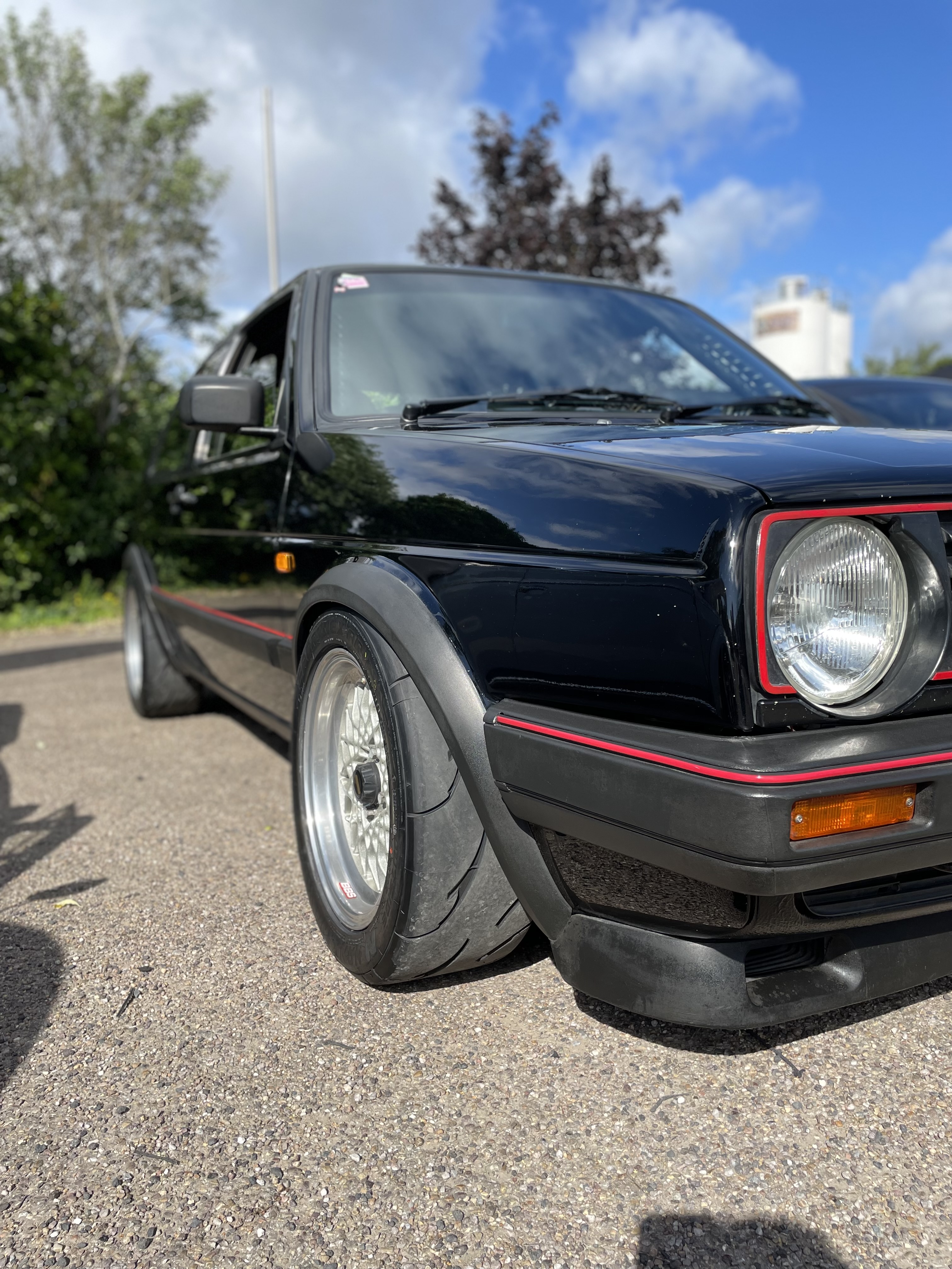

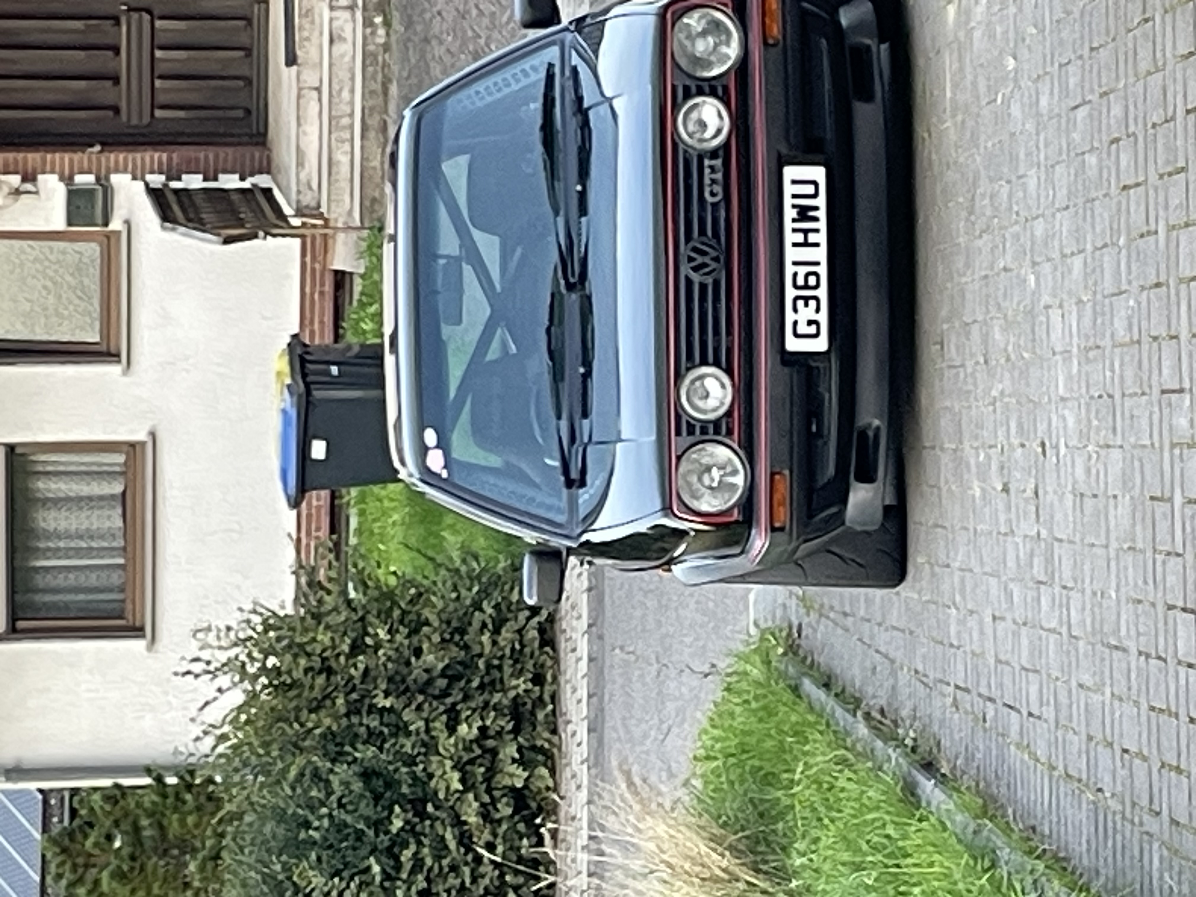

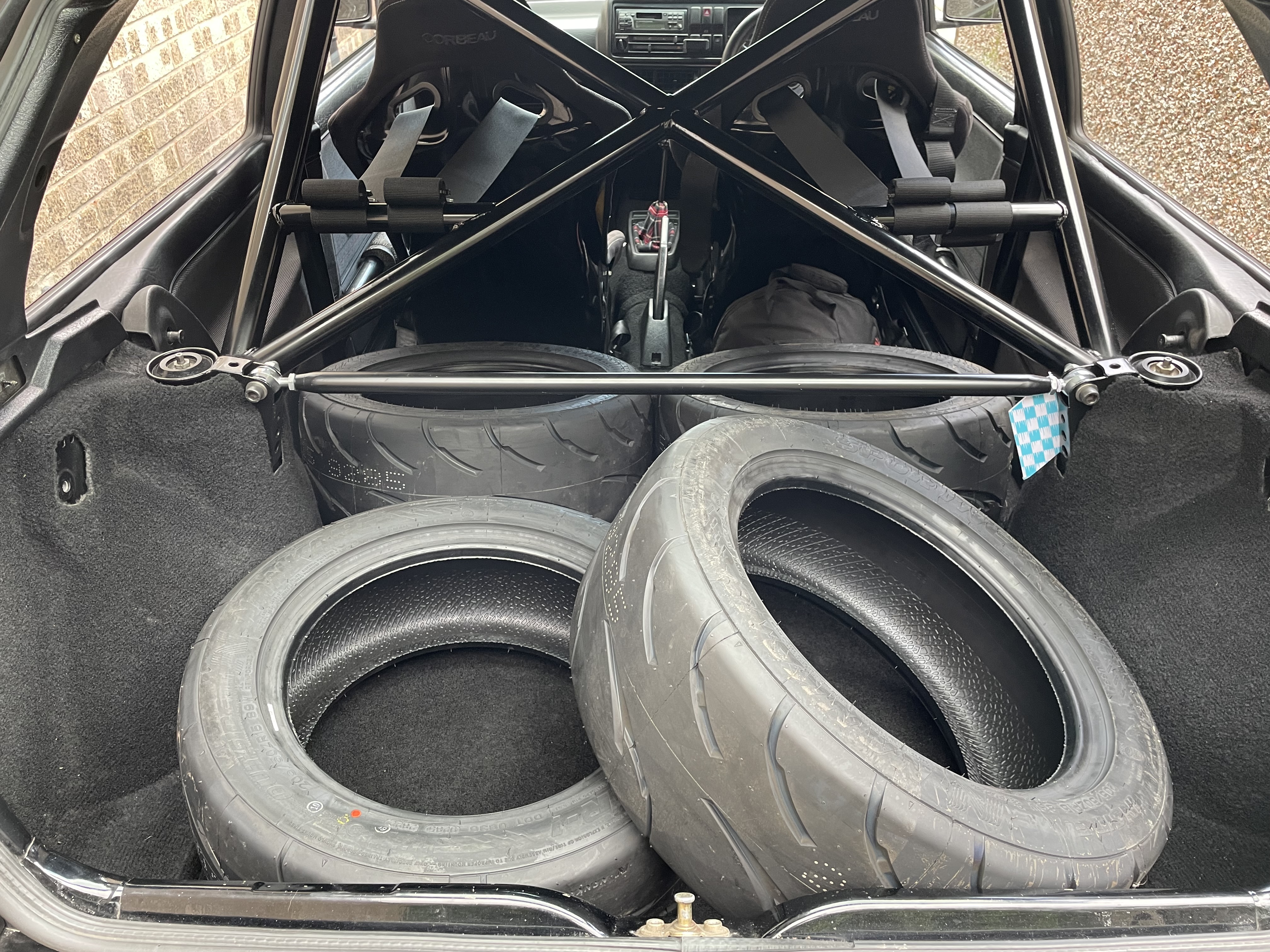

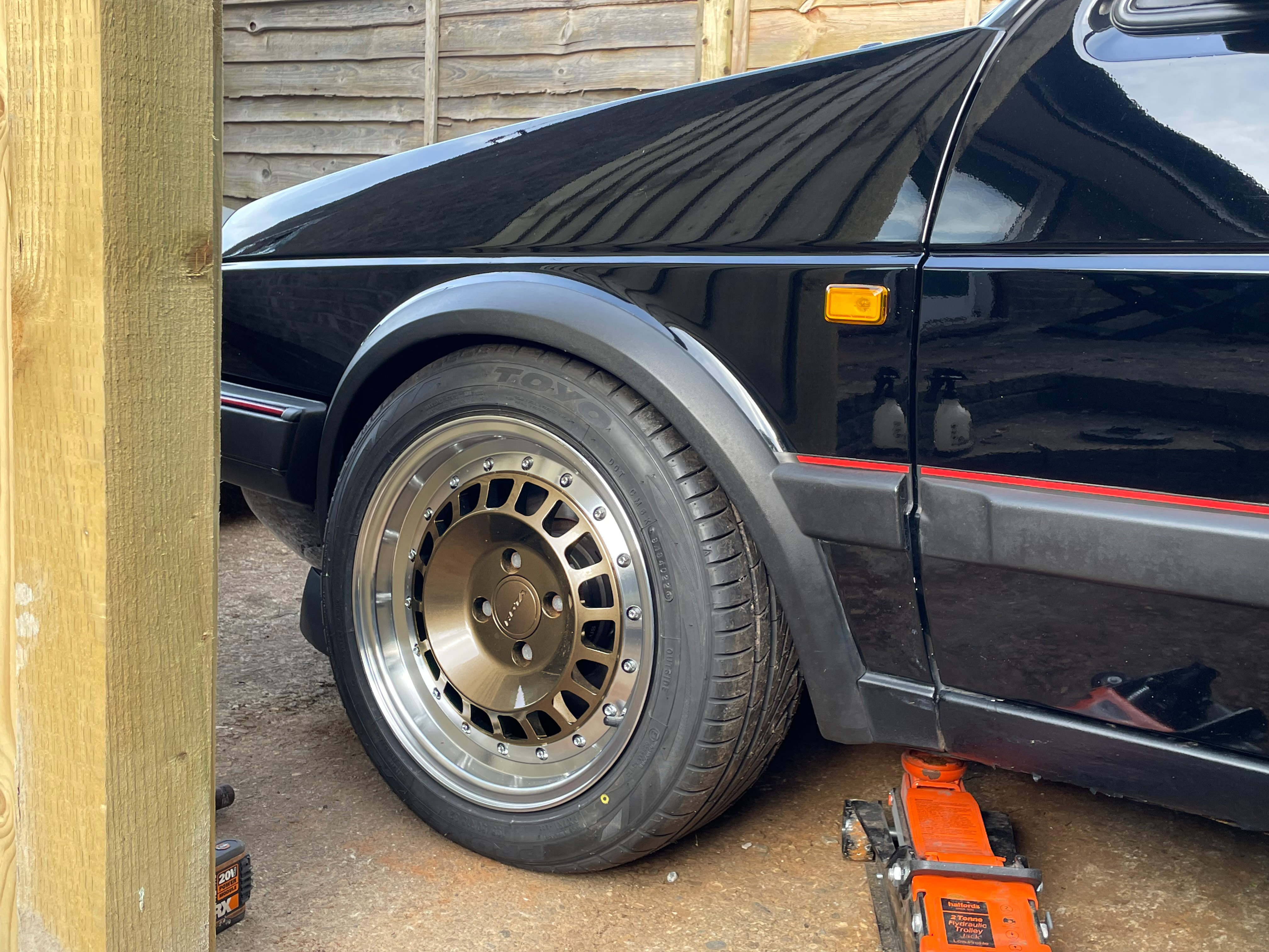

I also needed to sort some new tyres, the part worn NS2R’s were well past it, and provided little grip even in the dry. I’d been putting tyres off just because of the cost, in the last year or so like everything prices have gone through the roof.

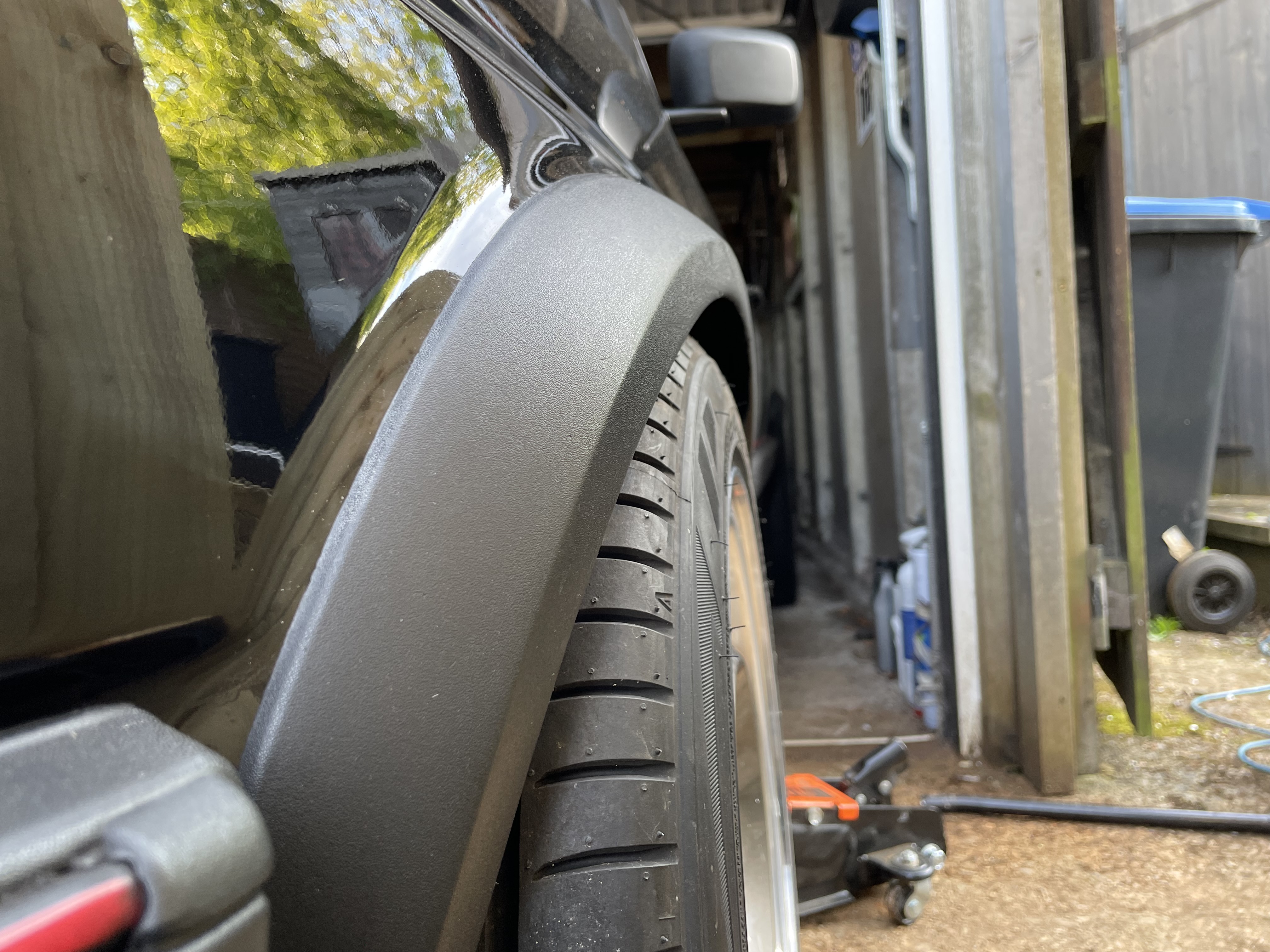

 I’d decided on a set of new Nankang AR1, but this time in a 205/50/15 instead of the usual 195/50/15. Sourced for £460.

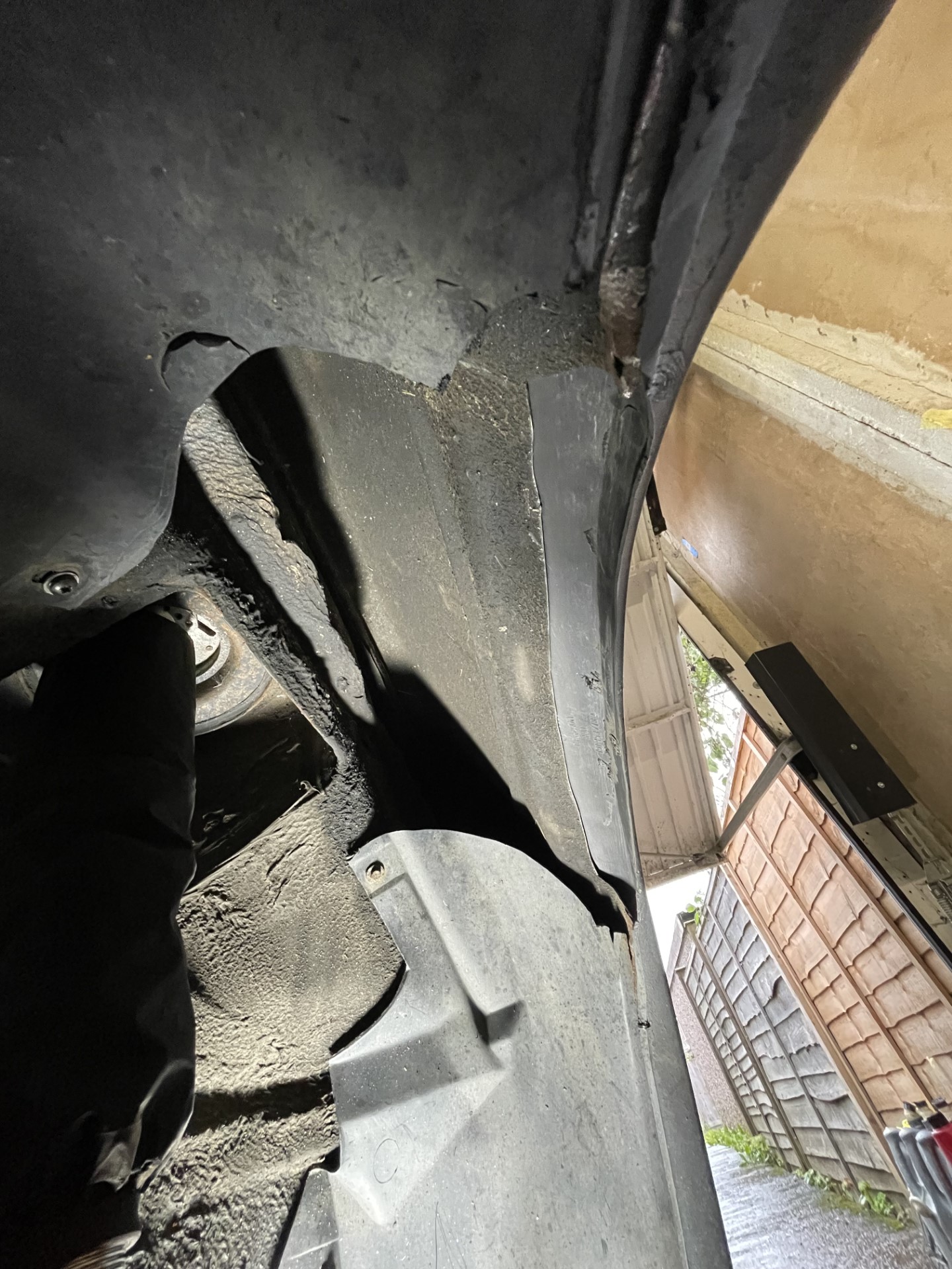

This was a big risk because the arch clearance with 195’s was already tight on the 15x7 et13 Mahles. So some jiggery pokery was needed. For me the golf has always been about function and form, so raising the car, or fitting generic arch extensions wasn’t an option. I’d decided to make as much room in the arches as physically possible, whilst keeping the standard OEM look.

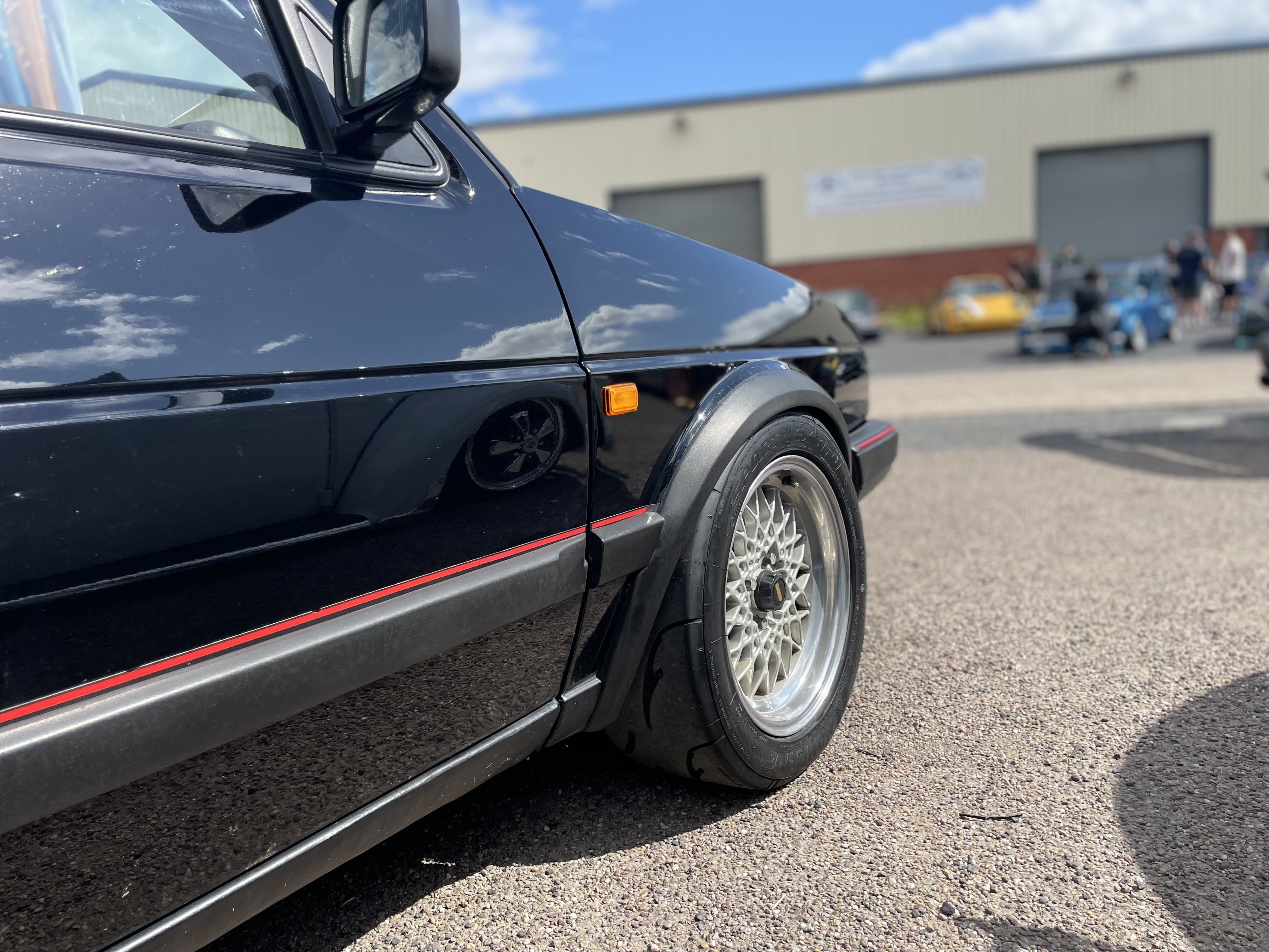

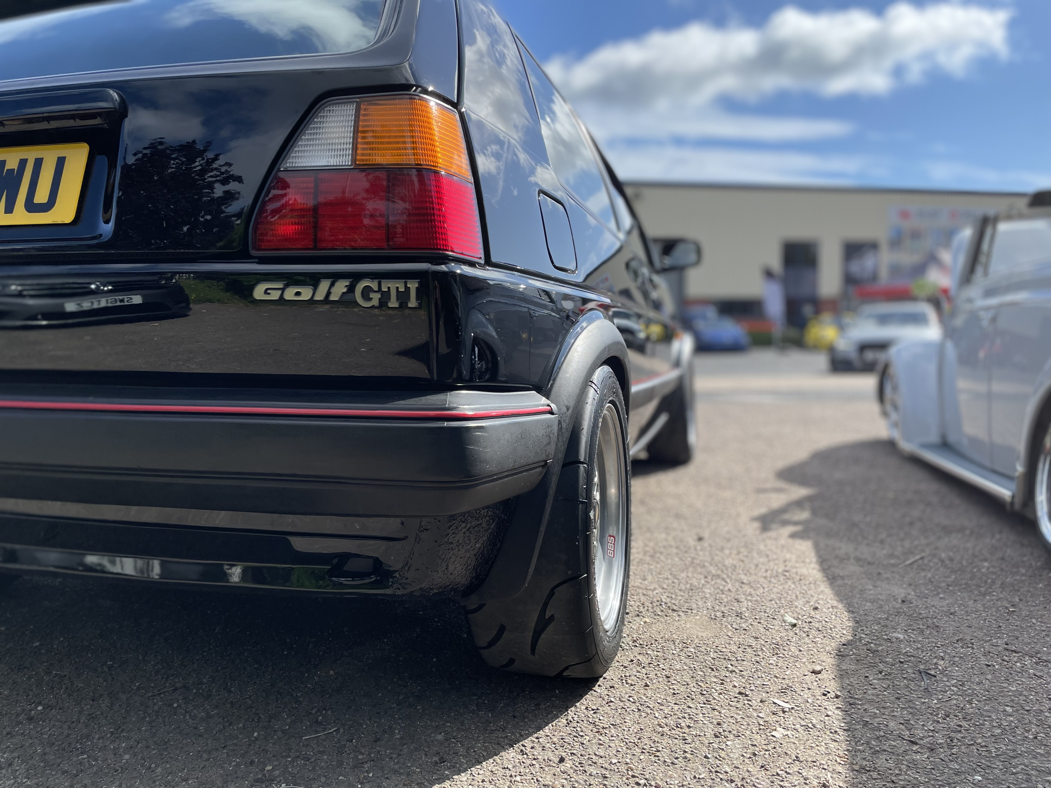

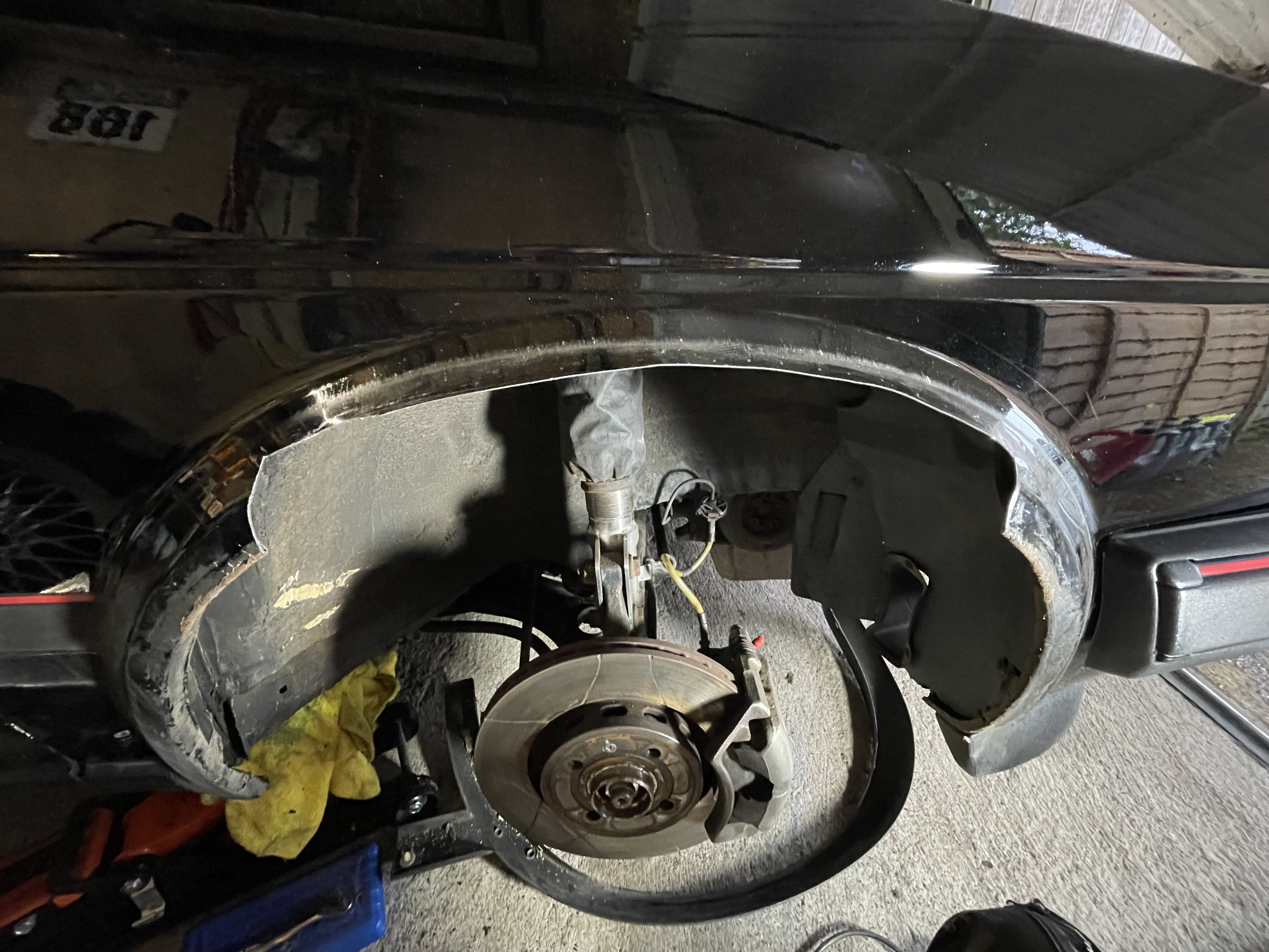

The front was easy enough, the wings were chopped out behind the arches. This is all well and good but then the arch fitting also needed removing, again arches can be stuck on with adhesive, but I’ve never been a fan of that, I’ve done enough rust repairs!
I remade all the mounting points lower down to secure the arches with flanged bolts and captive nuts.
It’s hard to photograph, but the plastic lip on the arch was sanded flat with finger sander to the face, so it retains its profile from the outside.
The same was done on the rear, the double skin welded back together, ground flat, seamsealed and painted.
It turned out really well!
Believe it or not, the car doesn’t not catch at all! Relief! And I love how the chunky tyre gives a really purposeful look.

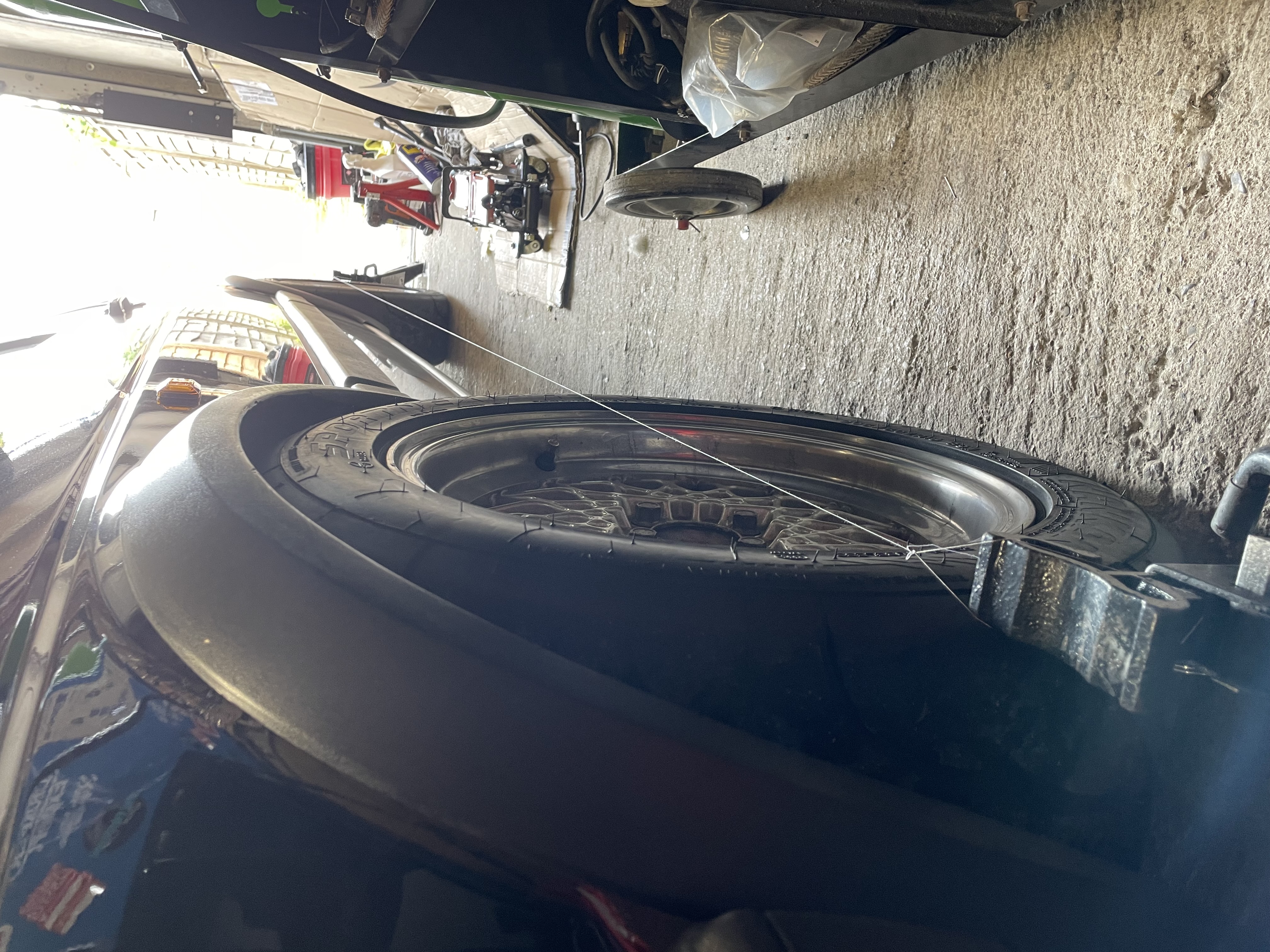

I also aligned the car, using a length of cotton across 2 axel stands, the tricky thing for me was room, as I don’t have the space to make a square box of string around the car, so I had to do one side at once. To make sure nothing moved (hard when you have to drive the car to turn it around!) I marked the steering wheel boss and the column, so I knew the steering wheel was exactly in line.
I set the geo as:
Camber: –3.0
Toe: 0.01mm Toe out

Love this, amazed how you can get the tyres so close to the arch but still retain 100% driveability.
Also, can you give me a bit more info on the string method with the axle stands on one side?
I've never been able to do it and always end up going to the local garage,
Re: Cope's GTI
Reply #82
Yeah I think something often over looked is caster angle, and that’s probably a big part of why I get the clearance. Im not sure on exactly measurements but if that factory castor angle is say +1 degree, i’d guess mine would be nearer +4 degrees. The benefit as im sure you already know is you get more dynamic negative camber, so the more steering input the more negative camber I get.
For the string method of alignment, its a real pain… a real pain but if you have time and patience it works. First loosen the track rod end lock nut. Then centre the steering wheel, once happy put a piece of masking tape on the steering wheel boss and one on the steering column, draw a straight line between them. This is a reference mark to get the wheel perfectly aligned each time, best to use a fineliner for this for accuracy.  Then set up a length of cotton (use cotton, anything thicker and you have less accuracy) between 2 axel stands, make sure the axel stands are positioned so they are longer than the car. Measure the gap between the centre of the hub to the cotton - a steel rule is perfect for this. It doesnt matter what this figure is as long as its perfectly the same front to back.
Next measure the front of the rim to the cotton and then the rear. You will see straight away if the wheel is toeing in or out, I found its easier to draw a diagram to visually see the difference. - now remove the string ( this bit is annoying) jack the car up adjust the track rod, lower the car down, roll the car forward and back, check your alignment marks on the steering wheel, then set the string back up and re measure, over and over until you are happy. Repeat on the other side.
I was sceptical if the marks on the steering wheel would be accurate, but from driving the car it really is, as long as you use a thin pen line, to make sure its perfect each time.
You can get a steering wheel clamp on ebay to prevent the wheel from moving but as I had to turn the car around to do the other side it was pointless
Hope that helps!

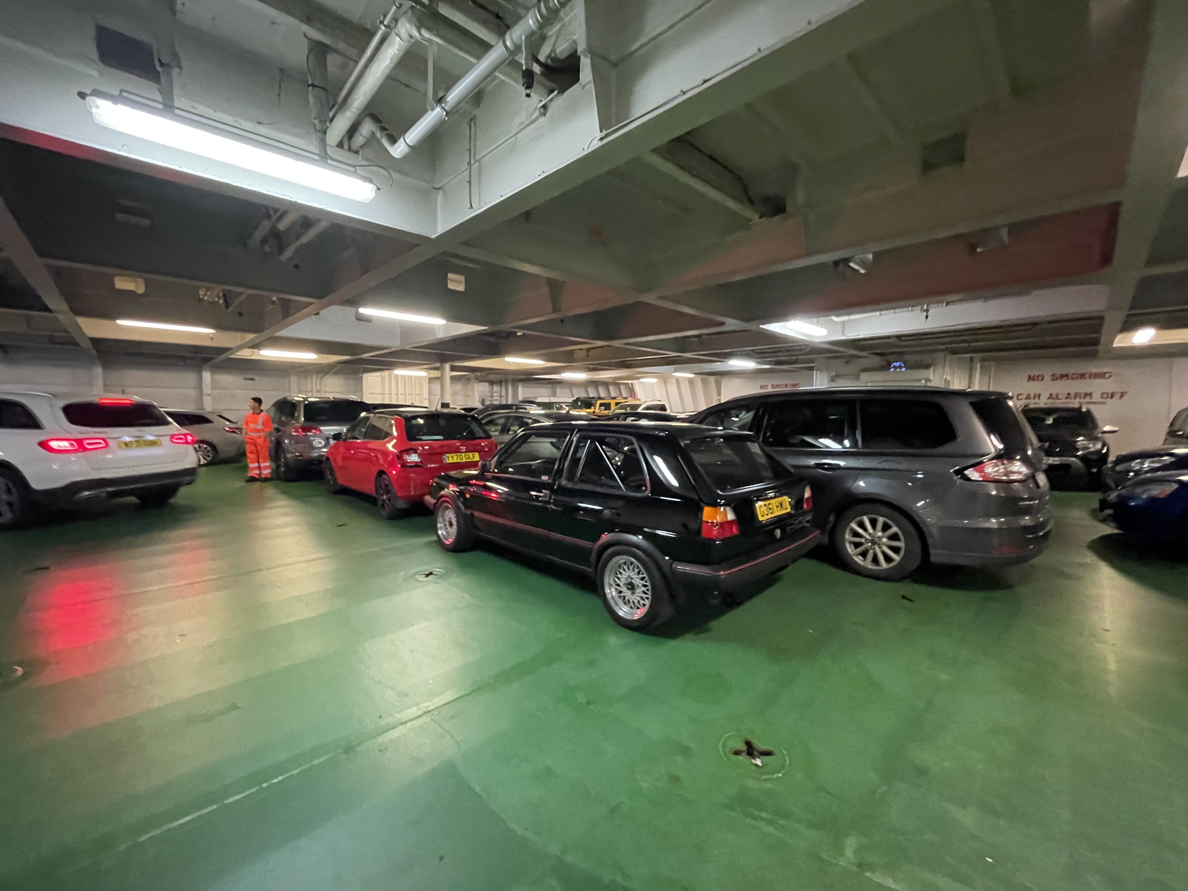

First success, I’d made it to the ferry :)
They really pack you in! Its always nerve racking when they park you so close and people have to squeeze past with luggage.

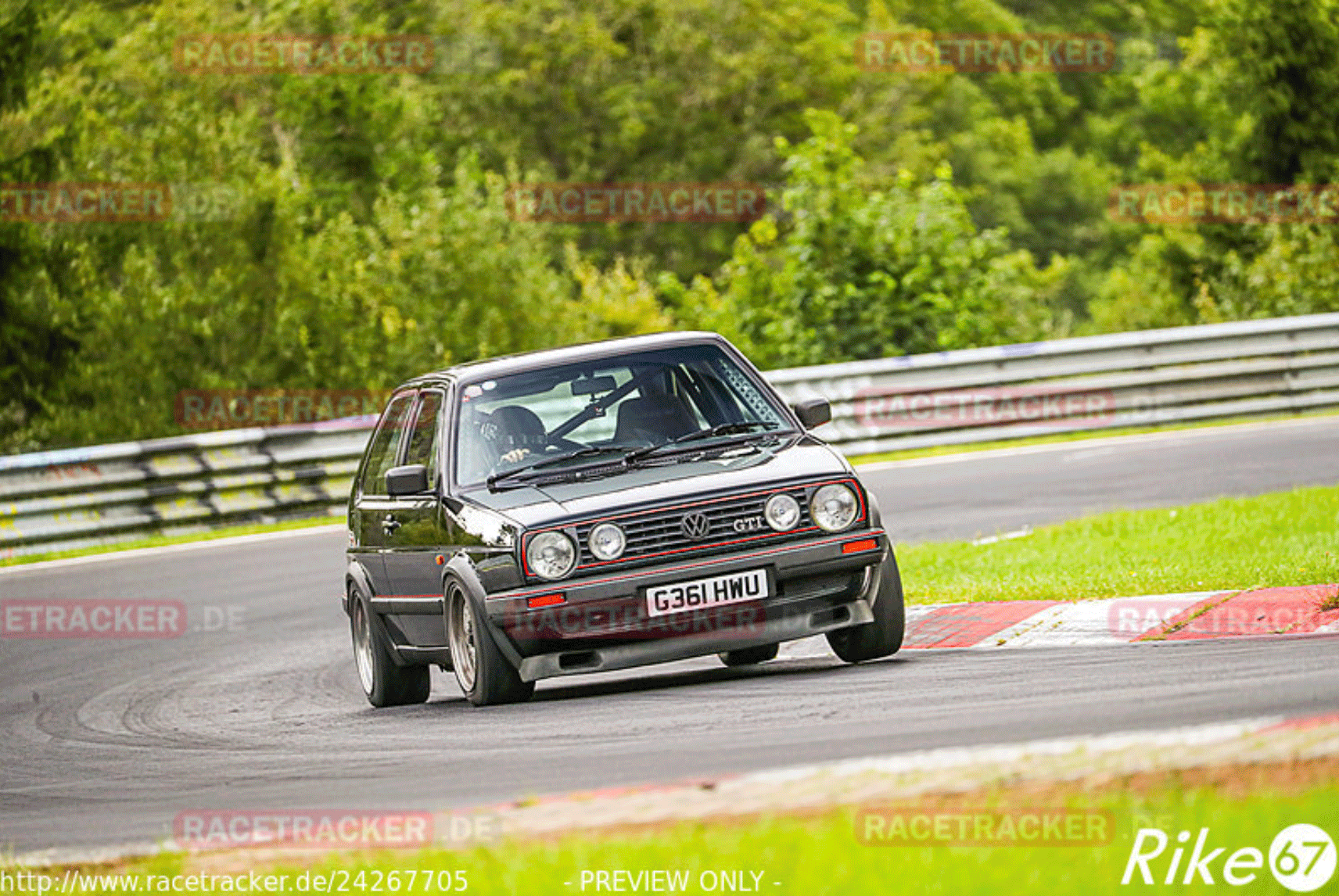

It didn’t disappoint! We had a couple of laps, sat behind loads of 911’s, GT2RS’ you name it! After lap 1 lap Nige engaged the “high boost” mode – hell fire, this was another level now. I still can’t get my head around how a brick shapped mk2 golf can be so savage ontrack. Fortunately I was also onboard for this…
https://www.youtube.com/watch?v=D9scBdsHIQs
The golf did its highest ever top speed down the Dottinger Hohe straight… 174.9mph. GPS.
Just have a moment to think about that for a minute… it’s pretty mind blowing!

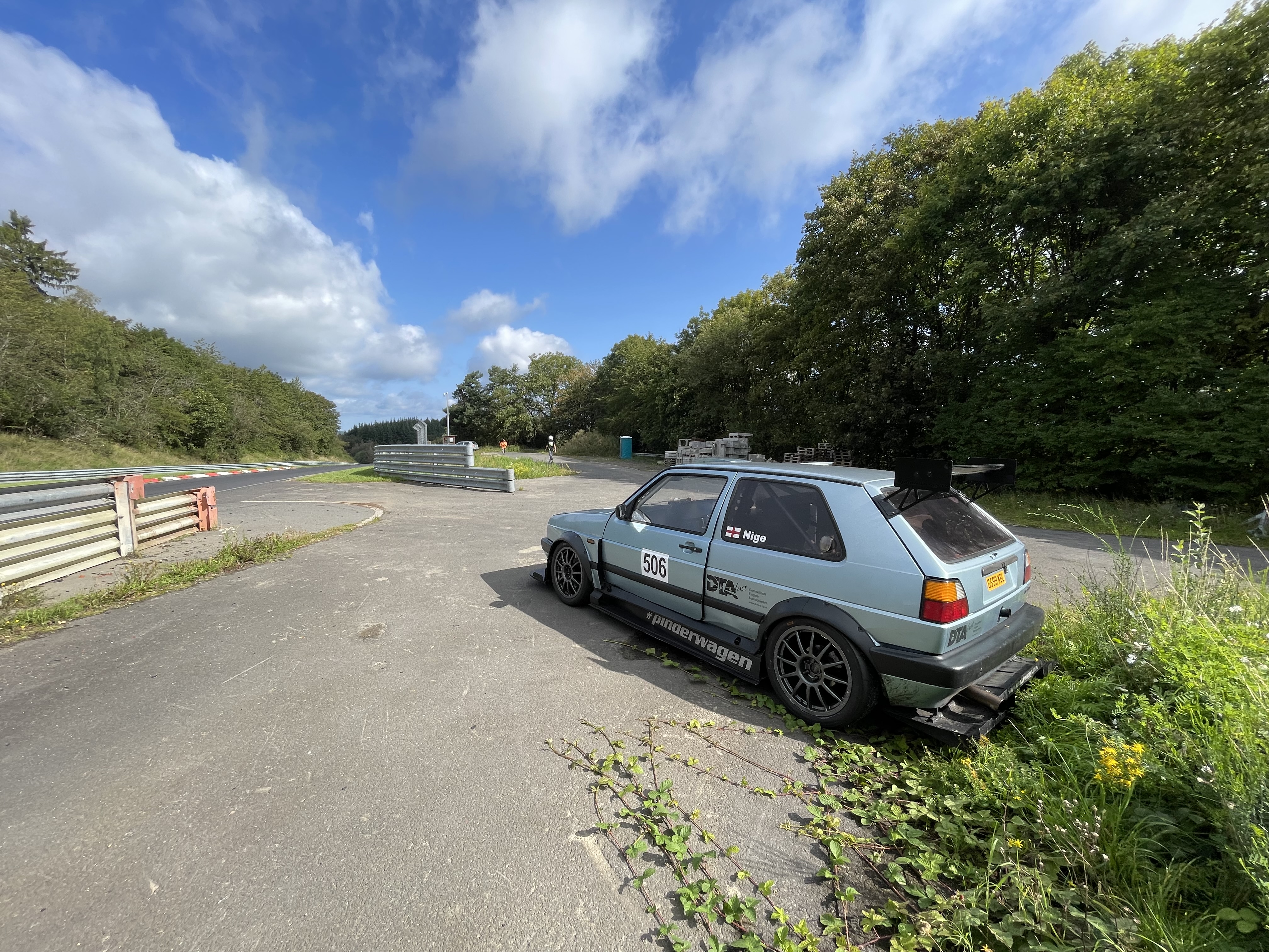

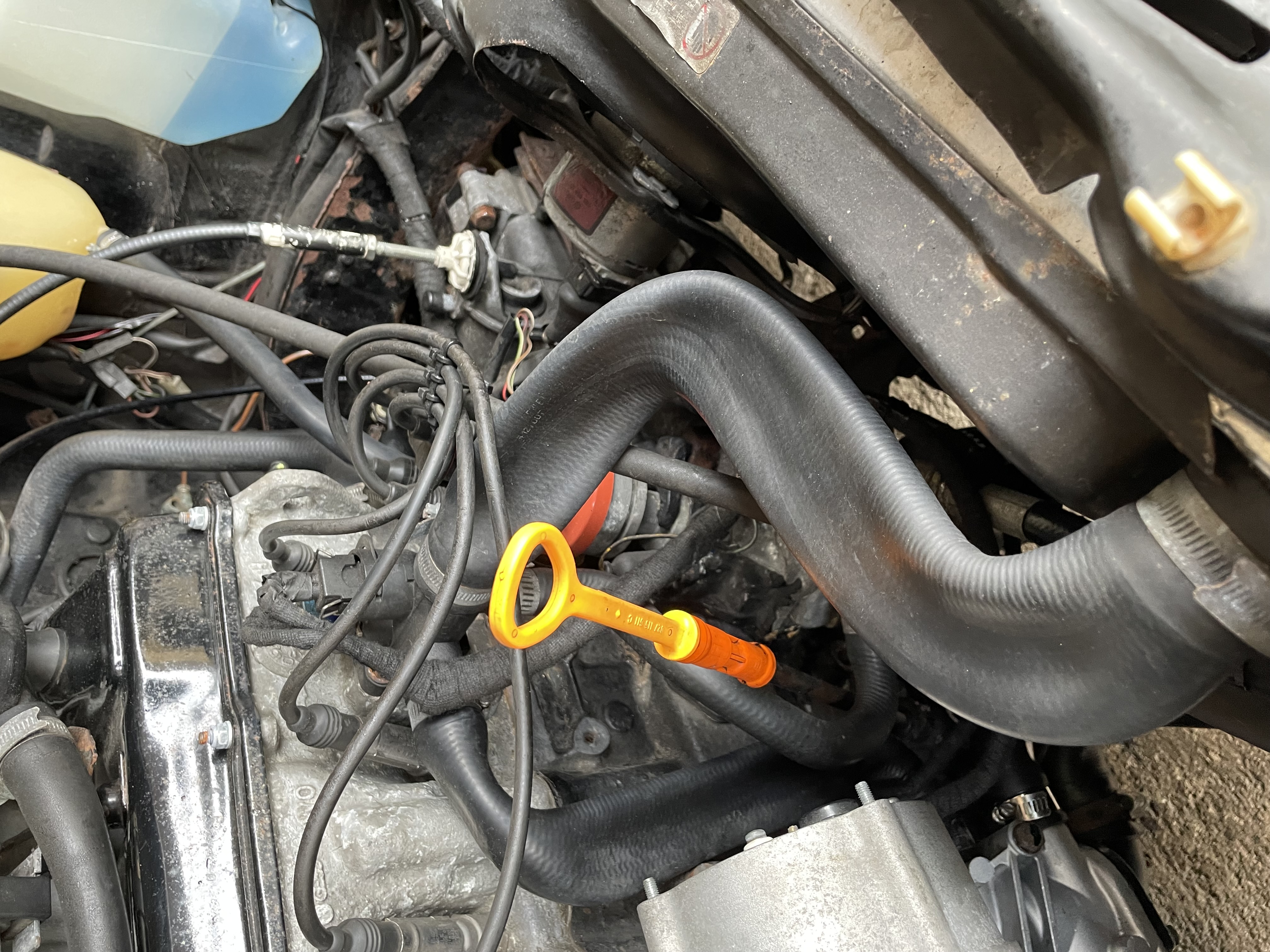

Unfortunately, it did go a little south at this point, as the car hit the compression in the track, it starved the bottom end of oil and spun a bearing. I wont say too much as Nige might want to publish an update at some point.
But we made it to the top of Flugplatz, and pulled off behind the barrier.
(concerned face!)
We then spent the rest of the day trying to sort it. Nige had the spares but all our conventional and unconventional attempts to fix it did work and the lack of oil pressure had damaged the crank, so there was not much we could do.

I went back to the house and checked the car over. Thankfully, no leaks, everything was tight, all good to go for the next day 

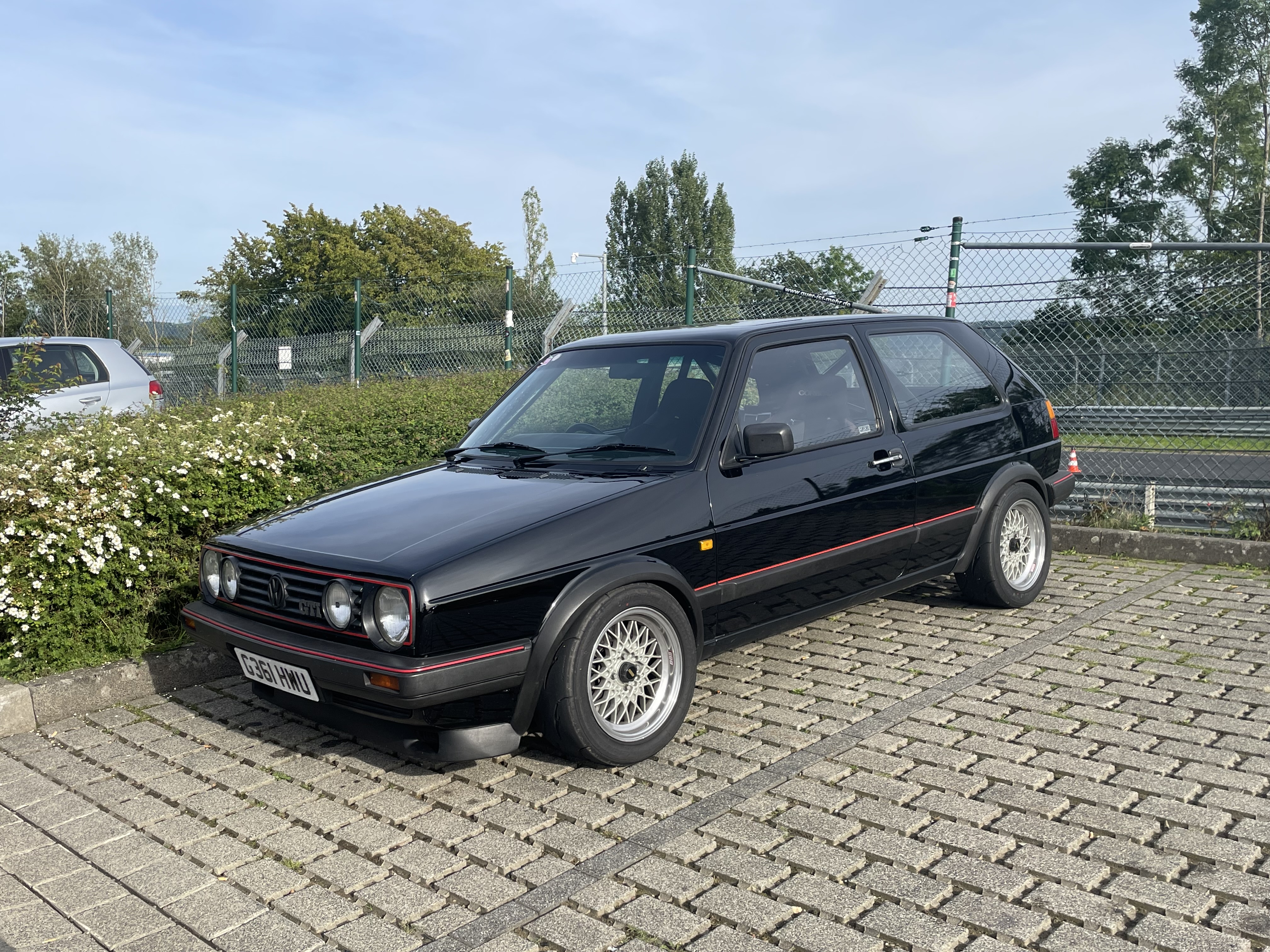

Hi chaps, its been a while. Not a huge amount of progress on the Golf, the daily E36 will be up for sale shortly, thats getting a mini restoration on the weekends, with some new rear arches and jacking points ready for sale.
I've bought an E61 535d as its replacement, its just shy of 400hp which makes it very unassuming for a big barge! So far I'm really enjoying it.
anyway...back to business.
The Golf passed it's MOT with flying colours again, having being parked up since I got back from Germany in the summer, I hadnt even washed it...

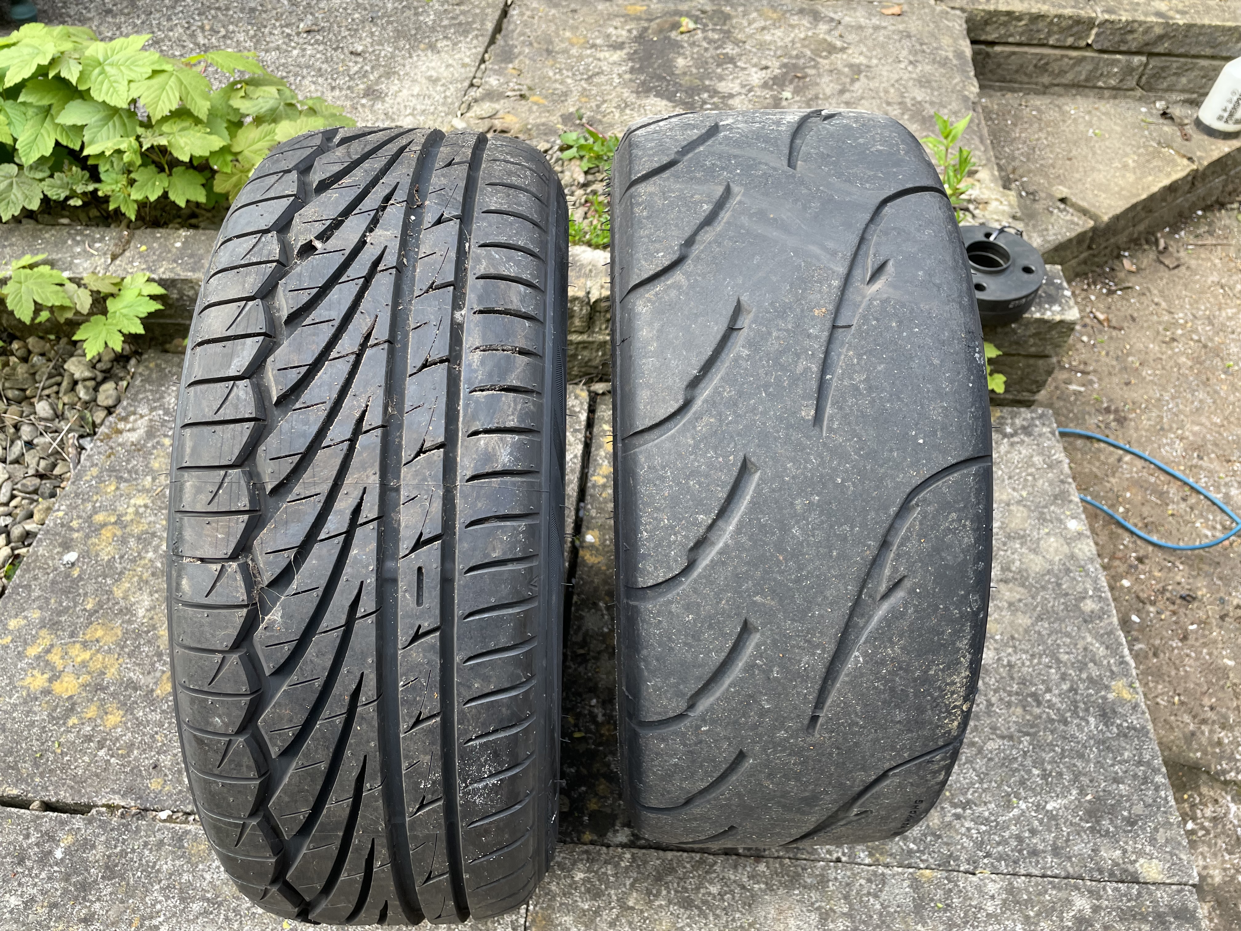

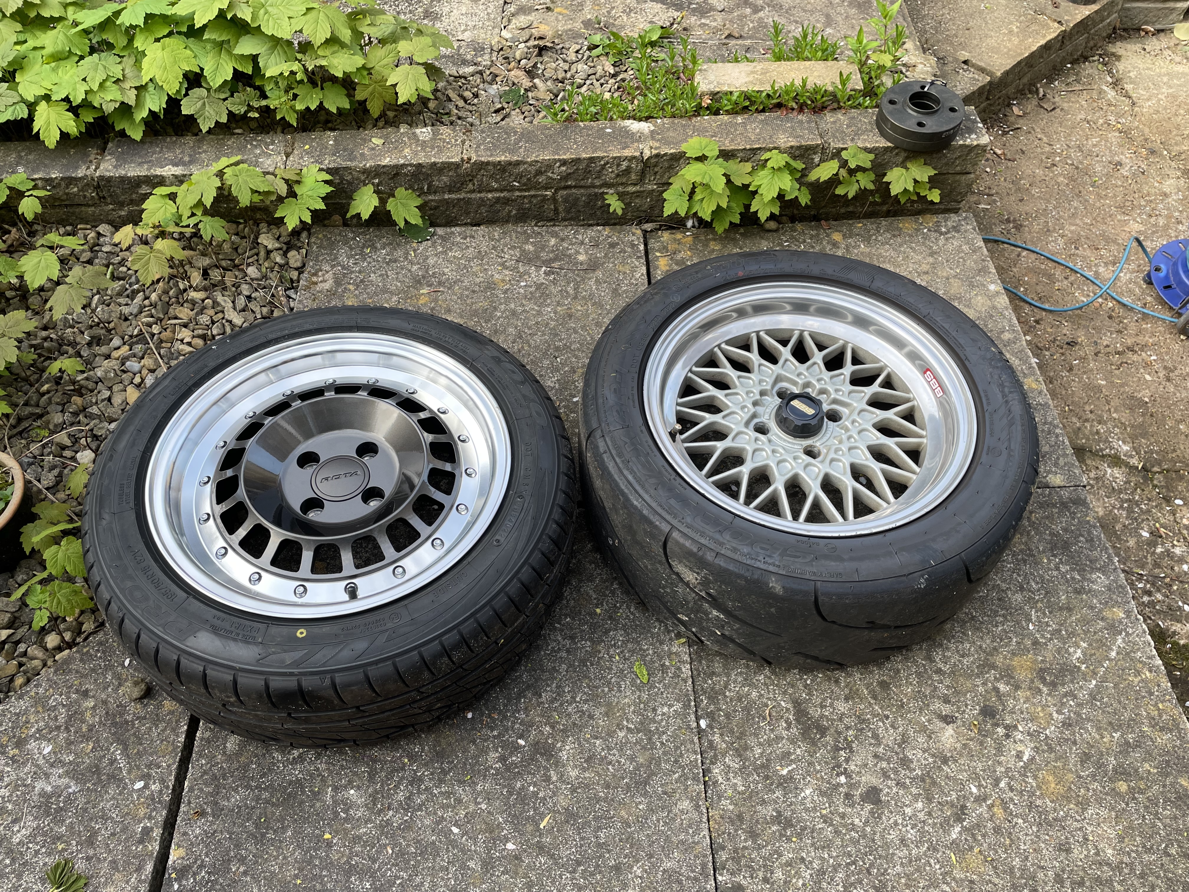

I've been eyeing up a second set of wheels for a while, so I'll have my AR1's for dry and run either a road tyre or a racing wet for any wet weather. At the moment with just having the AR1's if a trackday is wet i've pretty much wasted £2-300 as the track day would be a write off.
I almost pulled the plug on a set of E30 BBS wheels 15x7 et 24. But I've always had my eye on a set of Rota Speciale 15x7 et 20, but I'm too tight to fork out on a brand new set.
Luckily for me, a set popped up on marketplace, we struck a deal at £500 and they came with brand new Toyo T1R's... Now these tyres wouldn't have been my first choice as a wet tyre, but, they were on, brand new and balanced up and ready to go. They have a "B" rating in the wet, so although they wont be as good as a Michelin PS3 or a full wet tyre they will be miles better than the AR1's.
Its crazy how skinny road tyres are.

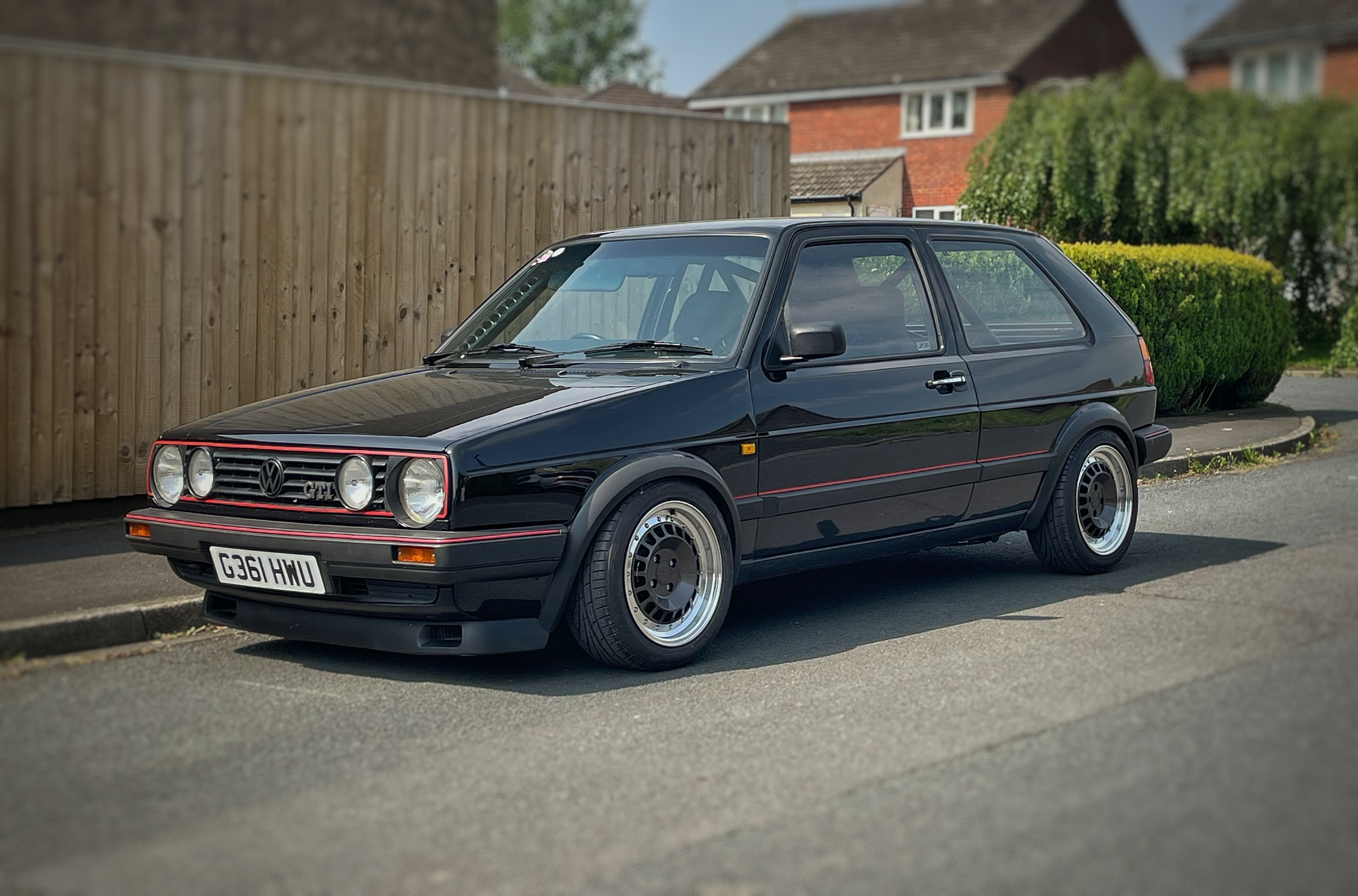

for reference heres the specs:
BBS - 15x7 et13 - 205/50/15
Rota. 15x7 et20 - 195/50/15
A quick test fit on the car and I wasnt happy with how the car sat at all, so I test fit a 20mm spacer and I much prefer how it sits -  and theres LOADS of clearance. that effectively makes the wheel 15x7 et0. Less than ideal with such a low offset but for me the car is all about function and form.
It also just goes to show just how chunky the semi slicks are! I've got a lot less room in the arch with them and they have 7mm less poke than the new Rotas.
The colour of the centre also isnt my first choice, in time I may paint them silver or gold. Quick photoshop below.
All in all very happy with the old skool motorsport look, exactly what I was after :)

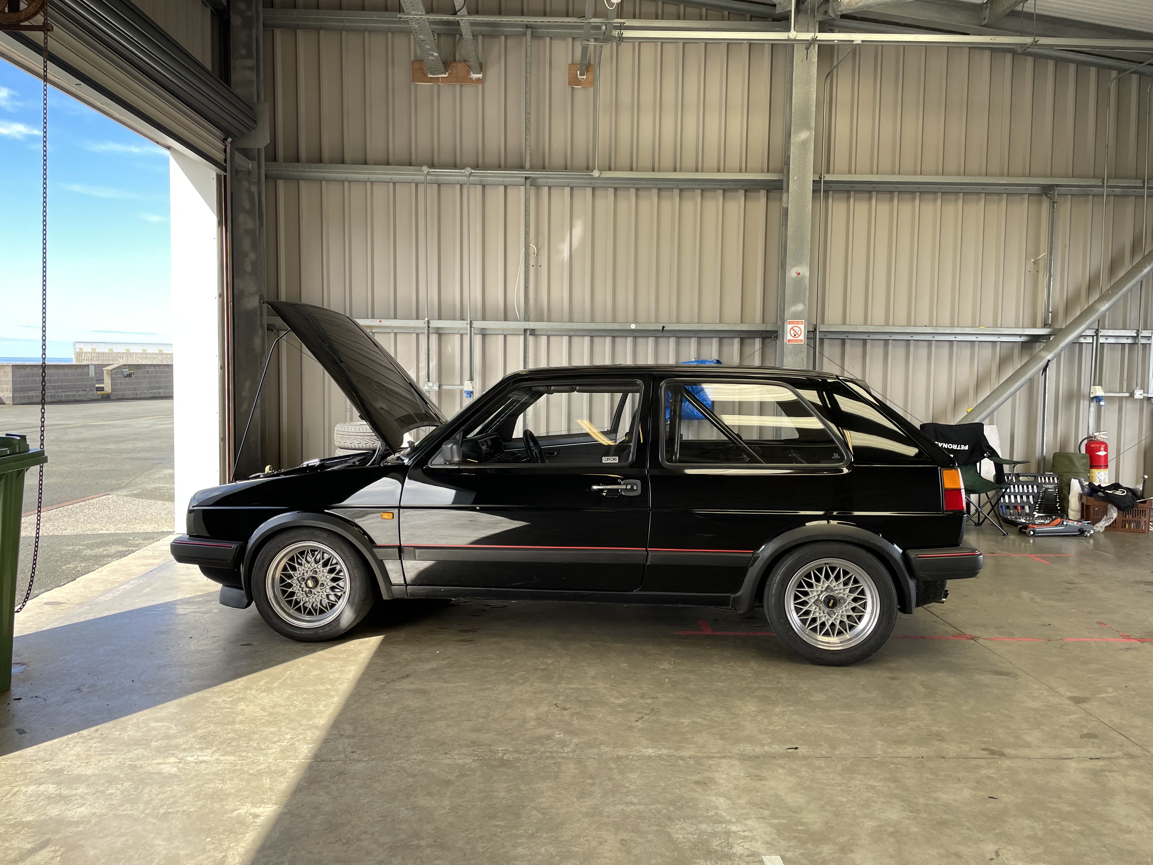

Anglesey 2024
Some prep before we went, I fitted a brand new SKF water pump and 87 degree thermostat.
As I had a strange noise on start up, the old waterpump was a cheapo topran one from many years ago so no harm in replacing it. After a test drive I wasn’t too happy, firstly the noise hadn’t gone and secondly the coolant temp was ¾ on the gauge just driving on the road.
The next day I stripped it all down and refitted my old 80degree thermostat. This made a huge difference! And coolant temps were normal, bang on ½ way even on track.
The noise you ask… well some more digging and I found it, it was the cambelt tensioner. The bolt had loosened despite being torqued to spec (45nm) luckily the engine wasn’t out of time. I replaced the nut with a nyloc nut, torqued and paint penned the end so I can see if it comes loose again. (post track day, all still good)

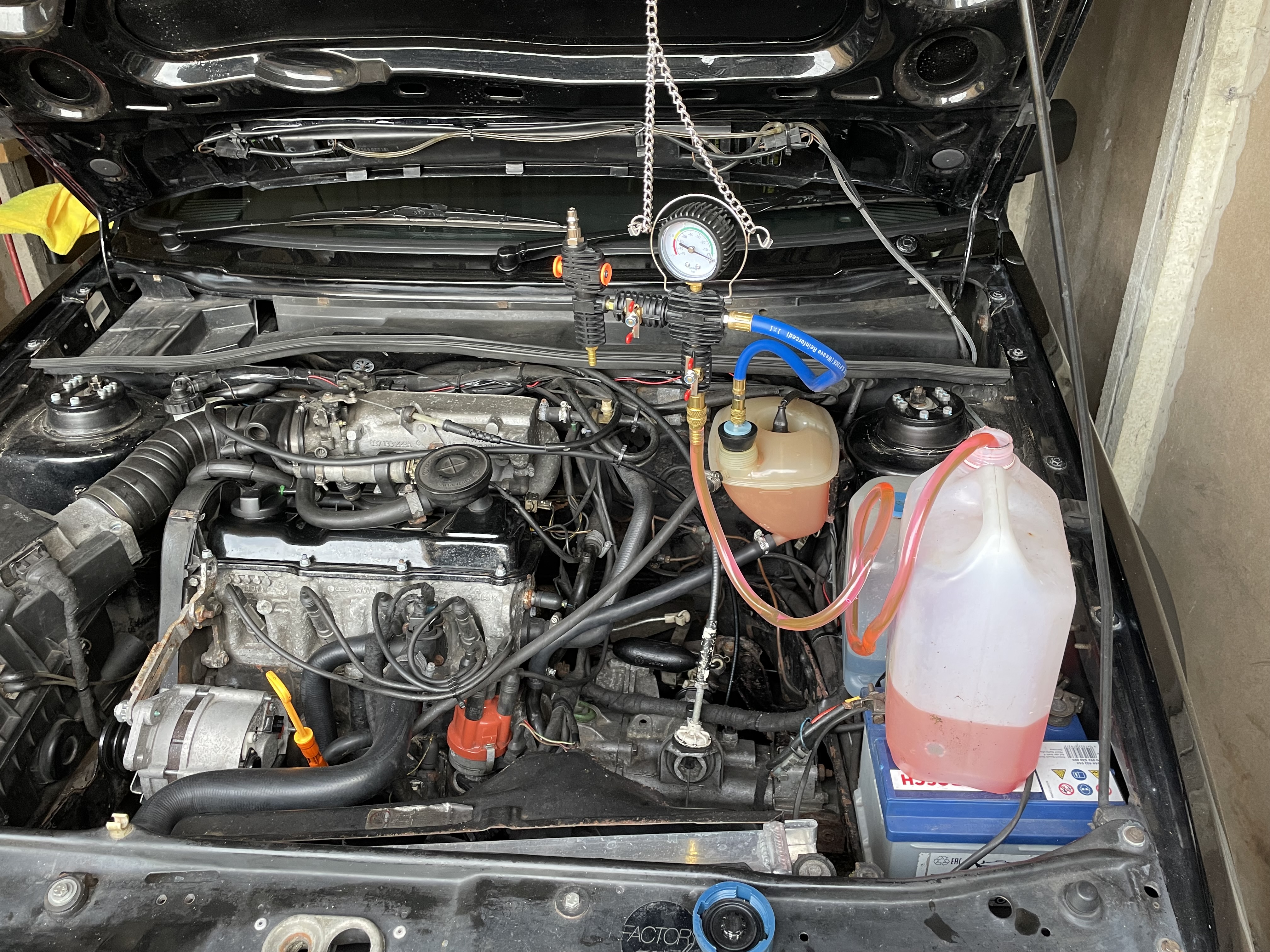

One tool I picked up cheap on amazon for about £20 was this vacuum coolant bleed kit.
It’s an impressive bit of kit and takes minutes to bleed the coolant, without the need to sit and rev the car etc. it works by creating a vacuum using an airline, you then crack a valve to replace the spent air with coolant – perfect!

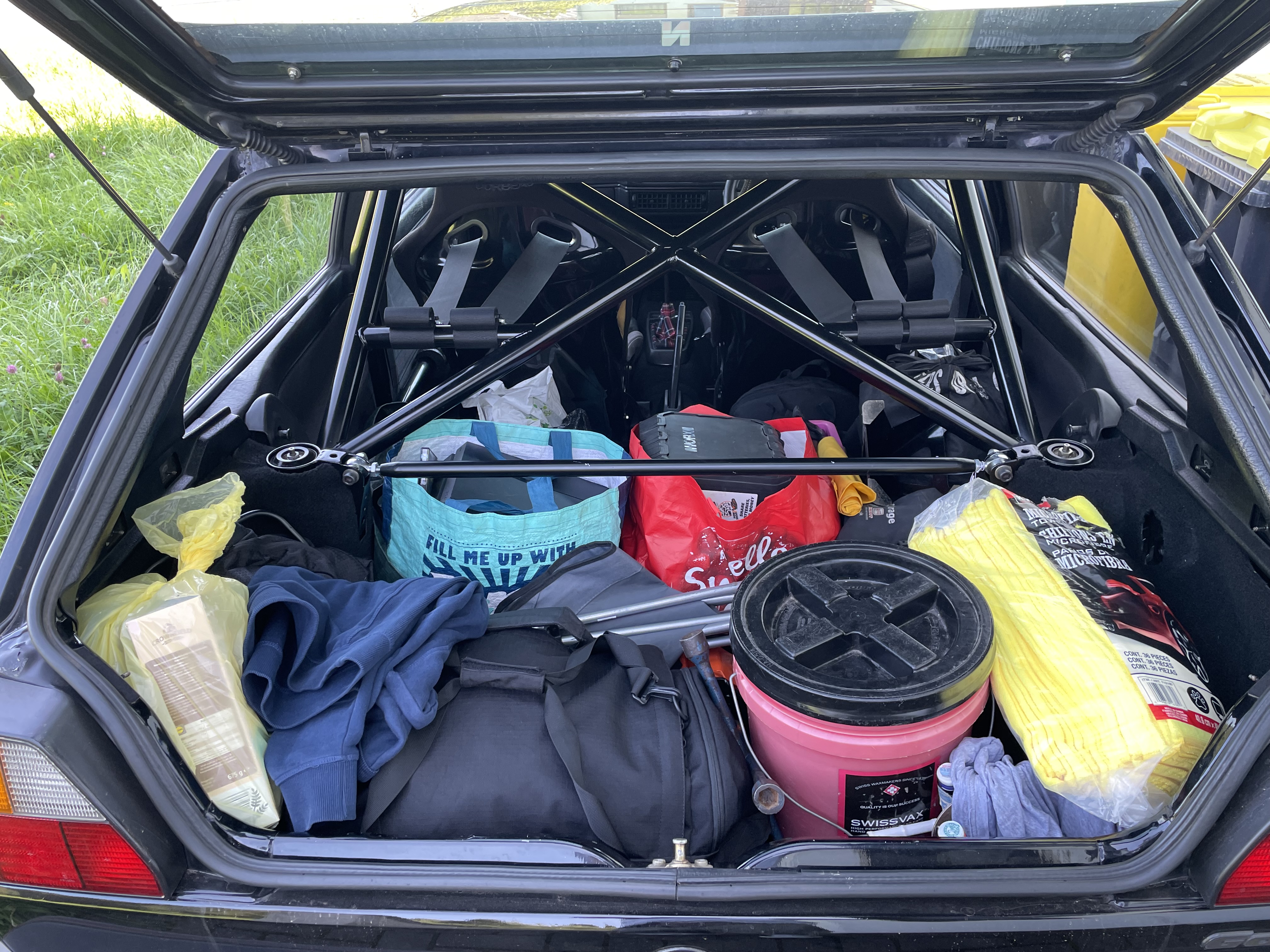

I drove over on the new wheels to save the AR1’s. I didn’t have the correct bolts for the 20mm spacers, so settled for 15mm. Although they did have the correct taper for the rear so I used some 8mm on the rear and 15mm on the front, looks okay, and should have some positive effects to handling in the wet with a wider front track.
I bought some new collapsable storage boxes to transport tools to and from trackdays. Makes loading the car nice and easy. We were properly loaded up for this trip, with the usual spare “gearbox…” tools spares, over night bags etc. Ford was in with me as passenger.
We still had out overnight bags to add here :D who needs a van!

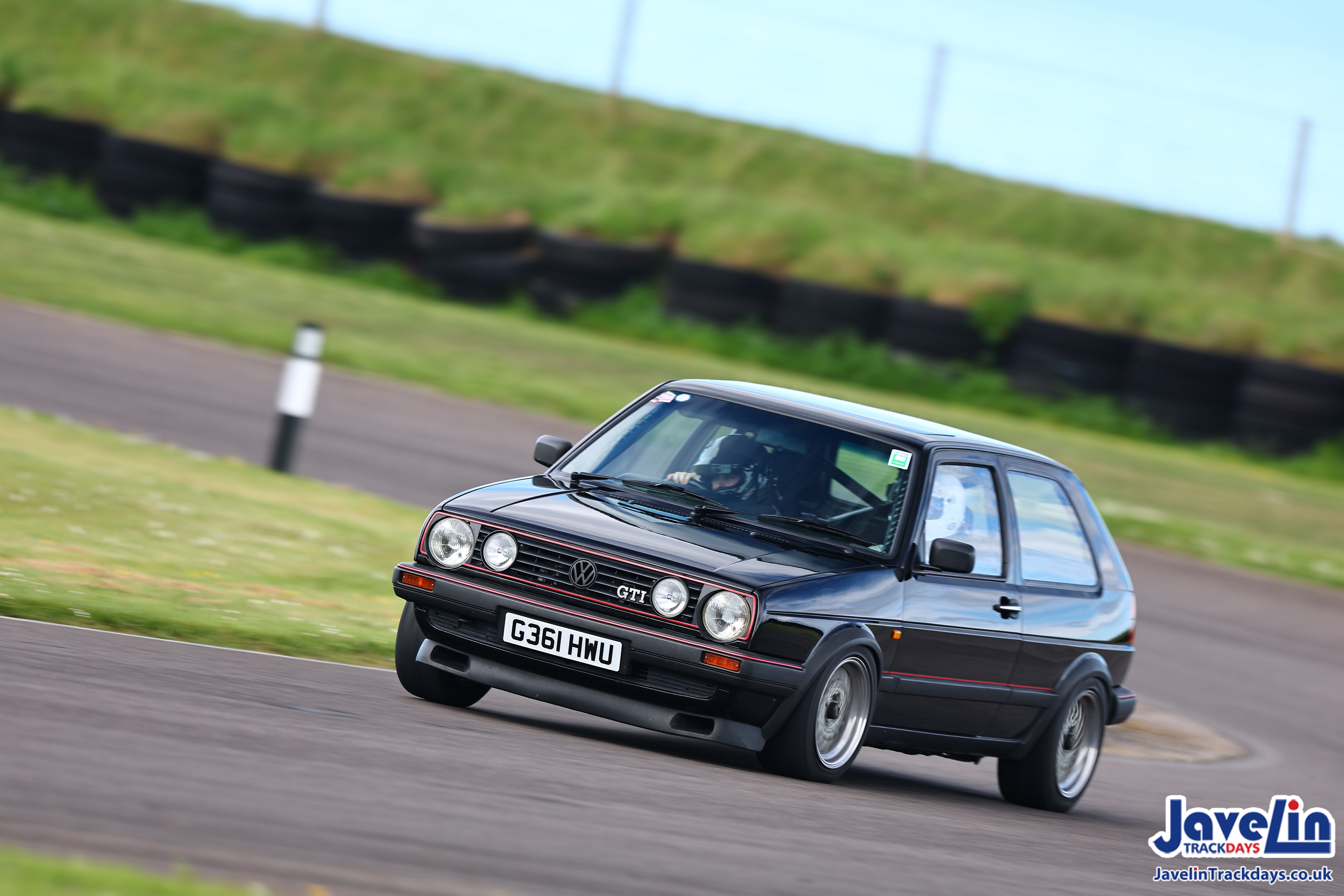

We had a 3.5 hour drive over with Nick in his K1 and Ford passenger with me. The Golf was doing well, comfortably doing 80 ish the whole way. We stayed overnight in an Airbnb and met up with Beardy (who use to own the white teg) had a good catch up and a walk in the hills ready for action the next day.
We were lucky with the weather and even got some sun!

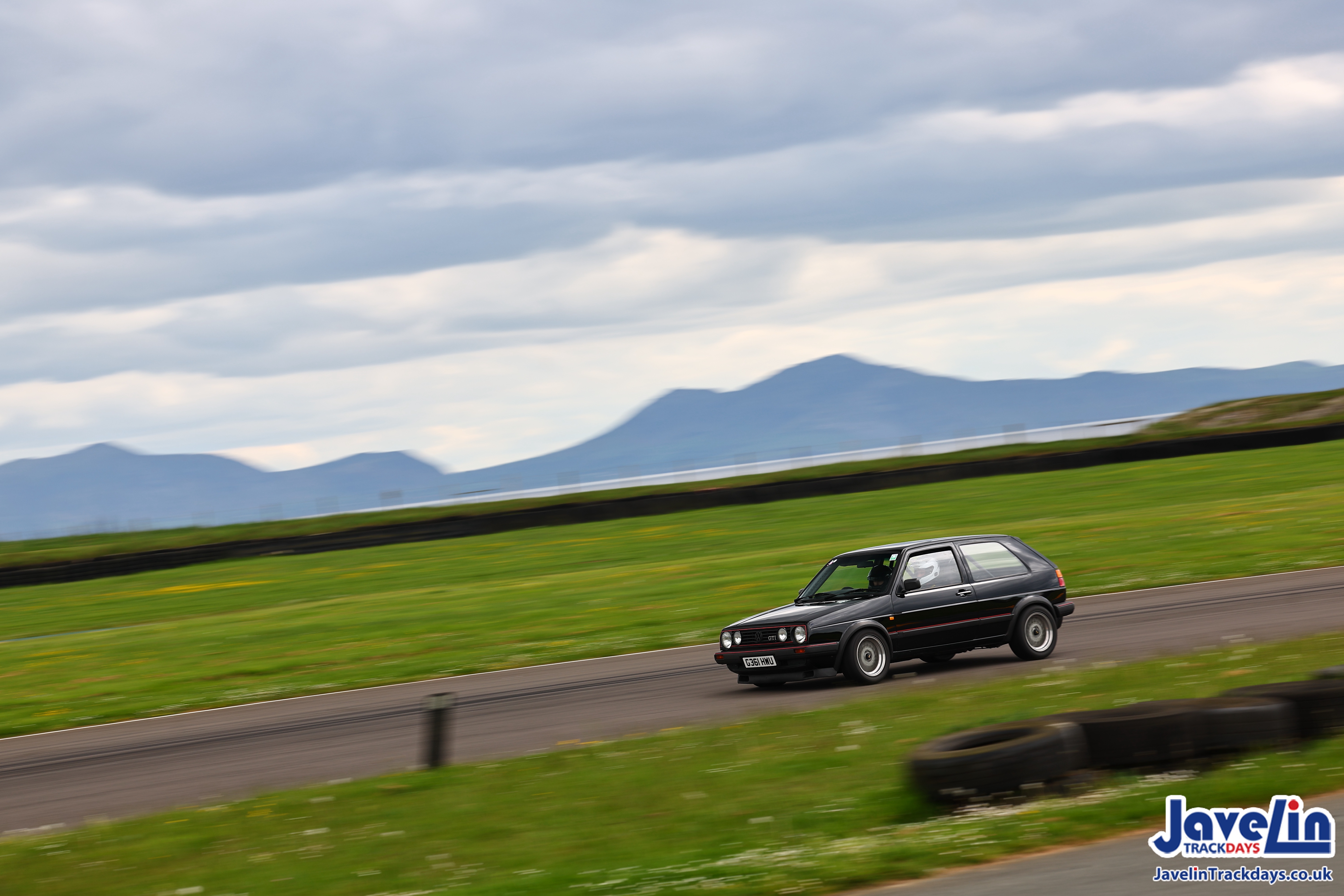

The Golf was going really well! It was the first time properly pushing the 205 section AR1’s, the level of grip was amazing.
I’m pretty pleased to report all went smoothly! No issues, no hiccups, just solid lapping all day long- which my brand new tyres thanked me for! I was having so much fun I’d forgotten how bad Anglesey is on front left tyres.
It looks to have been slightly over inflated too, I usually run 32psi hot pressure, but I’ll drop this next time and go back to 30.
Id taken Nick out and we came to the conclusion I could maybe do with some stiffer springs and maybe some antiroll bars, I’ve modified so much of the suspension and I’m now finding I’m running out of dampening adjustment on the coilovers, compensating for roll.
Having said that the car felt amazing once it was dialled in, I was catching 90% of the cars on the day in the braking zones and through the corners. You will see some of that in the video below 
Smiles all round.

That was a good catch with the tensioner, a couple of miles more could have spelled disaster!
I like the coolant vacuum thing, but how does it go about the thermostat?
Wouldn't that need to be open to get coolant everywhere?
